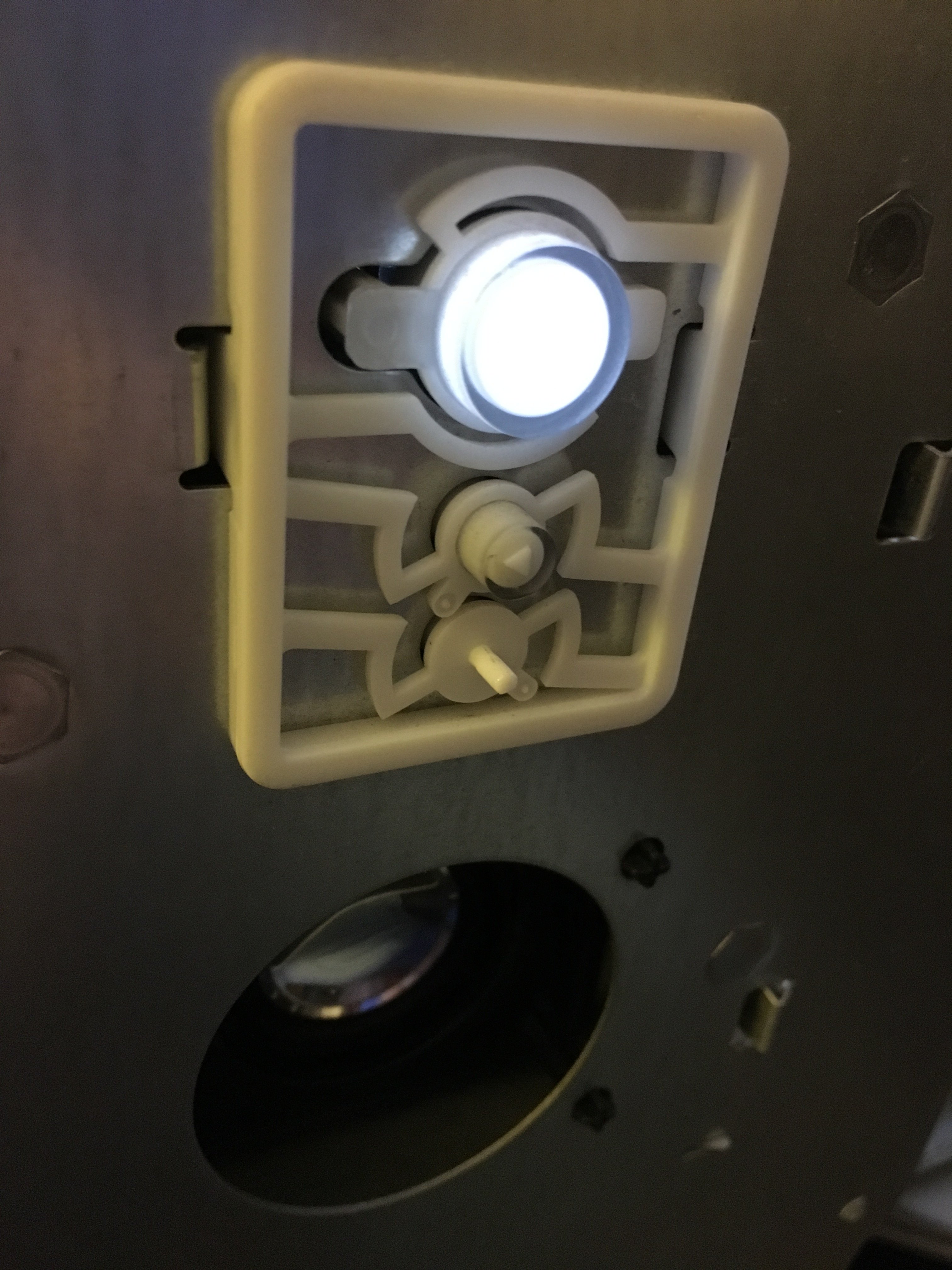

I'm stumped. All of the sudden, this powermac started to boot up with a long beep, then quick flashing power button (10-20 fast successive flashes like a strobe almost) - then the normal bong sound and then straight into open firmware. I can boot into OSX at that point (boot-mac) and the box runs just fine. Things Ive tried so far.
- reseated PCI, AGP cards, RAM and processor.
- messed around with ram sticks - using just one in multiple slots. Also looked at them in OFW and the box sees them all.
- checked the HDD. using fsck
- replaced the dead PRAM battery.
- Reset PRAM.
I have not been able to really find much online - just some vague references to the beep and flashing light referring to bad ram sticks. I noticed one of them has a different listed speed from the other two. What do you guys think? I mean the box runs fine after booting into OSX from OFW. That's annoying as heck though and I can;t find anything/components wrong with the machine itself. Thanks for the help.

Remove everything external aside from the monitor (what monitor are you using? If it is ADC, there might be something going on with the monitor) and boot it.
Thanks for the reply. It is an apple Cinema display and I have it plugged into the ADC port but have others I can test through the vga port etc - I will proceed. Thanks!
update: Just disconnected all peripherals, removed the USB2 card, airport card, switched to VGA/different monitor and still the same thing. This is really weird. Perhaps I should just reinstall 10.4.11? Hate to do that but really, not much needs to be done to the box and I have the software I like on a thumb drive.
I wonder if the logic board is breaking? I have never seen a mac (owned a few intel & g3 PPCs) boot into open firmware before on its own, so I assume it's seeing some sort of problem. Who knows as I do not understand the beep/flashing lights meaning.
Then again it works absolutely fine booting into OSX from the OFW prompt. Oh well, it's Friday and Im having some beers. Thanks for the help!

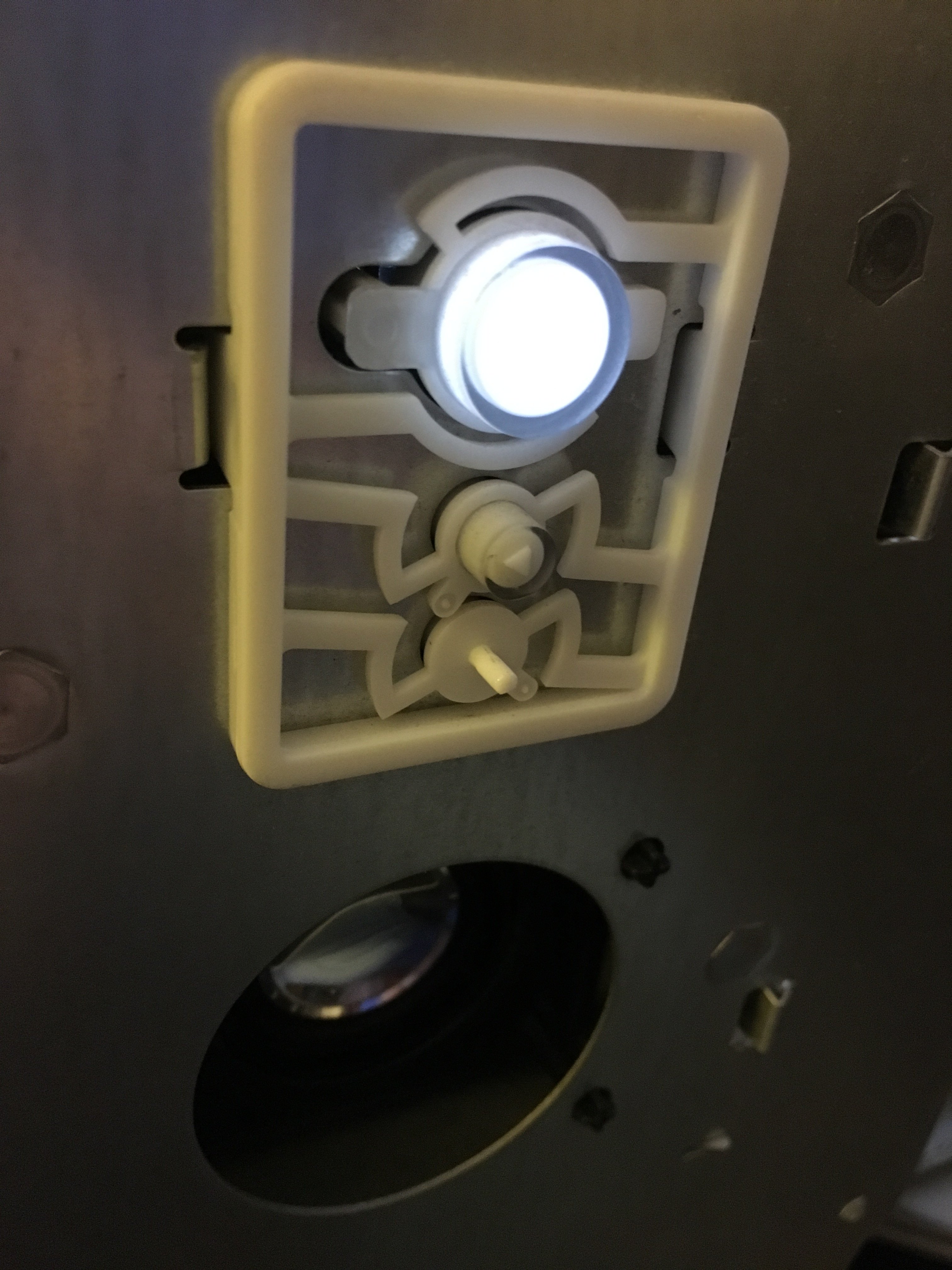

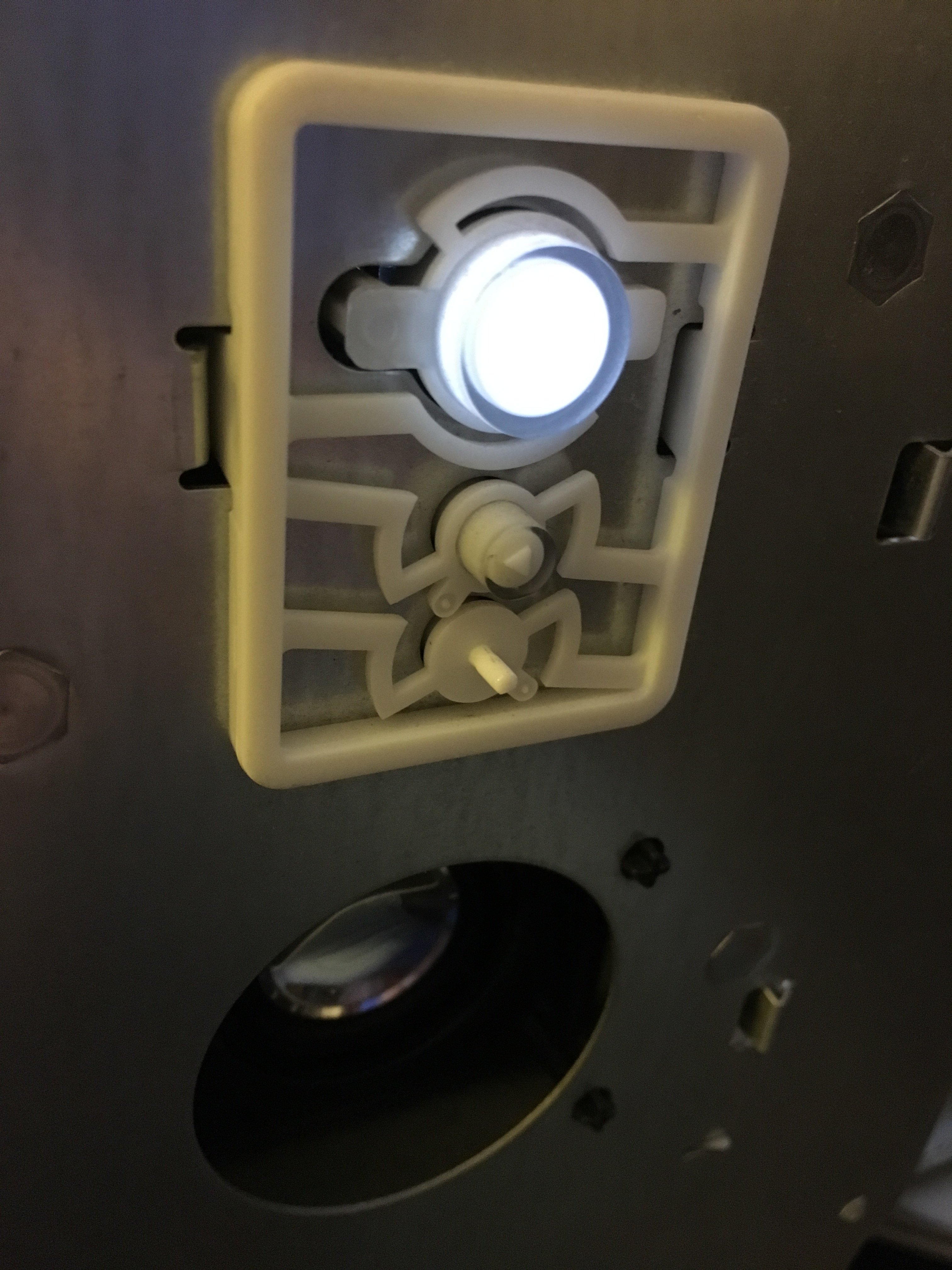

Lol so I figured it out. When I reassembled the case from giving it a good deep clean (truly needed it) I pinched that little, what I assume to be, an OFW switch nubbin thing between the case frame and front plate.
Truly one of those Derrrr moments which I tend to be prone to when I rush. Anyhow, everything is back to normal. On a side note, I installed a fan on the processor heat sink and one on the AGP card that I salvaged off of a hard drive cooler for a little added air circulation. I also have 1.5gb of ram and a dual processor heatsink on the way.

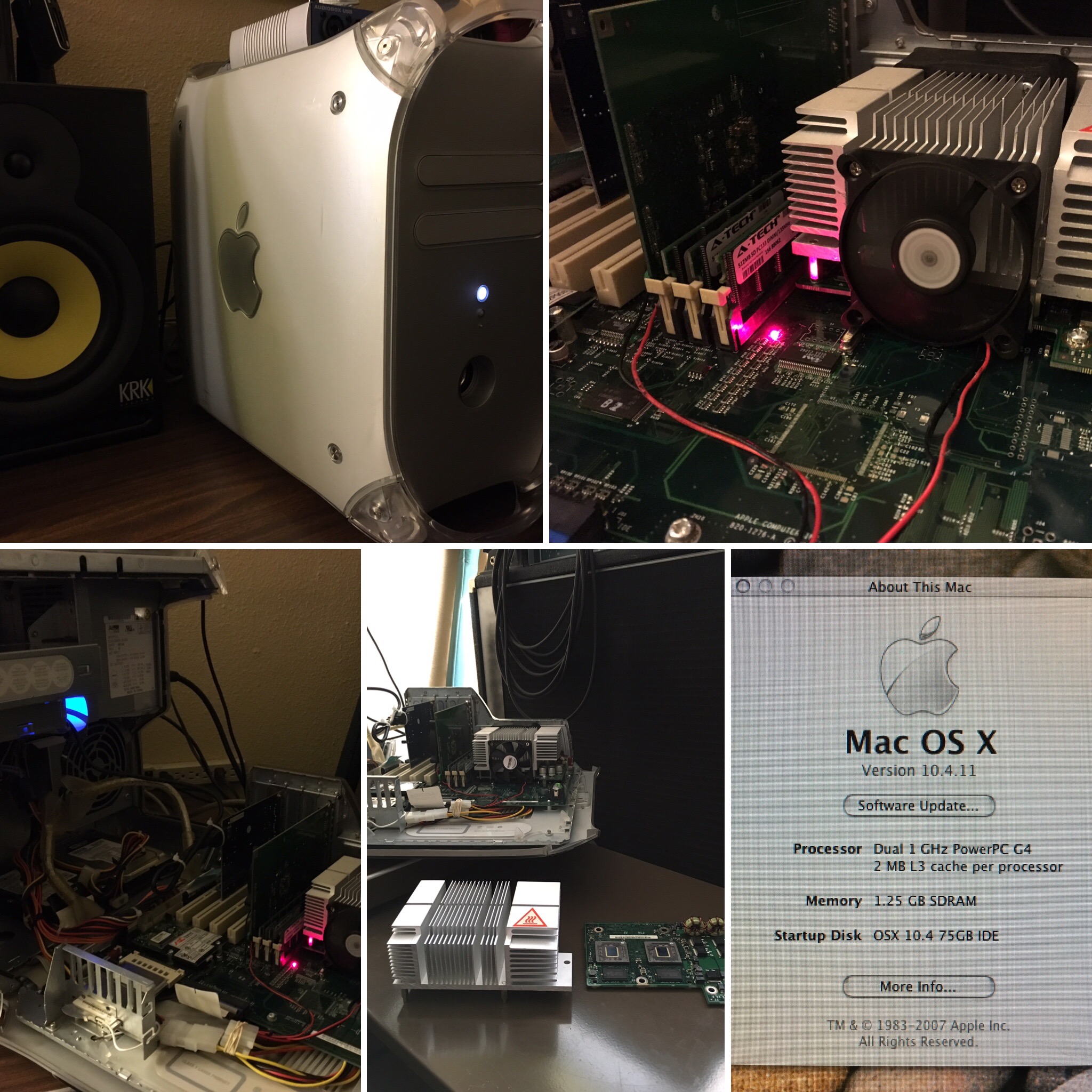

Got the ram in but one of the sticks is dead, so instead of 1.5gb, I've got 1.25gb until my replacement stick comes in. Heat sink comes in Monday.
Edit: the ram seller was super cool & is sending a replacement stick+ paid postage envelope to send dead stick back. Excellent CS.
Reactions: eyoungren
Been on the road all week. The dual core 1ghz & heat sink are ready to go in. Clean it up & in she goes 🙂
Went in like a charm. I certainly notice it especially when surfing macrumors - much snappier. Facebag is a possibility now as well. I can use TFF now without it being painfully slow. I upgraded to v45 and am using that right now. I have a couple 500gb Sata drives that I would like to add, so a pci controller is next I think (found a OSX friendly one on newegg for 18) and then maybe I'll give 10.5.8 a try. I've been doing some reading on SSDs on PPC machines and am considering a OWC 64gb or 128gb as start up disk as everyone using them says it gives a really nice boost to app speed, is cool etc. and makes OS9 real snappy. My own experience is that they made my intel macs much more responsive but I did not have to worry about TRIM as both run/ran current OSX at the time of installing the SSD.

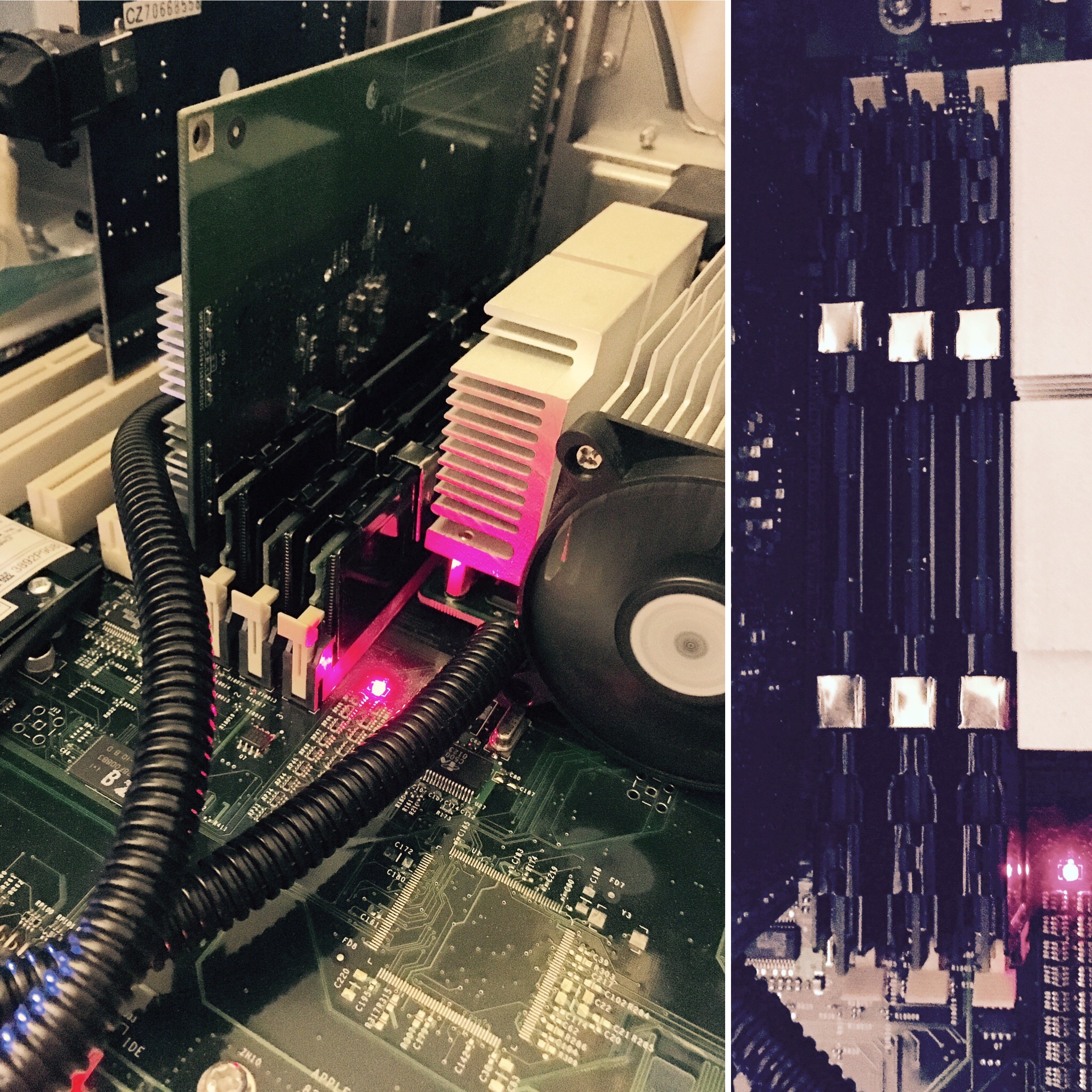

I noticed that this dual processor certainly kicks more heat. No big deal. haven't had this much fun in a while although I've officially gone over my $20.00 cap as I'm at $35.00. Ohhh well 🙂

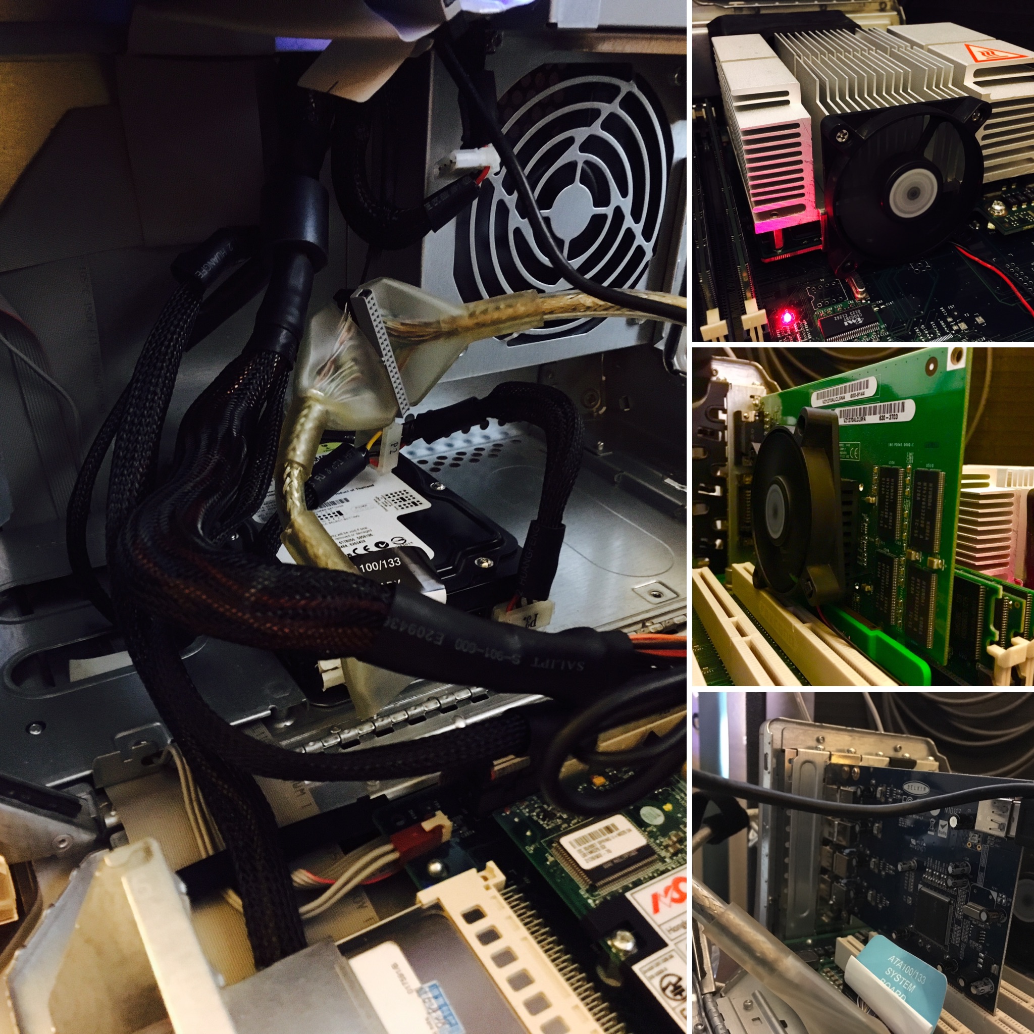

I'm not a fan of exposed wires, so I sleeved the power supply cables. I also got some pics of the fan on the GPU, CPU and the USB2.0 card. I picked up some aluminum ram heat sinks that will match the CPU heatsink and some aluminum heat sinks for the video card ram chips. Not at all necessary I know but it was cheap and I think it will look cool 😀
After my old OS9 EXT died, I attached a 2.5 20GB IDE on the inside USB2.0 port for classic which has a cool blue LED which throws some cool color in the case. I did buy a sata controller that was advertised as PCI but ended up being PCIX + backwards compatible (WinXX) and when installed bricked the G4, so out it came and shipped back to seller. Anyhow, the hunt for a Sata controller marches on 🙂

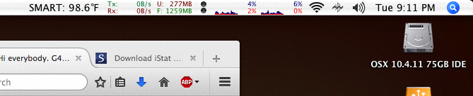

Does anything like Temperature Monitor show the CPU temperature on your computer? I can't remember if it works on the QS.
Reactions: 1042686
Thanks for sharing your project; glad you're having fun with it!
Temperature Monitor will. MenuMeters and iStat Menus only read the hard drives.
Reactions: 1042686
TempMonitor will but the only download I could find was through wayback machine and it only displays the HDD temperature as it is the only sensor. I guess the QSG4s didn't have many sensors that these apps could use.
I like istat (use it on my G5) but the oldest version that I can find is 2.0 which will only run on 10.5.8. If I could find one for tiger, well that would be awesome. Until then, for this QSG4 box, I have been using menumeter for at least a partial of what's going on (CPU/disk/Memory/Network) although Im not very into the GUI. I prefer the GUI of istat. Still, between TM and MM it is at least something.
iStat Menus 1.0

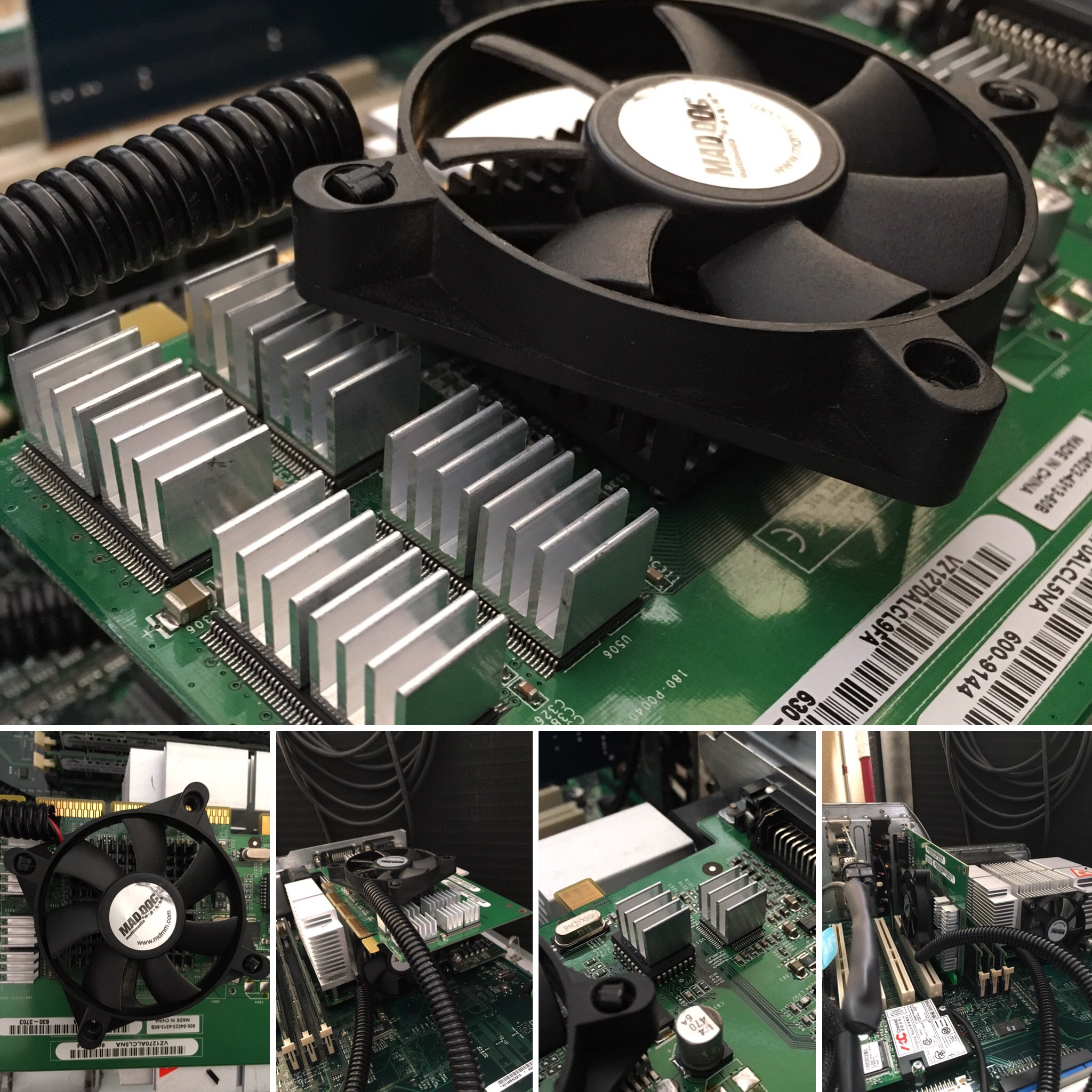

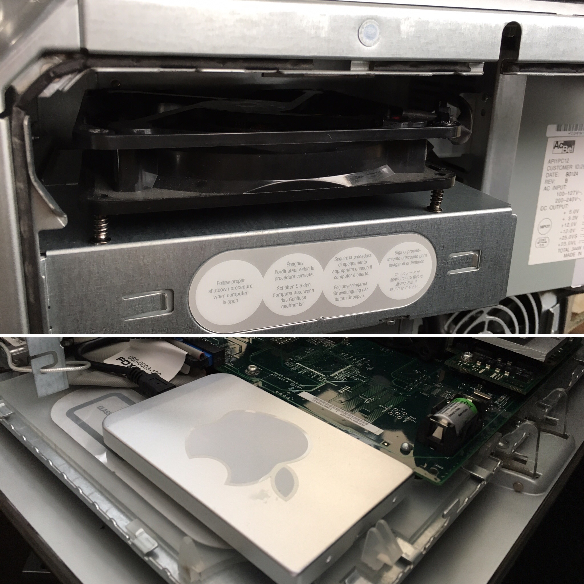

So the latest in my QSG4 Refurb - heat sinks for the GeForce2 MX onboard GPU memory came in. I repositioned the GPU fan I added as well.
I had a big 140mm case fan taking up space from a gaming PC tear down so I added that in the only place I could fit it which was over the optical drive. I didn't expect it to do much, but have noticed a drop in temp of about 1-3F when playing Q3A for example. I also added a 2nd 150GB USB2.0 external hard drive (Pulled from my 08 unibody macbook SSD upgrade) on the inside of the case with a cool Apple logo on it. I like how that turned out.
The fun continues.
Ram heat sinks finally came in. They were supposed to be silver but came black. Ehh @ $0.99 each shipped who cares lol. They look fine. Now I'm waiting on the Sata-ide adapter to hook up the 500gb WD under the optical drive.
I guess I could paint pen them silver if it gets on my nerves lol. 😀
