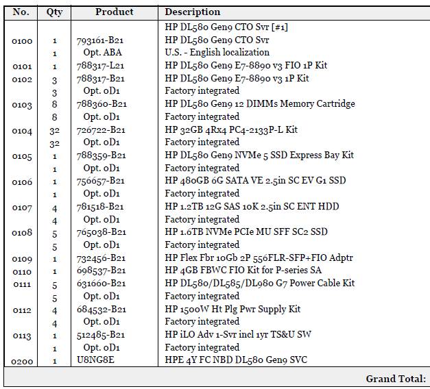

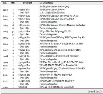

If you need ten GPUs, I have a feeling that you should think about whether your needs are beyond what the Apple ecosystem can support.
If you want advice about Linux or Windows systems that support ten GPUs, just ask. (Although five Titan-X cards per system is as far as I've gone so far.)
