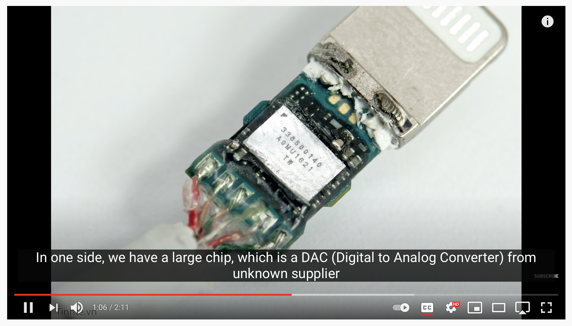

Here's a tear-down snippet that you can find in YouTube of the audio specific Lightning adapter showing there is a DAC chip and even a mini amplifier to help boost that signal.

So using a Macbook Air (2018) + DAC + Apple Audio Cable + AirPods Max is useless? (this was meant to listening to my WAV/FLAC/AIFF files)
No, that's exactly what the cable's use is for - providing alternative means of listening to various audio sources on the APM.
