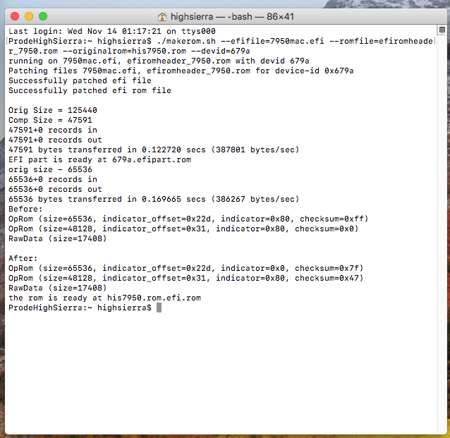

What you should be showing us is your Netkas bundle Terminal script.
Using the Netkas Bundle I have successfully flashed ..

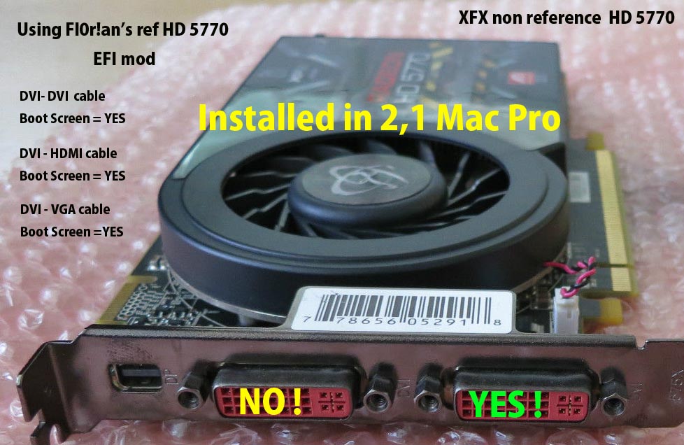

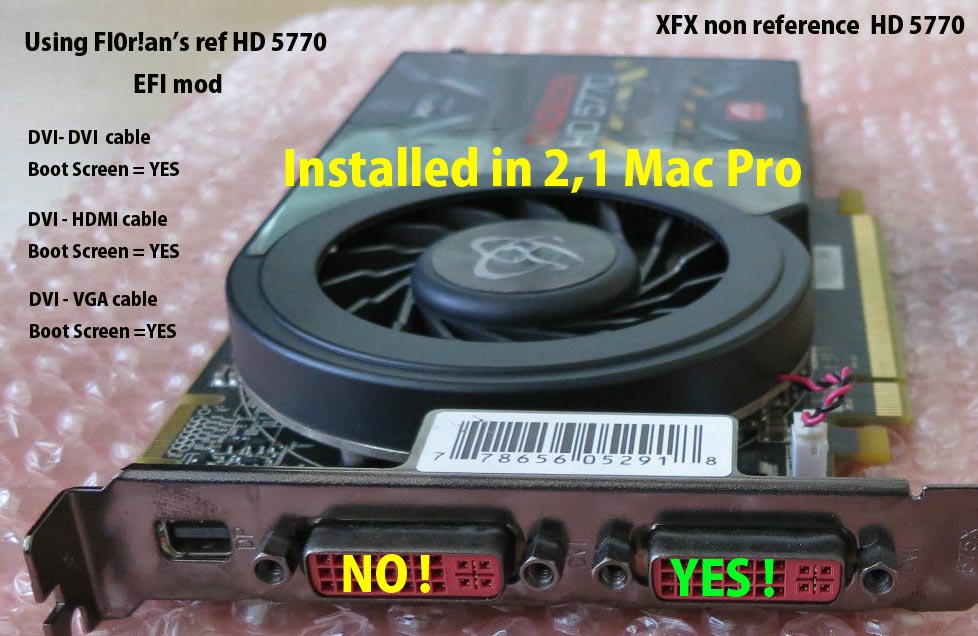

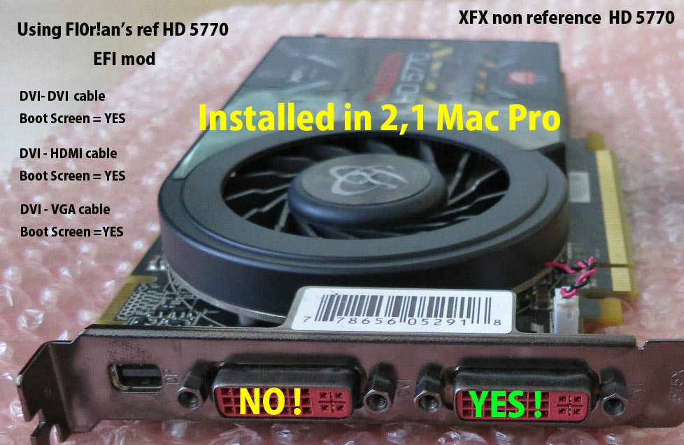

Some cards with TWO DVI ports only use ONE of them - that information is readily available in the Netkas thread.
For example here is a pic I posted on Netkas regarding the XFX HD 5770

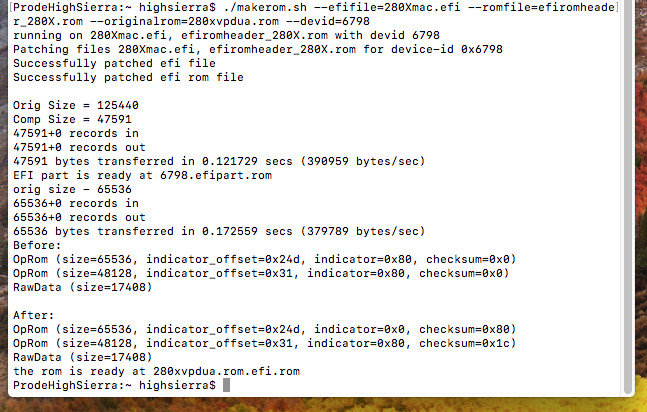

Show us your Netkas terminal script for the R9 280X .. it's not a secret.
thank you for your help, sorry for reply late I was in business travel, now I'm back, I will show both sapphire Radeon 280x vapor dual x, and his Radeon 7950 netkas script screen here, please help, thank you so much.
I've tried every 280x and 7950 I can find with two DVI, by flashing successfully netkas script, no one can activate the second DVI on mac pro (nor mac os x neither windows Bootcamp)
The 2nd DVD port not working is a known issue.
There is no "efiromheader_280x.rom in the Netkas BUNDLE.
The 7970 " romfile=efiromheader_7970.rom " is for R9280X
I sued this for my Sapphire Dual-X HD 7970 . . .
./makerom.sh --efifile=7970mac.efi --romfile=efiromheader_7970.rom --originalrom=cardname.rom --devid=6798
This will work with the R9 280X
