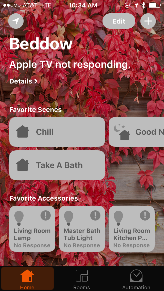

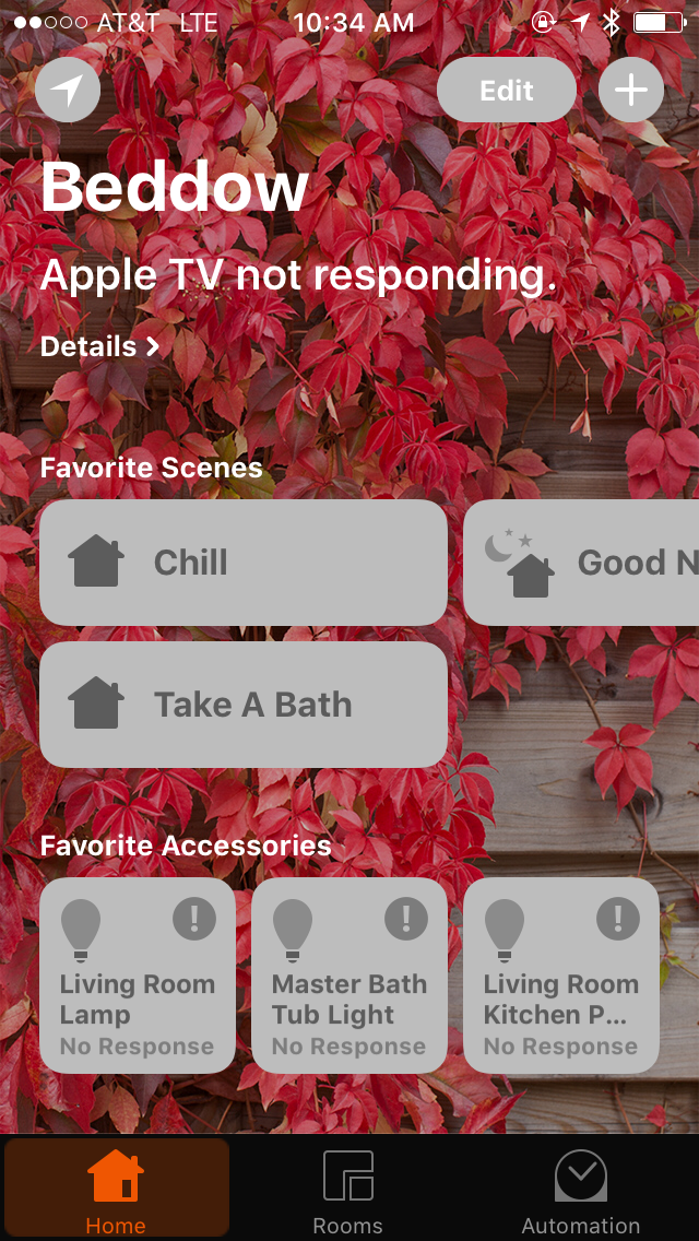

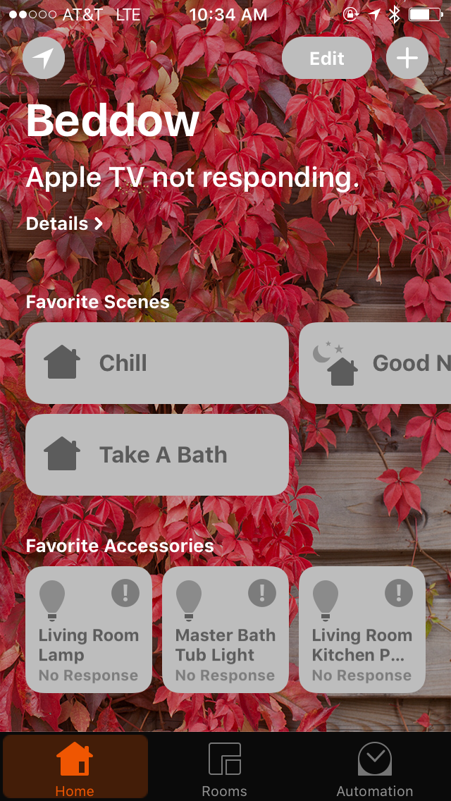

I'm having trouble maintaining the connection with Apple TV 4 as a home hub. I had it all working last night and I could activate devices using LTE-only, but in the morning, the connection was broken. Devices (all Phillips Hue bulbs with new bridge) respond when using WiFi, but when Wifi is off and I'm using LTE, I get the message "Apple TV is not responding."
I realized my Apple TV was set to sleep after 10 hours so I guessed that was the problem. Even after waking it and setting it to Never, the connection has not resumed.
Here's the weird thing: it is only broken on my iPhone 5S, not my iPad Mini 4.
This happened last week too, and I spent a couple hours last night restarting Apple TV, logging out of iCloud on my devices, waiting for HomeKit to show up on Apple TV under Settings -> iCloud (still haven't figured out what I did that finally made that happen.) When I went to bed, all was well. This morning, iPhone 5S is back to square one. iPad works fine. If it were the other way around, I wouldn't be concerned but I want my phone to have location triggers since I don't always carry my iPad.
