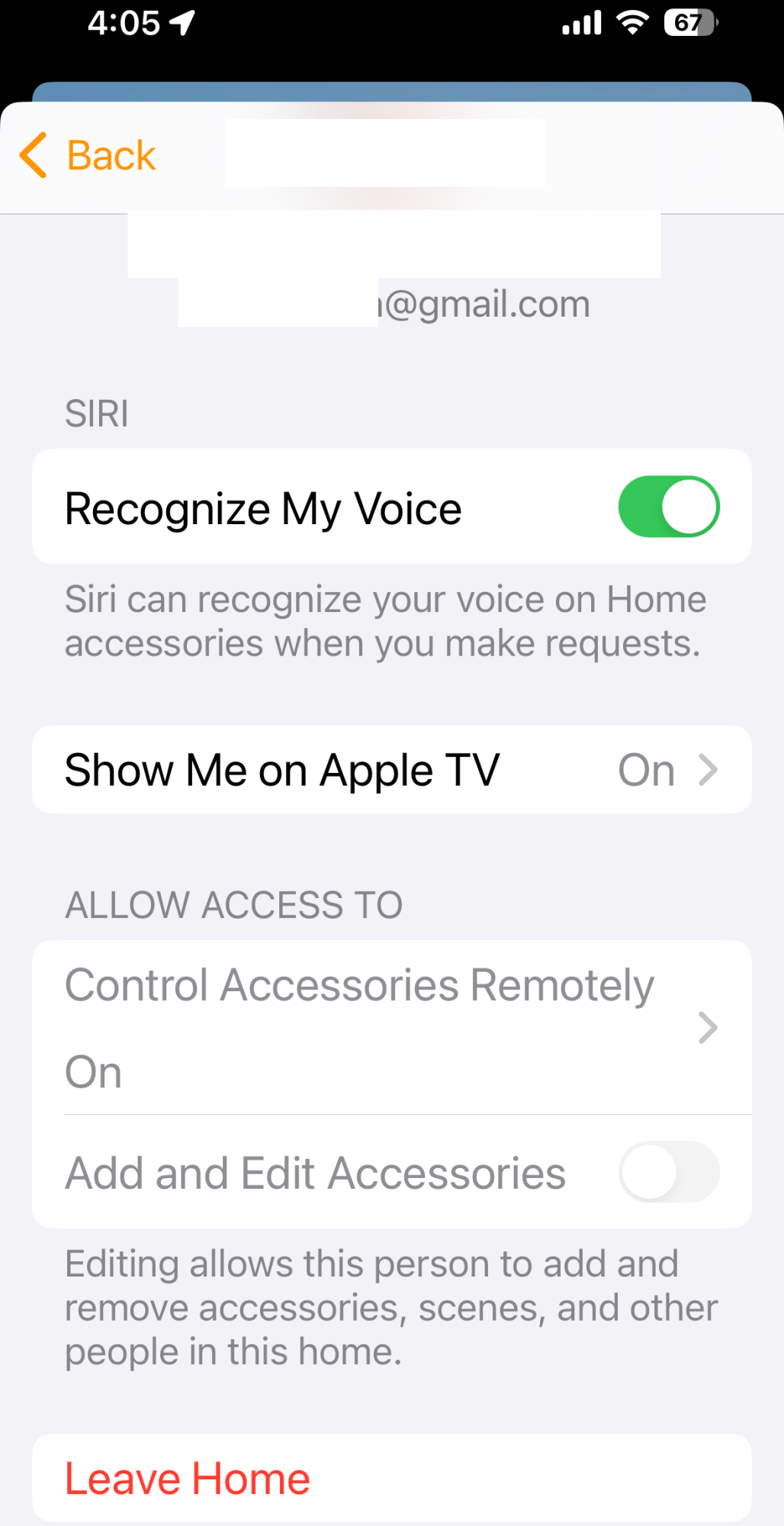

I then had my mom invite me as a user to her Home and I accepted. In the Home app, I can switch from my house to their house, and everything works perfectly while using the Home app from my iPhone. It shows me as a "Resident" of their house who can "Control Accessories Remotely".

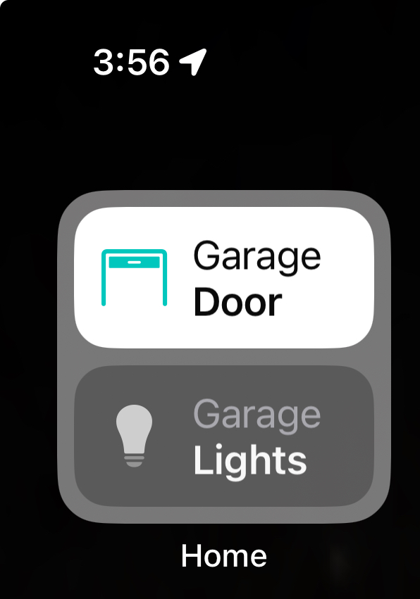

Since switching between houses in the Home app is a cumbersome process especially when I simply want to open/close their garage door from my car, I setup a Homescreen Home Widget on my iPhone. When choosing accessories for the Widget, I set "WidgetHomePicker" to my parents' house. I then added their garage door opener and light switch to my iPhone.
Here's the odd part: When I am not on the parents' Wifi, I cannot open/close the garage door via the Widget. It turns white after I tap it and nothing happens - the door does not move. It's not a Hub or network issue, since it works flawlessly via the Home app; and the Widget always updates immediately to show the correct open/close status of the door. It's just a p.i.t.a. to open the Home app, switch the Home, find and tap the tile... would rather just tap a Homescreen Widget icon. The light switch works using the same Widget... just not the door opener. BTW - all my other Home Widgets, which are connected to my primary residence have never had this issue.

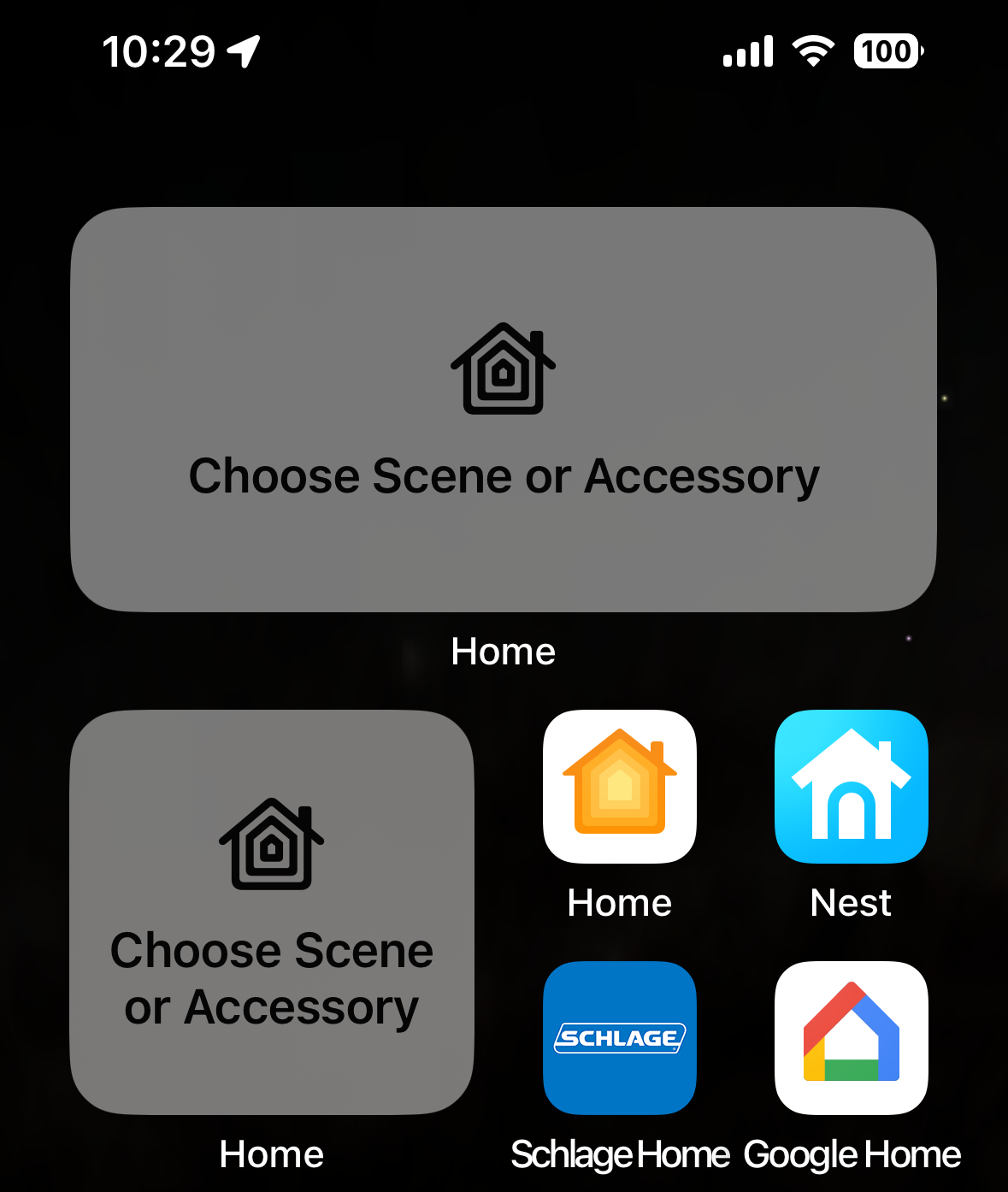

Yesterday, when I was at a restaurant miles away from both houses, I noticed a "choose scene or accessory" message on the Widgets associated with my primary house...
These Widgets never exhibited this behavior before. So then I looked at the Widget for my parents' house and it looked normal. I went into the Home app and saw that my Parents' house was selected. When I switched back to my own house, my Widgets returned back to normal. I was then expecting the Widget for my parents' to show the "choose scene or accessory" message, but it did not. I decided to delete and recreate the Widget for my Parents, and then it showed the "choose scene or accessory" message.
Aha... when toggling between the two houses in Home app, the Widgets for the other house are disabled and show the message. Not ideal for my purposes, but at least a more consistent and logical GUI experience.
HOWEVER, once I returned back to my parents' house, this behavior ceased, never to be seen again. It does not matter if I am at either house or some other location, toggling the house within the Home app now has no effect on the Widget appearance. They look the same as always now. I am on latest iOS, no software updates, so seeing this once and never seeing it again is not explainable.

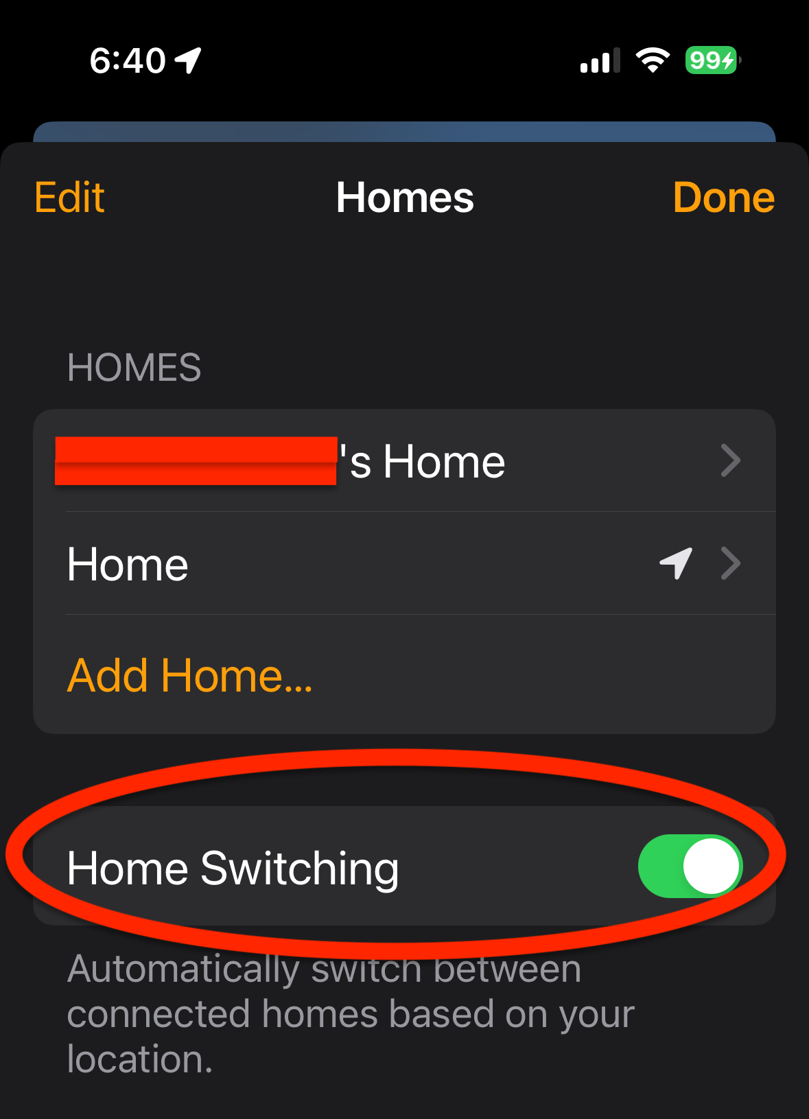

As far as the setting for automatically selecting/switching houses based on location:
  1. The automatic "Home Switching" does NOT work. I have it enabled and it basically does nothing. I return home and my parents' house remains selected. (I arrive at my parents, and my default house remains selected. Complete garbage.)
  2. When you're at neither house, it would be nice for Widgets to work without having to go into the Home app first to re-select the house. (I don't even know why this needs to happen, since there should be no confusion internally; the devices and accessories are completely unique and remotely controlled by their own Home hub.)

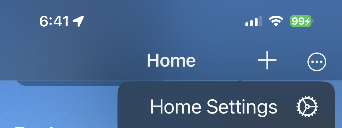

Go to Home Settings under the three dots...

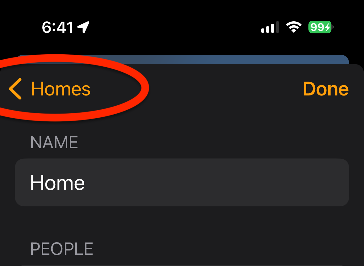

Then on the next screen, tap on "< Homes" in the upper-left to enter another screen that is literally hiding under your nose. Seriously... took me forever to find this and it's right there the whole time disguised like a "go back" button.
Then toggle the "Home Switching" feature, which I have yet to see do anything at all, ever.
