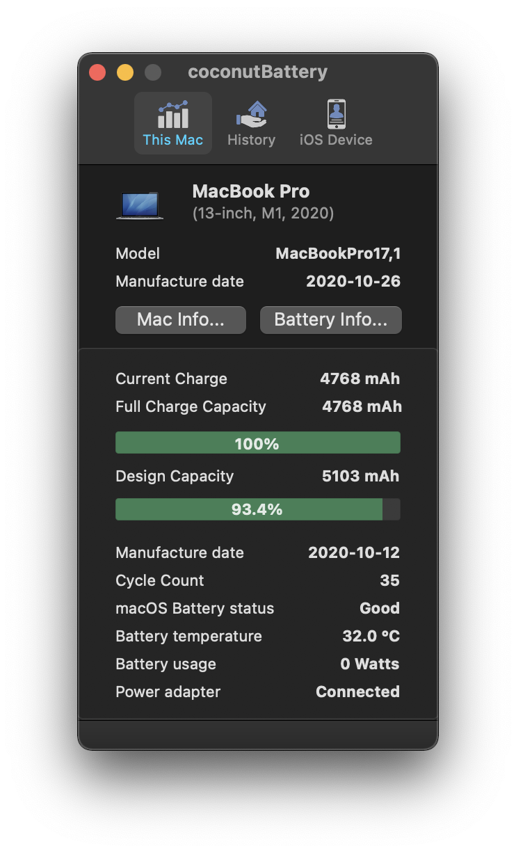

Would some of you guys mind uploading your battery stats in coconutBattery?
I've made zero considerations toward the battery in my MBP13". I've run it flat maybe once. The majority of the time it's charged to 100% as i work on my desk 90% of the time.
This particular MBP has been in use since the 29th of November as i had to replace my first MBP for a case defect (holes not drilled correctly on the speaker grill)
Personally it's a little alarming to see my battery at 93% capacity in a matter of 6~ months.

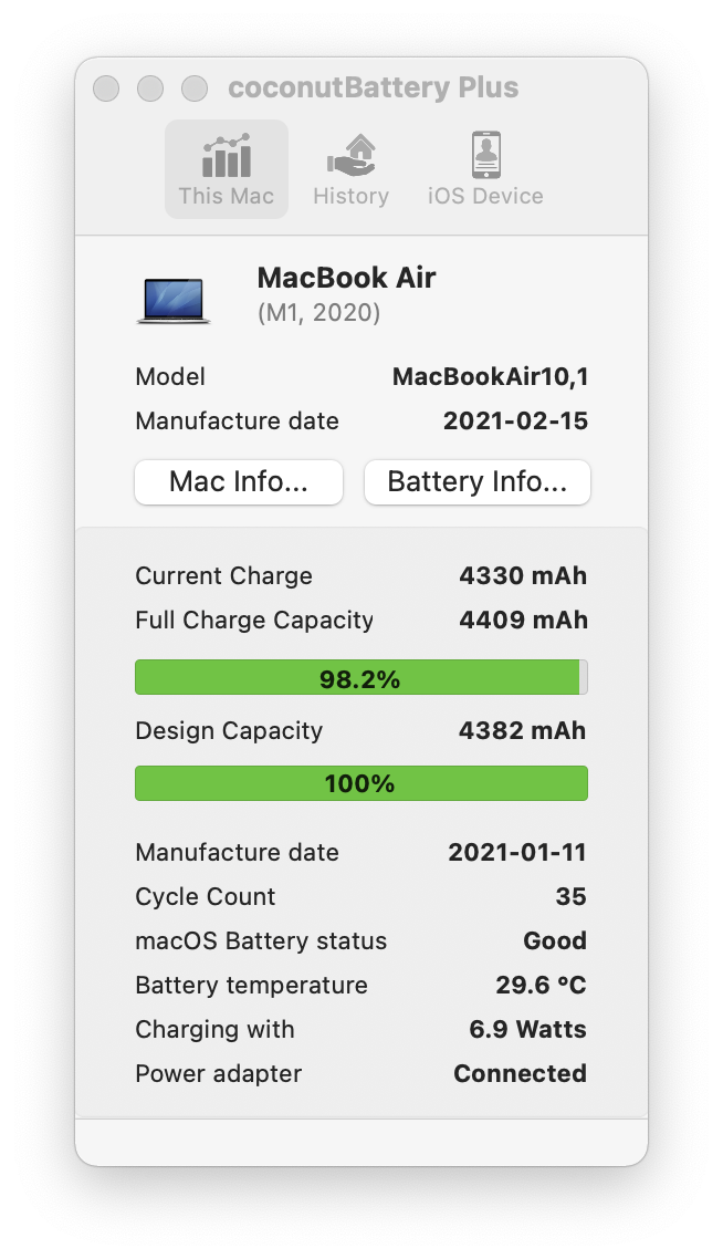

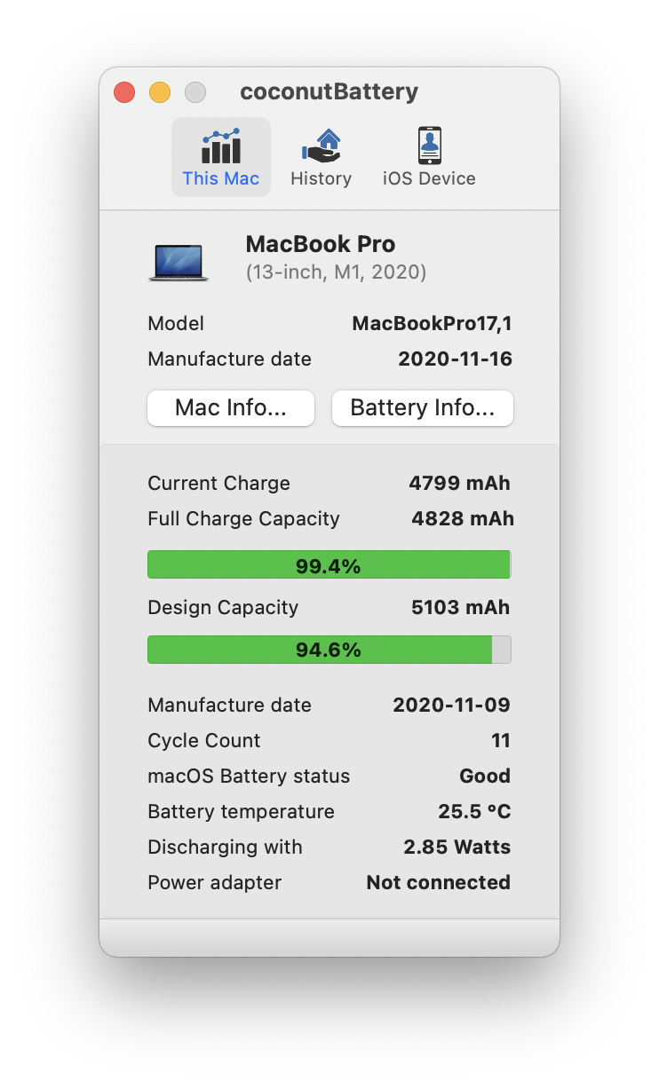

Coconut and the other similar utilities uses the current max capacity value reported by ioreg obtained using the Terminal. I reported my Better Battery 2 results in This thread.
Note the number varies from day from day to day and can go up as well as down. Mine has been down to 94% and back up to nearly 97%.
