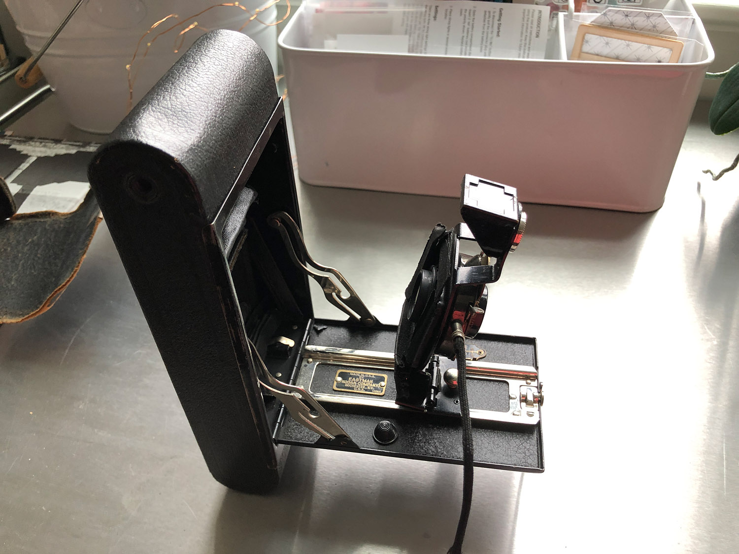

My letter dates the camera to Christmas 1923 but I don't think putting film in this is going to do much. :( I don't even know what is supposed to be inside, but I know it isn't supposed to be exposed like that.
ETA: I'm in the middle of googling. Although the placard on the camera does actually say Brownie, I think what I have is in fact a Kodak 2A Hawk-eye Model B Folding Camera.
ETA #2: I watched a video and it seems to operate exactly like the Hawk-eye but the markings are slightly different. The front of mine says No. 2-A Folding Autographic Brownie. I think it might work if I can find replacement bellows (and then figure out how to install them). I would make something on my own if I had the foggiest notion of what to do; I'm handy with a sewing machine and fabric might last better than the chipboard like material that seems to have disentegrated. I'd just have to figure out how to give it structure.

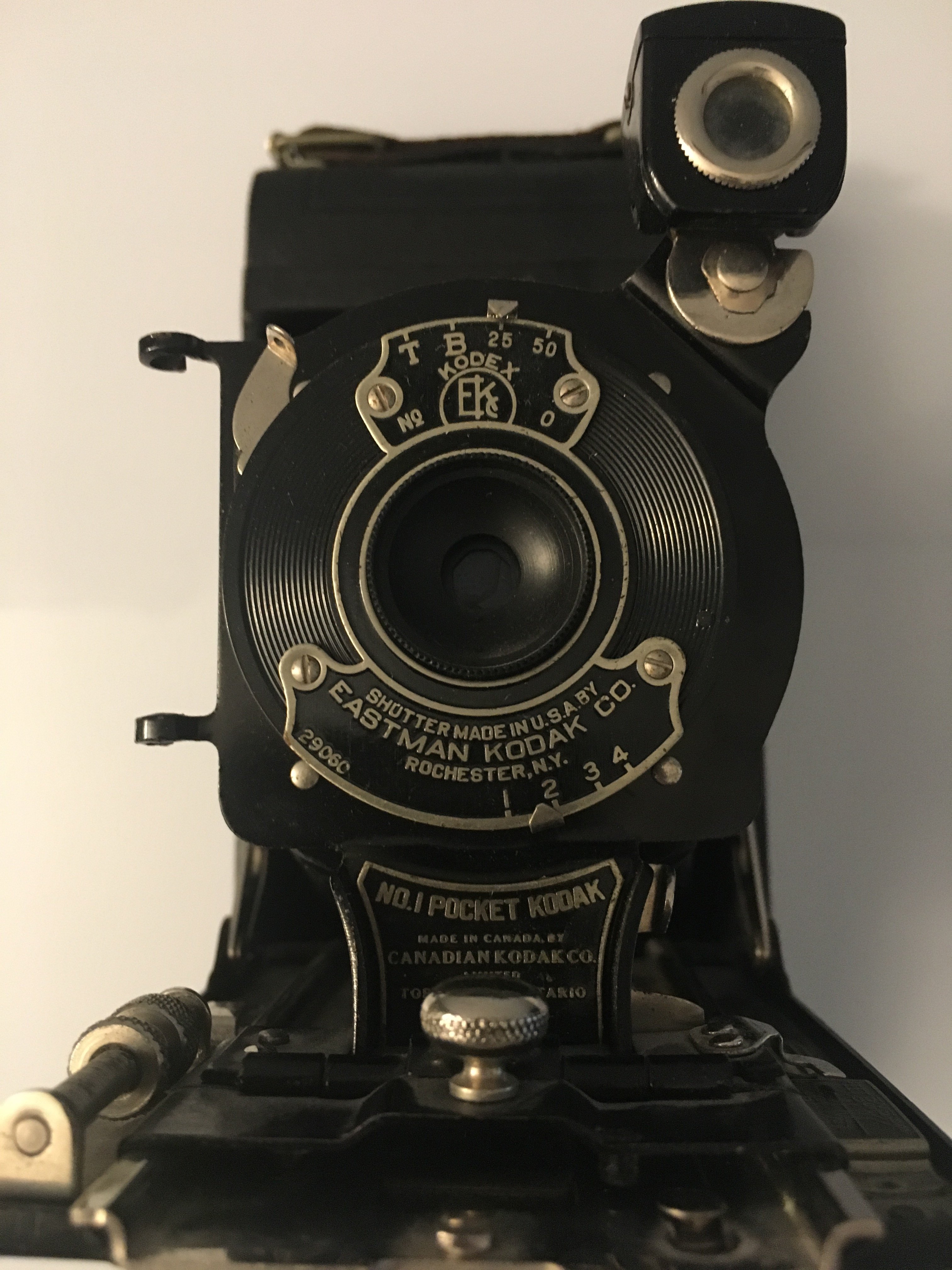

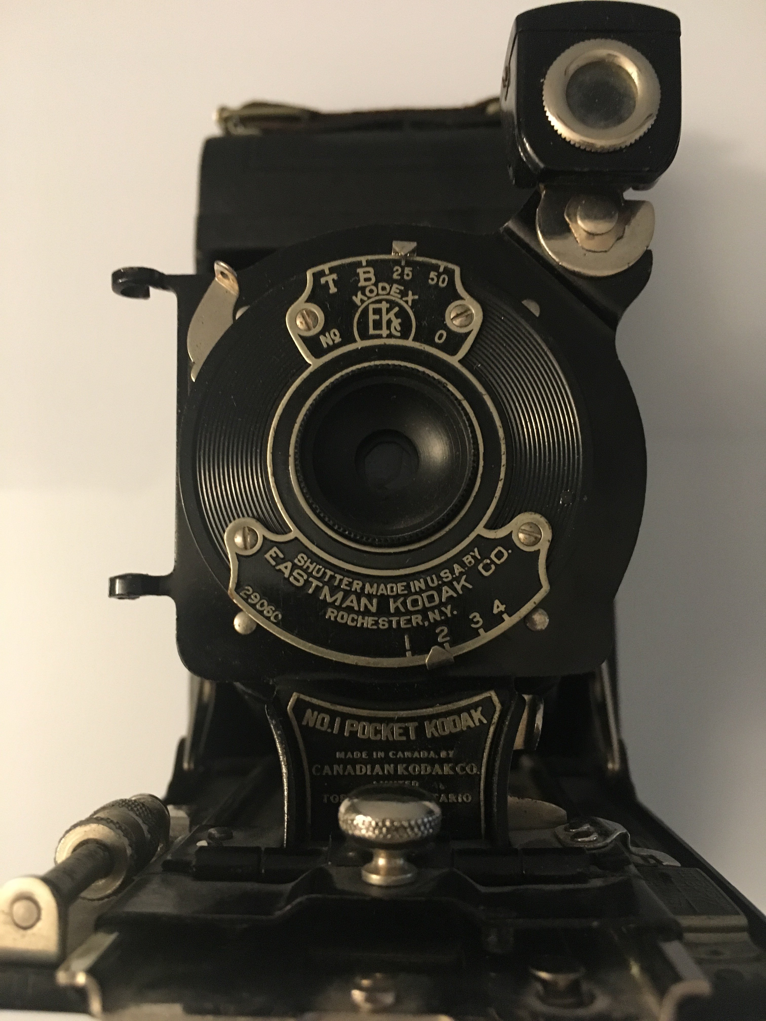

Look at brownie-camera.com which is very comprehensive . While the box Brownies are what people think of, they did make some folding Brownies that were based on the corresponding folding camera, such as No. 2-A, but lacked some features such as little or no variation in lens or shutter options. (The also made a No1 Pocket Brownie). Yours with "Brownie" on the label probably is a Brownie. They must have had big pockets back in the day, but appears to be a smaller camera. Notice on my No 1 Pocket that it has additional settings to adjust the shutter (above lens next to shutter lever) and aperture setting 1 through 4 below lens.

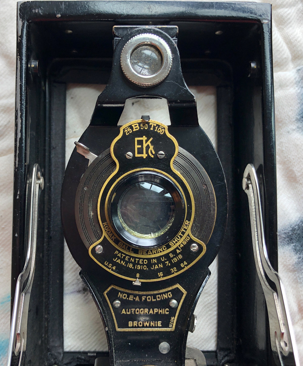

Here is a photo of the front of it. I've torn it apart and removed the bellows (which were in pieces anyway). The shutter works as far as I can tell, and this also seems to be a higher end model as it has an aperture of f/4 - most start at f/8, as well as several shutter speed options (not sure the difference between B--which I think is Bulb and T). I also have what I think is a release cable, although it doesn't work - it attachs to the camera but there's no tension to cause the shutter to release (I really don't care about that part at present). Right now my issue is that as part of the folding mechanism, their are two parts of the camera that slide on the rails, with a hinge in the middle, to allow it to fold. The rear portion of the slide will not slide onto the rail; I think somehow it was all just jammed back in the box at one point and now it's misaligned. I'm trying to pry the back slide portion open a bit to allow it to slide onto the rail. Once I get it sliding properly I'll figure out how to make a new bellows.
ETA: I got the slide/rail issue solved. It's super tight to slide, but at least now it is all aligned. Maybe a tiny bit of lubricant will help. Now to solve the bellows issue. Oh, and converting to a 120 film and then figuring out where to buy and process 120 film. :eek:

Number 1 pocket Kodak! lol.... that is a big pocket!
