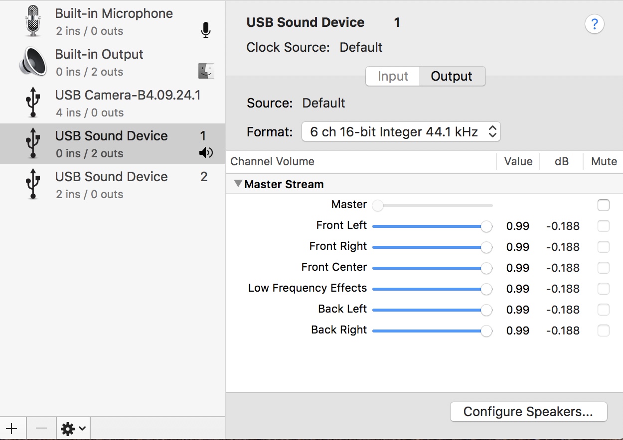

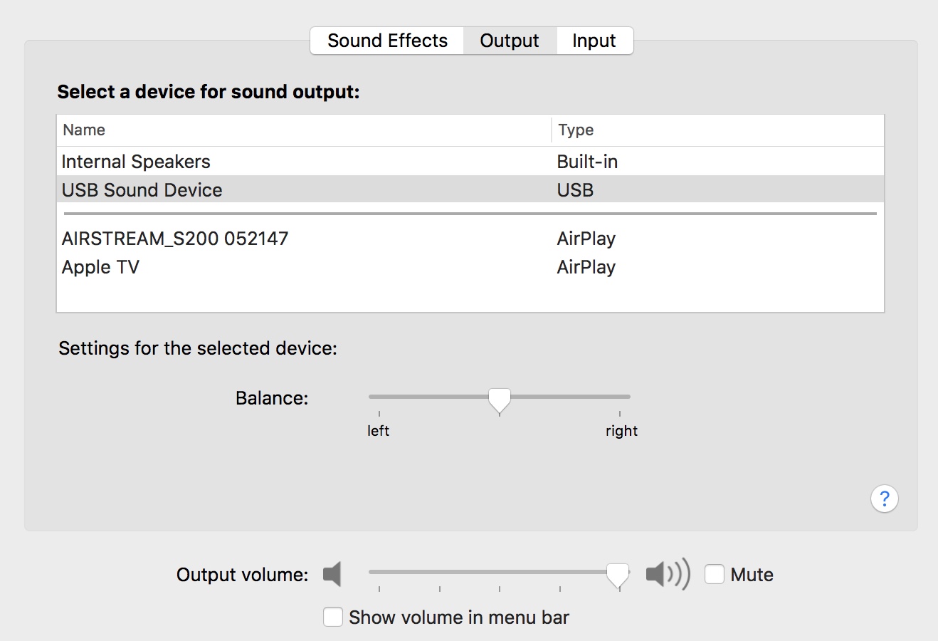

OK, so I bought one of the USB sound cards I linked to above, and the optical out just didn't work. Line out was OK, but nothing form the optical, which is what I need.
If you still have the device at hand,
What devices show up in the Sound Output preference pane? What about Audio MIDI setup?
Thanks for that. I was just packing it up for return!
See attachments.
