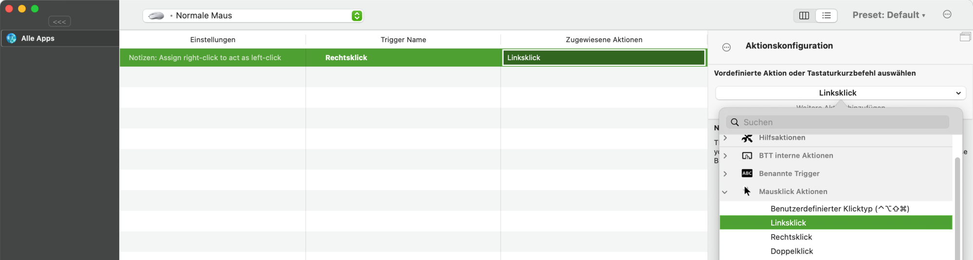

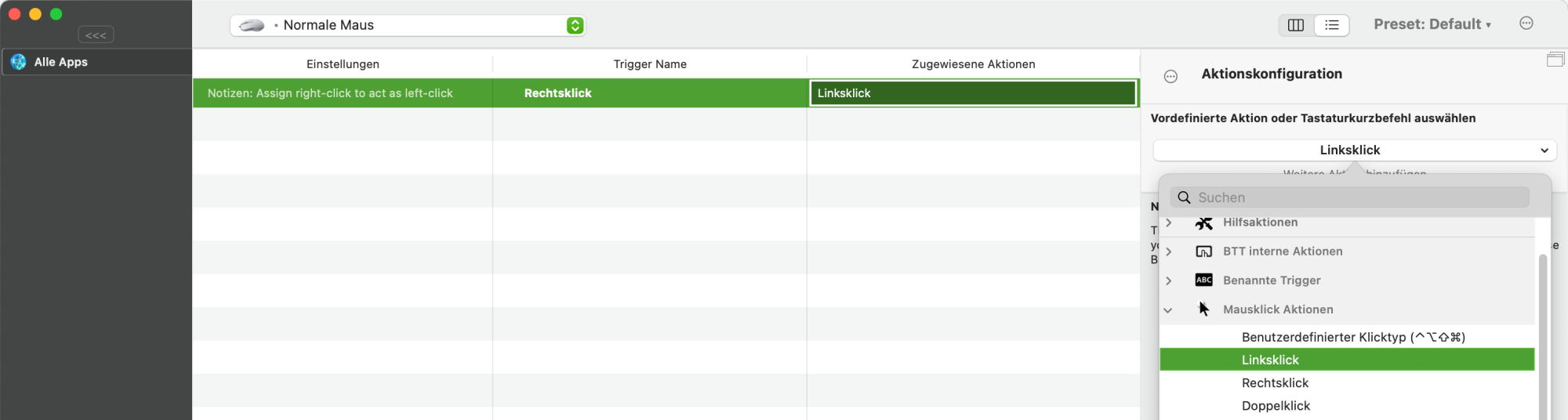

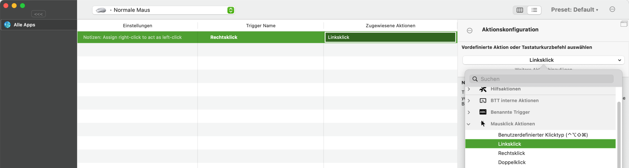

I do not know of a free software but besides a million other things, BetterTouchTool can re-assign the right-click.
In the attached screenshot, it is set to always act as a left-click. (sorry, not in English and not the most current version)
Price:
- 45 days trial.
- 2 years of updates, then using that version forever: 10$
- Lifetime license/updates: 22$

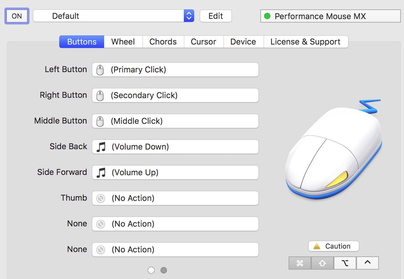

OP:
Here's a solution that can make BOTH the left and right buttons "primary" (i.e., "left") clicks.
Download Steermouse from here:
Now, install Steermouse.

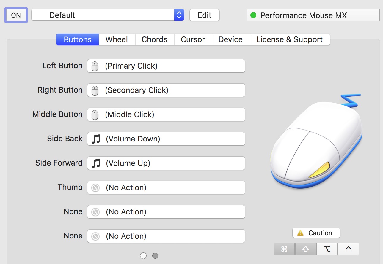

Get to the main screen.
By default, the right button is set for "secondary click".

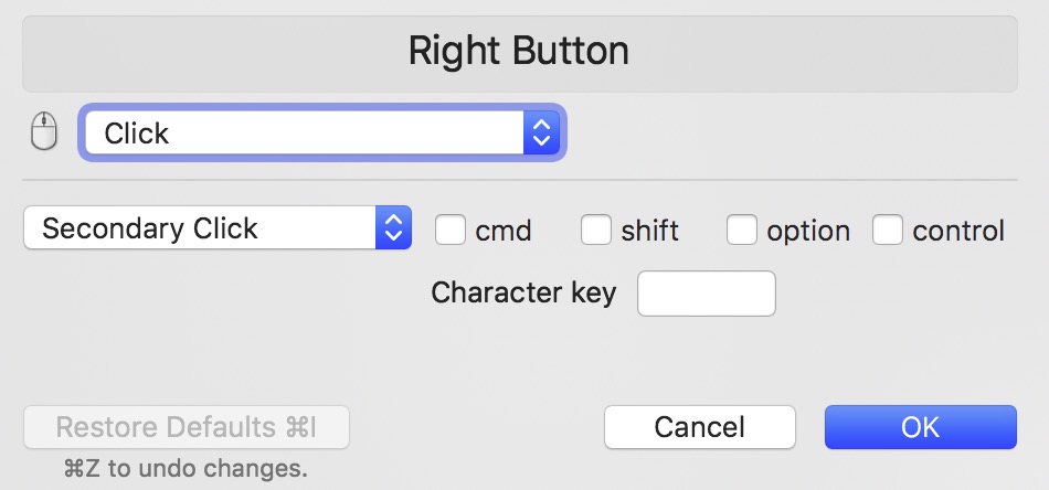

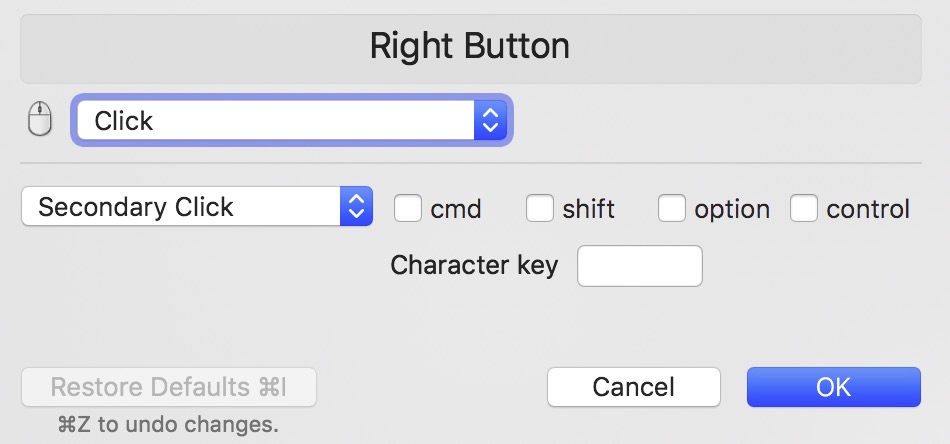

Click on the right button popup, and you'll see this:
Now, where it says "secondary click", choose "primary click" from the popup window, then click OK and close Steermouse.
Now BOTH the left AND the right buttons are the "primary click".
Hope this helps...

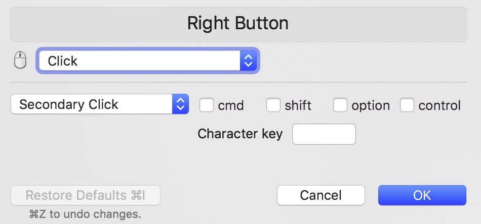

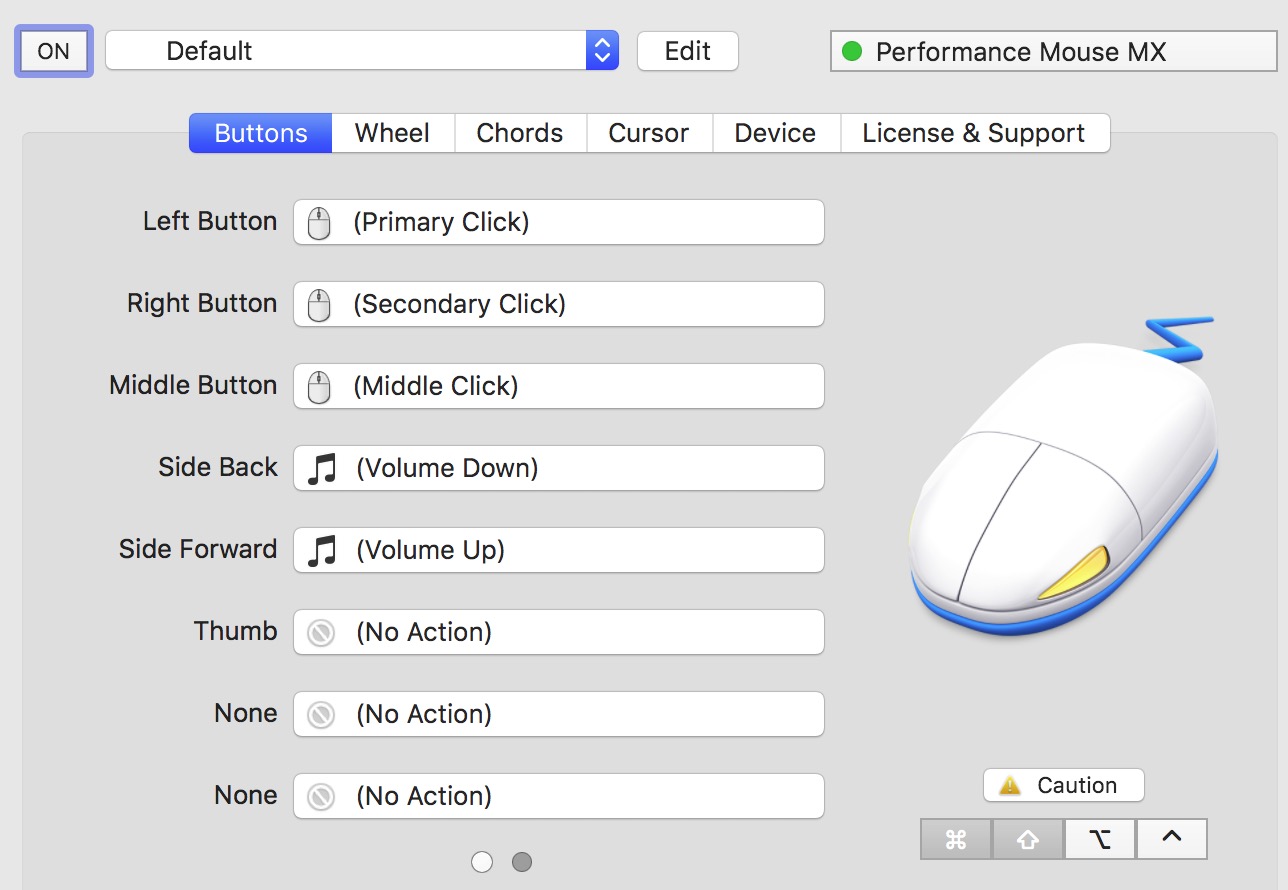

Hope this helps...
