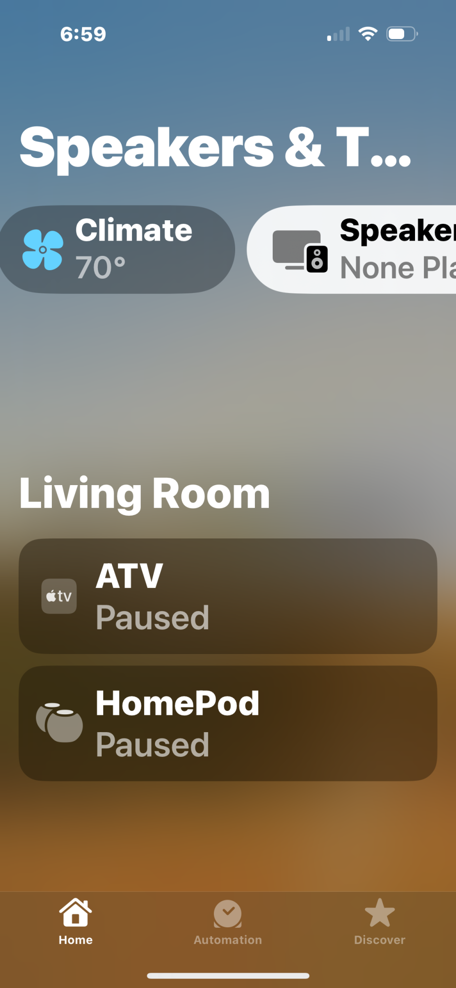

Okay I got it updated then plugged it in and got it set up. I have them working as a pair (my two minis), so when I do Apple TV, I'm hearing sound from both.
However, in my home list, I'm showing HomePod, and it shows two speakers, but they aren't separate in my list. Before I could see them as HomePod L and HomePod R. Once this finished I only saw HomePod R and both speakers show up under that. I changed it to just HomePod til I could get it figured out.
So any idea how in the world I do that?

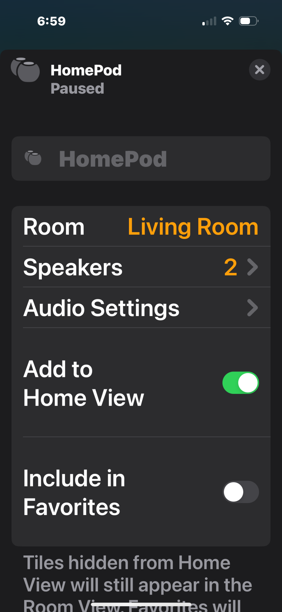

I know these are a bit large, but this is what I see on my screens. Why can't I get them to show as two separate minis?

And also, when I play music from my phone, it shows up as ATV, but it plays on my speakers.
I’m so technologically challenged. 😩
Okay I think it was doing that because Apple TV was on. I turned it off and now HomePod comes up, and when I click that it plays on both speakers.
I just thought I’d have each speaker in the list so if I played music from my phone or asked Siri a question it would go to just one speaker.

HomePods are managed from your Home App from either iPhone or Mac.
When paired as you have, they show up as one HomePod. You can look at their settings and see them as two "speakers."
If they, in turn, are captured or paired with your AppleTV, they will not show up as HomePods in AirPlay. You need to target your ATV to play through them.

When you make them a stereo pair, they essentially become one device. So airplay will go to both, Same for music played from the music app. It will break down the stereo channels, so each HomePod only gets the left or right channel.
