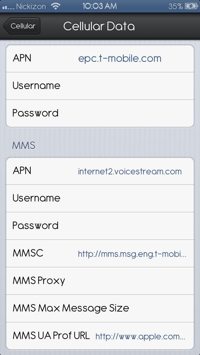

I was able to get my IPHONE to work with the epc.tmobile.com.... (WITH & WITHOUT THE GEVEY TURBO SIM CARD) this forum explain it perfectly...
settings> general > network > cellular data network > advance > APN
for APN type: epc.tmobile.com
leave "username & password" blank

I have worked on unlocking my 3g to use on t-mobile for almost 2 days, I finally jailbroke it, but my baseband was 5.9 and I couldn't roll it back. Thankfully today, I used Pwnge Tool and Ultrasn0w to unlock it with the 3.0 OS. I thought everything was fine until I realized my data plan wasn't working which was a huge dissapointment. I tried numerous APNs and had no luck, I was begining to lose hope and thankfully I stumbled upon this forum and saw your post... it worked instantly!!!!!!!!!

Anyway - in the US you need an unlocked iPhone to use it on T-Mobile.
There are two ways to unlock.
Factory Unlock - The phone was sold unlocked. Not currently available in the US - maybe you live close enough to Canada to try to snag one from an Apple store (make sure to call ahead :D )? Anyway, factory unlocks are permanent. Can upgrade with regular iOS updates from Apple - warranty is fine
Jailbreak - You jailbreak, then run the unlock program/app. Note, the current basebands you will get on a brand new phone are not unlockable, although they are working on it. For this kind of unlock, you cannot upgrade through iTunes when Apple releases an update, or you're undo the unlock and (generally) upgrade the baseband to an not unlockable version. Technically voids warranty (although you can restore to stock firmware and get it serviced, but then you lose the unlock)
