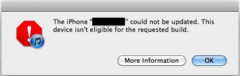

It contacts and verifies if the ios version you're trying to install is approved by apple's servers before it allows the restore/update to go thru.
If the ios version is still signed by Apple's servers the install/restore/update is allowed to go on, if not you get the error message below.
