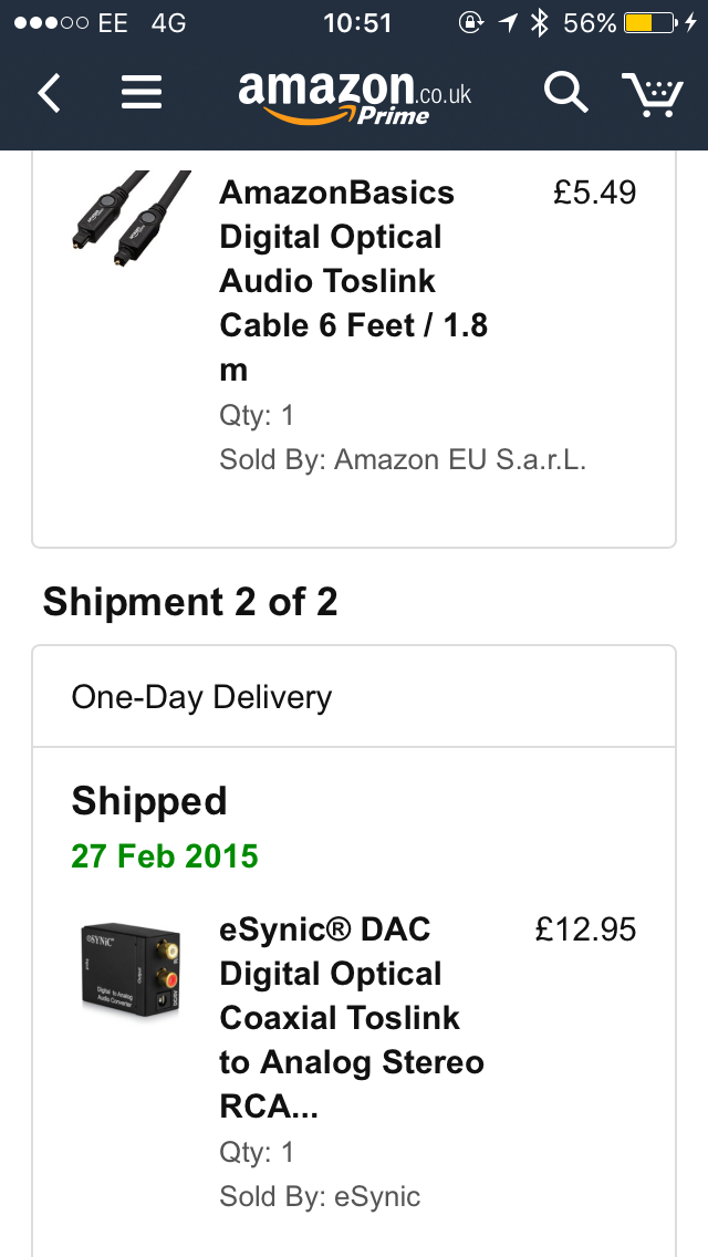

There are work arounds (appleTV or airport express and airPlay) but the SONOS product has to have line-in. Also I find airPlay a tad flakey and have stopped using it except with watching a youTube concert (airport express line in to Play 5 1st gen).
SONOS products that have line in-
  • PLAY:5 (gen2)
  • PLAY:5 (gen1)
  • CONNECT
  • CONNECT:AMP
https://sonos.custhelp.com/app/answers/detail/a_id/1091/~/using-line-in-on-sonos
so you would need one of the four above with your appleTV connected via 3.5mm and then airPlay from apple music app to the appletv
and these three item - https://www.amazon.co.uk/3-5mm-Phon...t_1?ie=UTF8&psc=1&refRID=0K15M761HB8DEVF9M8HP and
