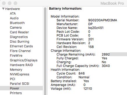

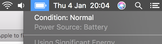

I've seen MacBook Pro Retina with swollen battery and System Info still shows battery condition as "Normal".
Yep same on mine...
I'll keep looking for 3rd party places to repair it, there's got to be someone out there who is willing to do it!
Yep same on mine...

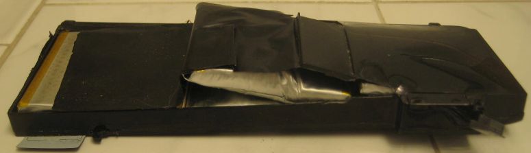

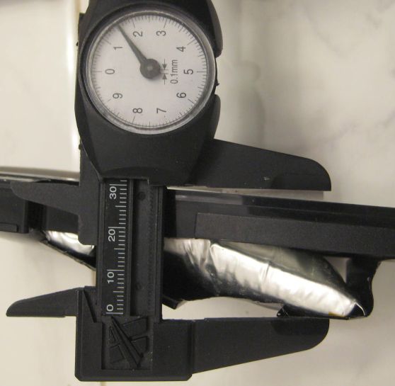

I had a failed Apple A1322 battery in a MacBook Pro A1278 Unibody featuring a 2x2.4 Intel Core2duo, 8GB DDR3 Ram, 250GB of SATA hard drive and running Mac OSX 10.9.5 Maverick. Out of the 10 A1278 I checked, two failed because the batteries bulged pushing then crushing the trackpads and keyboards. On the pics, you can see that one of the Li-ion Polymer battery (Model 1322, 10.95V at 63.5 Ah, 846 cycles) expanded from 13mm to 33mm. Further, after being taken out of the laptop into a fire-proof box, it vented and might have caught fire judging by the soot. Looking at the web, this battery expansion is quite common: Apple replaced a few of these batteries during a very short period of time, and now asks for $129 to provide a spare. As far as I know, Apple refused to recall the batteries, only accepting to replace them on a very limited ‘one of a kind’ scale, while leaving most of the people without help with their battery problem. Most common comment of the Apple ‘Genius’ faced with a bulged battery was ‘you need to upgrade’ !
Fortunately, the battery on the A1278 'Unibody' is removable and user accessible providing you have a pentylobe screwdriver!

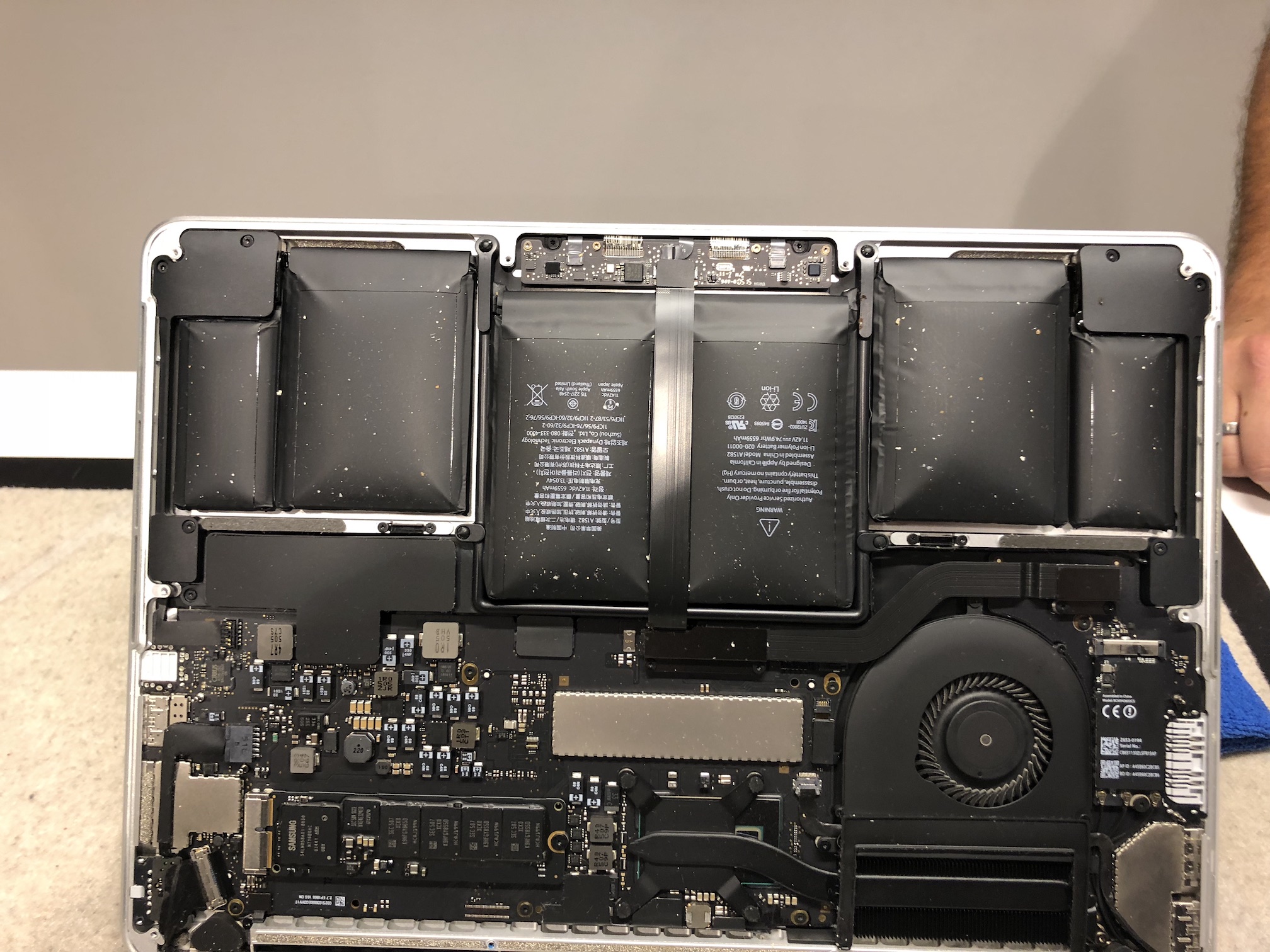

You'll need to get this fixed as soon as possible — eventually it will start pressing against the trackpad, making it not work, and it can break the glass too, which is expensive to replace.
If you're out of warranty, then find a good 3rd party repair place that has good reviews, and get it done there. Though it's rare, if you can, make sure they use genuine Apple parts.
There is also an iFixit tutorial on how to do this yourself if you're confident with it, but the battery you buy from iFixit won't be genuine so I wouldn't recommend it. The repair is difficult and risky both to you and the computer, and won't save you much money, and has no warranty.

I have this issue on a 2014 rMBP. Trackpad is behaving erratically, case is badly bent and the lid does not close entirely anymore. Time for an emergency visit to an Apple Store I guess.
Of note, I've been using this rMBP heavily since buying it 2014 and 99.9 percent of the time in clamshell mode always plugged to power. The battery only has 14 charge cycles ! I had no idea it is not recommended to leave a macbook always plugged to power and made this discovery researching this problem.
Anyway, my next laptop will be not be a macbook but a workstation laptop designed for the battery to be replaced easily with a large battery enclosure.
