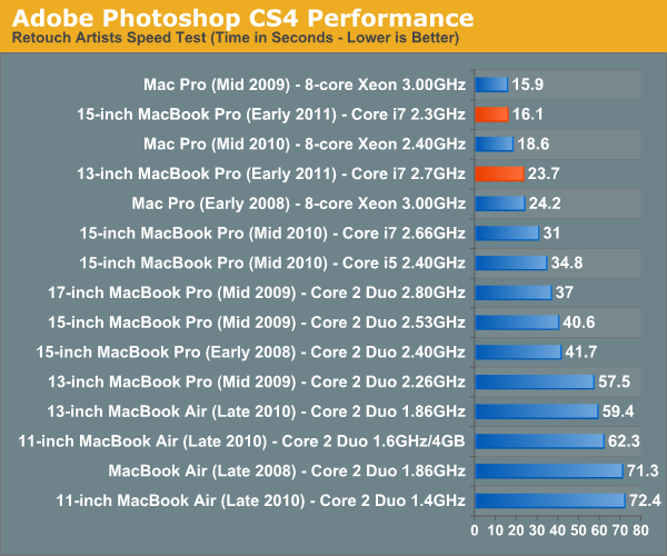

So hypothetically should SB hinder or benefit the performance on photoshop (and similar apps) over the current airs?
Since I believe, although I havn't tested this out for myself, but it sounds very plausible to me, that photoshop doesn't really utilize the GPU it should be either the same or better - and with that I mean, if it doesn't run fluently on the current MBA, it should do it on the SB, or at least better.
If anyone out there knows otherwise please do correct me.
Most Photoshop operations are CPU bound, so you'll see a nice benefit with the new SB processors.
