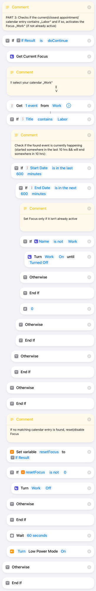

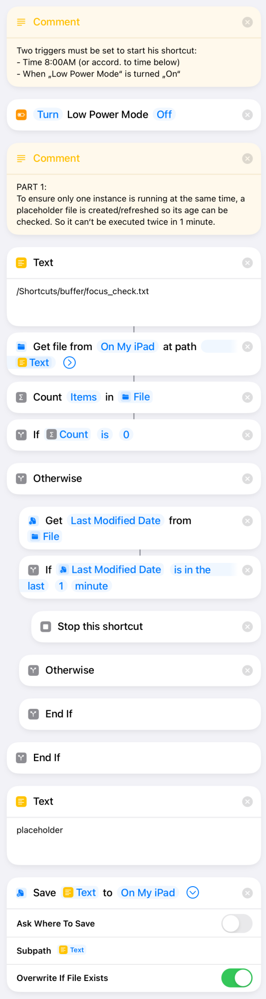

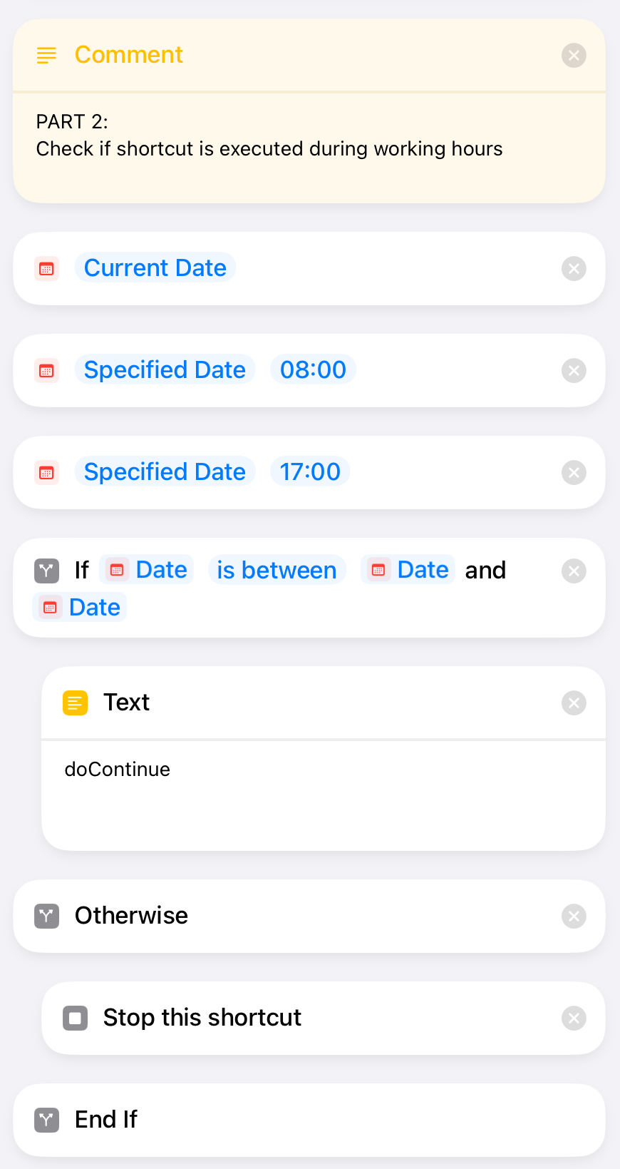

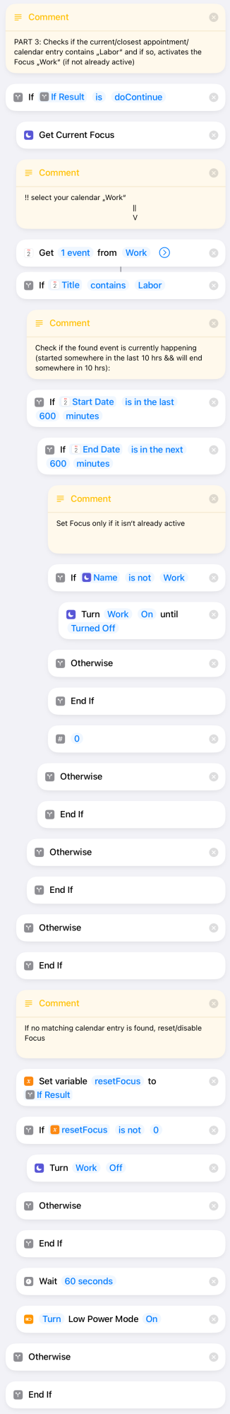

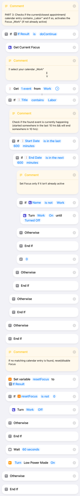

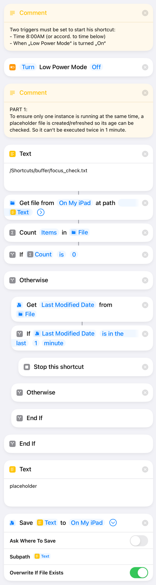

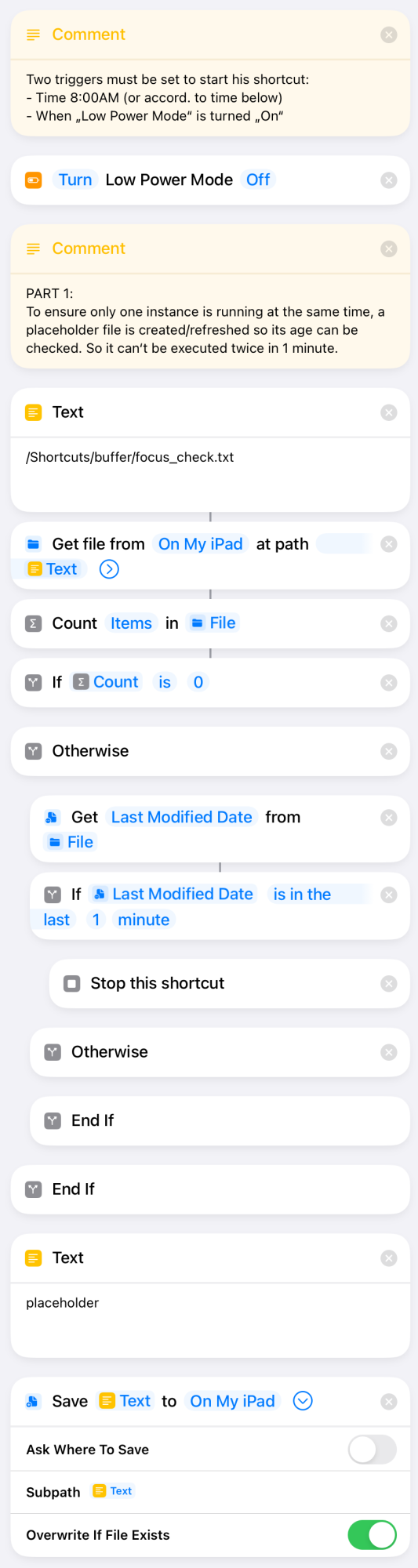

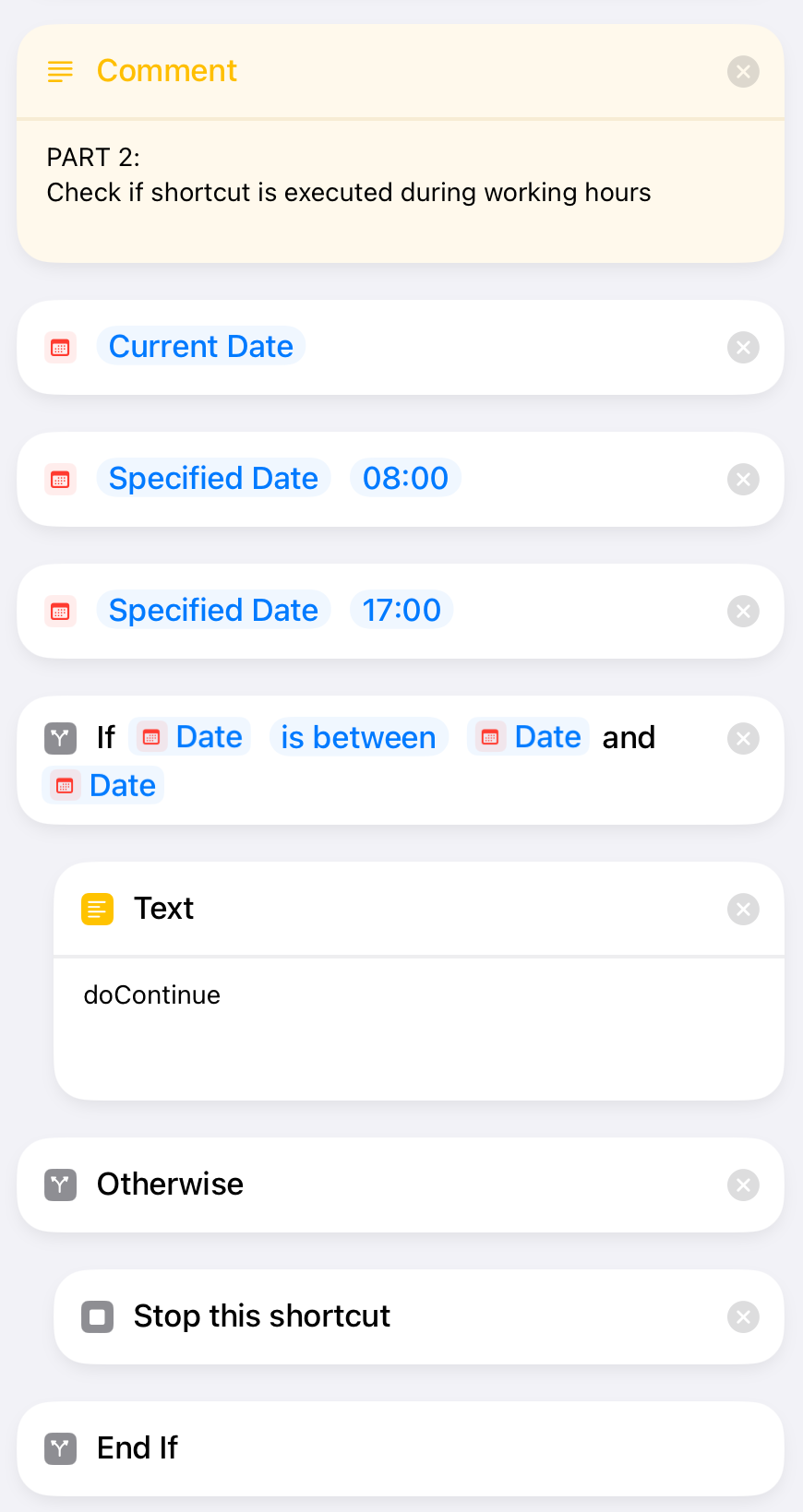

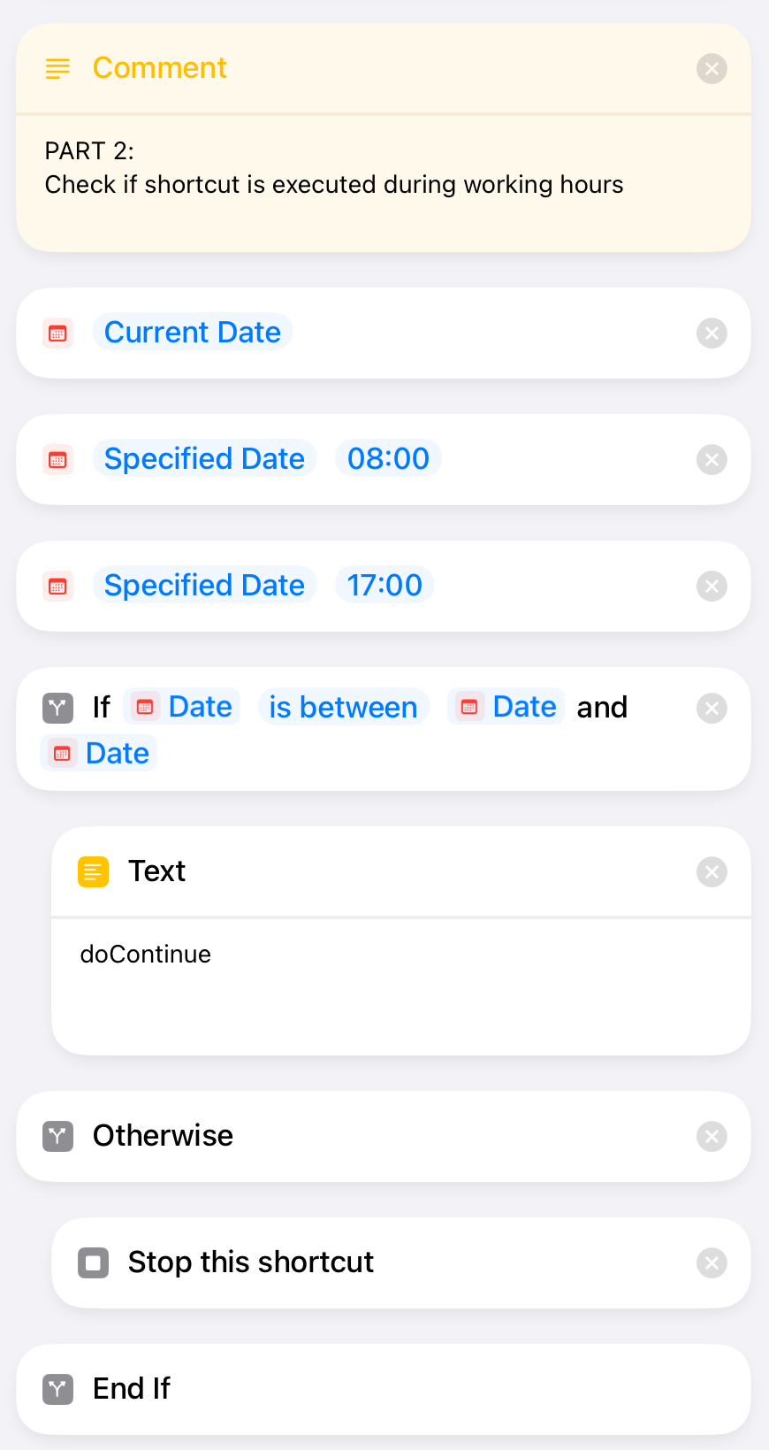

As mentioned by @NoBoMac, the problematic part is dealing with the timeout. So the following expects one does not actively need the "Low Power Mode" as it gets misused by the shortcut to re-trigger itself.
Prerequisites:
- The Shortcut gets initially triggered once by a fixed time at (08:00 AM), daily and runs for ~1 minute​
- The second trigger is Low Power Mode gets turned Off which the shortcut executes at the end of the run to re-trigger itself and results in a ~1 minute execution interval loop (Low Power Mode only stays active for <1 second)​
The Shortcut itself:
Part 1: Ensures only one instance of the shortcut is running at the same time​
Part 2: Checks if it runs during business hours (08:00 AM - 05:00 PM), otherwise the loop is stopped​
Part 3 (main):​
- If the current event of the calendar Work contains "Labor", the focus Work gets activated (if not already active)​
- If "Labor" is not found, the focus Work gets deactivated​
If you want it changed (longer interval) or a link, PM me. It could probably be improved vastly but I'm new to Shortcuts.
