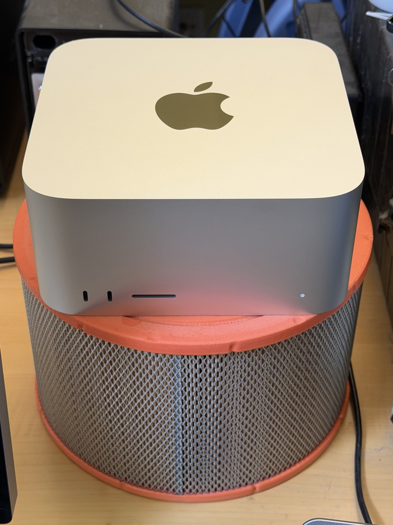

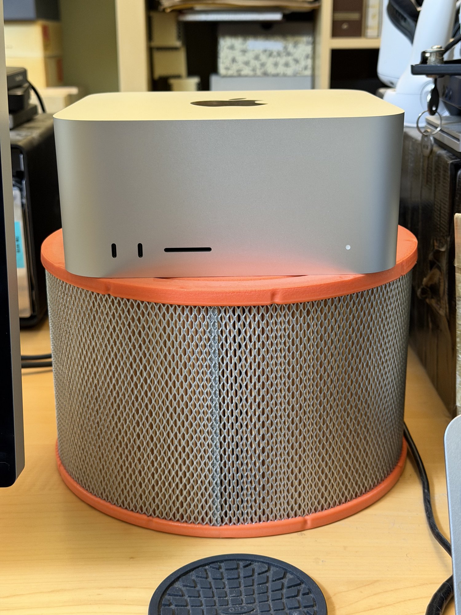

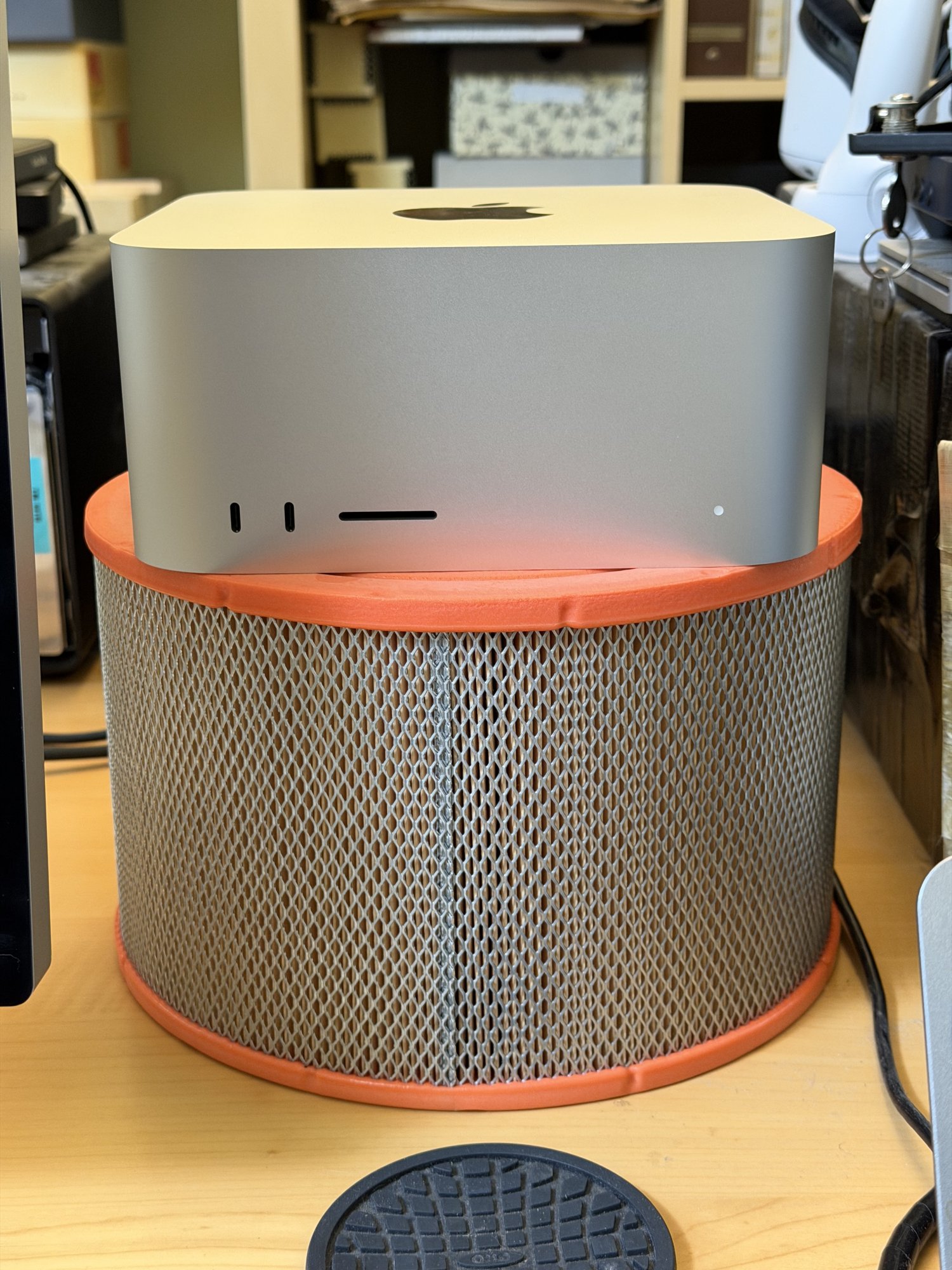

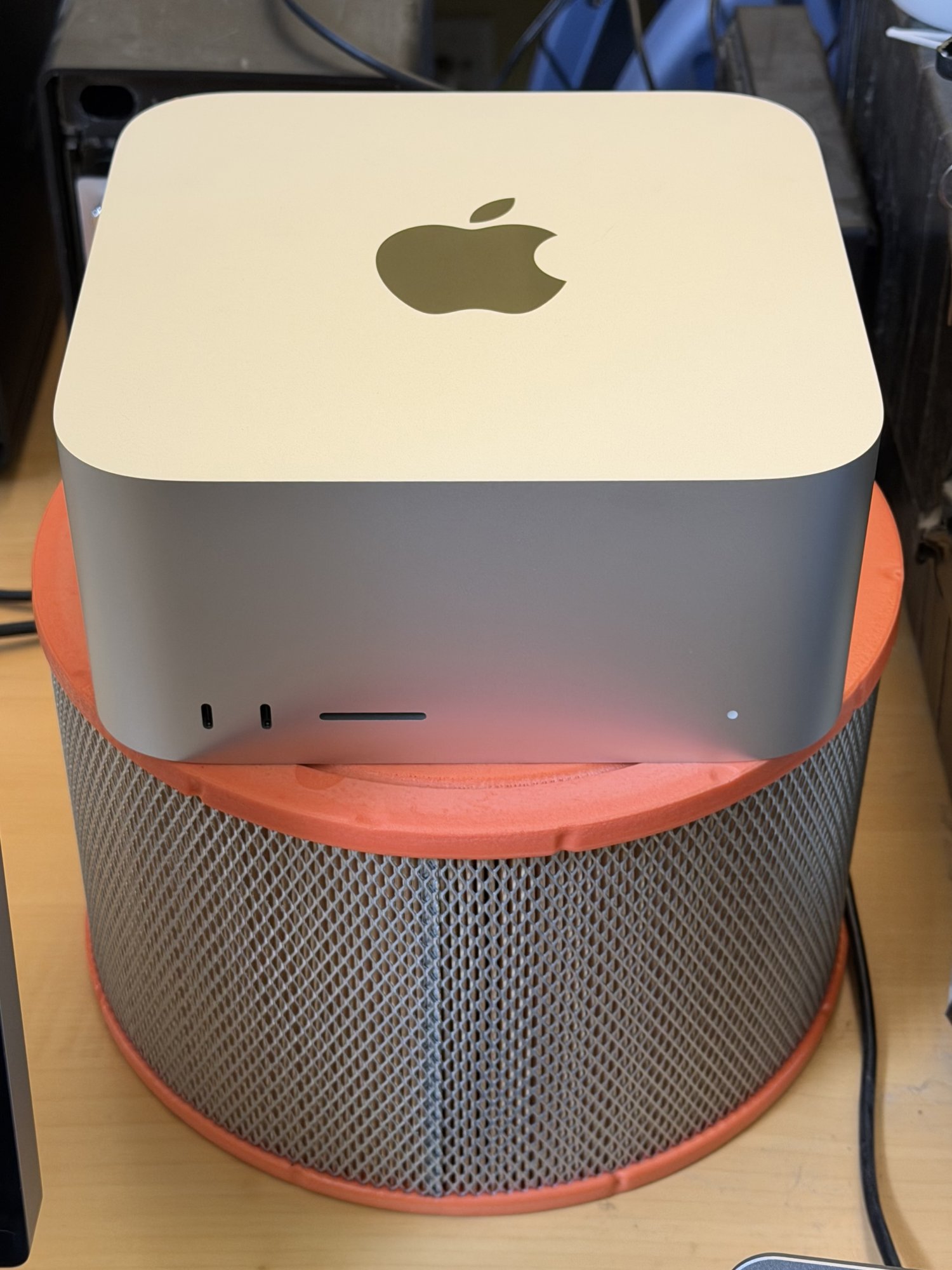

WIX 42788 air filter. I wanted a tall filter to maximize filter area and reduce resistance. Plus orange so it looks like a prop from Gerry Anderson's 1970's UFO series. In normal use there's no impact on temperature or fan speed, I need to do some performance tests.
Some people are more easily embarrassed than others I suppose? I only have a small concern that if Apple ever sees this they'll make me give it back.
There is nothing to be embarrassed about it. In fact, it should Apple being embarrassed for allowing a computer design that has the fresh air intake in close proximity with the shelf or desk's top it sits on...all done in an effort to reduce construction costs. The same can be said for not having a microphone port at the front of the Mac. It is left to the the consumer having to buy a stand, perhaps a USB microphone, and who knows what else 😇
Isn't the exhaust/heat through the back panel on the Mac Studio? Assuming good air flow, the bottom filter should not bother the exhaust at all.
What I would do is to monitor differences of cooling fan speeds, without placing the Studio on the filter versus placing it on the filter. If the differences in fan speeds aren't drastic, then I would not worry about. But in reality, automobile engine air filters are designed to resist air movement to a certain extend.

In normal use I see no difference in fan speed. I do have similar concerns about the filter material which is why I went with the largest possible filter area for less resistance. And I need to test it under more demanding conditions. I'd much rather be using something more like furnace filter material. This just happened to come in a convenient shape!
Same with me but I have my filter stand on 1/3rd inch risers to allow more airflow going into the filter.

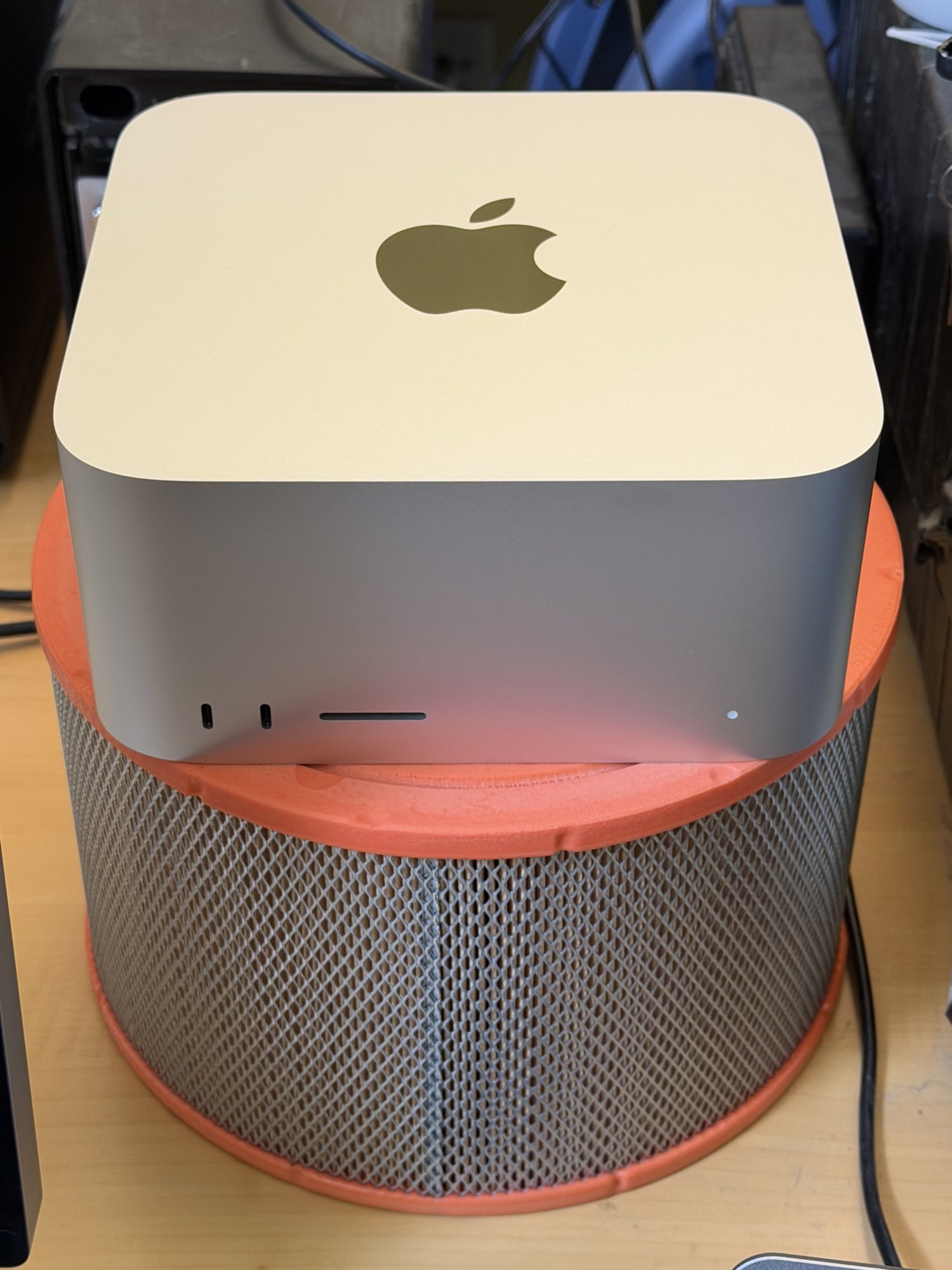

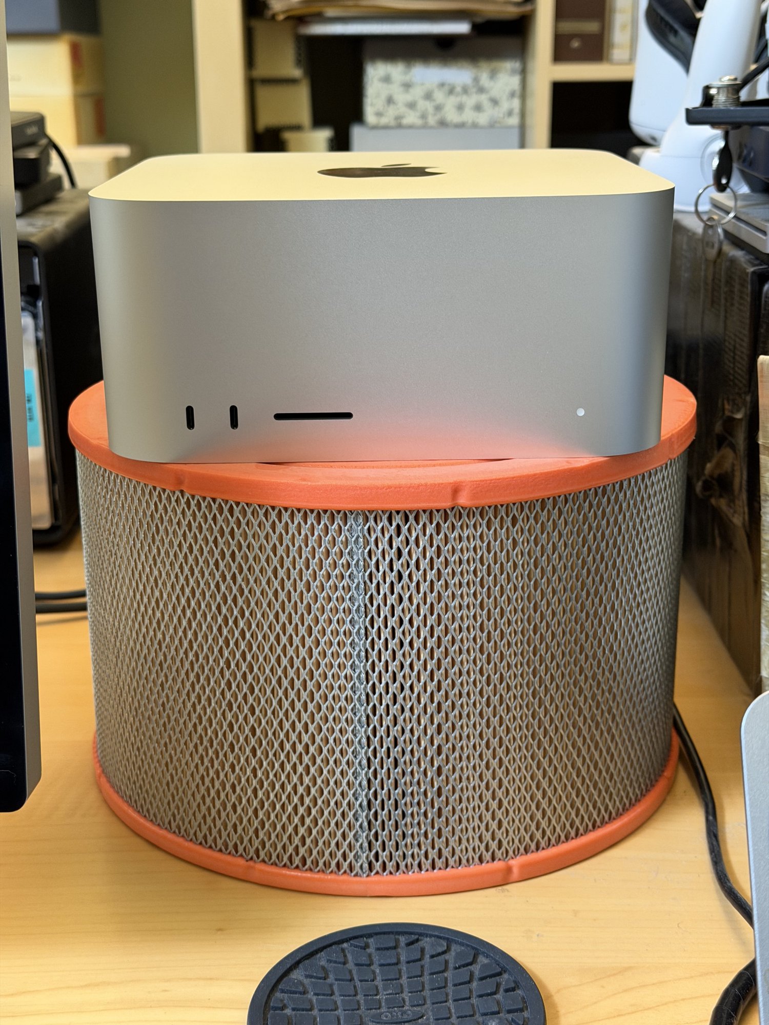

View attachment 2573914View attachment 2573915
that's one "IDGAF HOW IT LOOKS JUST KEEP MY MAC HEALTHY AND CLEAN" and I love it 🙂 your Mac sure loves you for it... I put mine on a stand for now, so it's up on the air .. which helps A BIT, I would say about 30-40% than keeping it straight on the desk. But with a filter like that 95% of the dust is kept away im sure heh

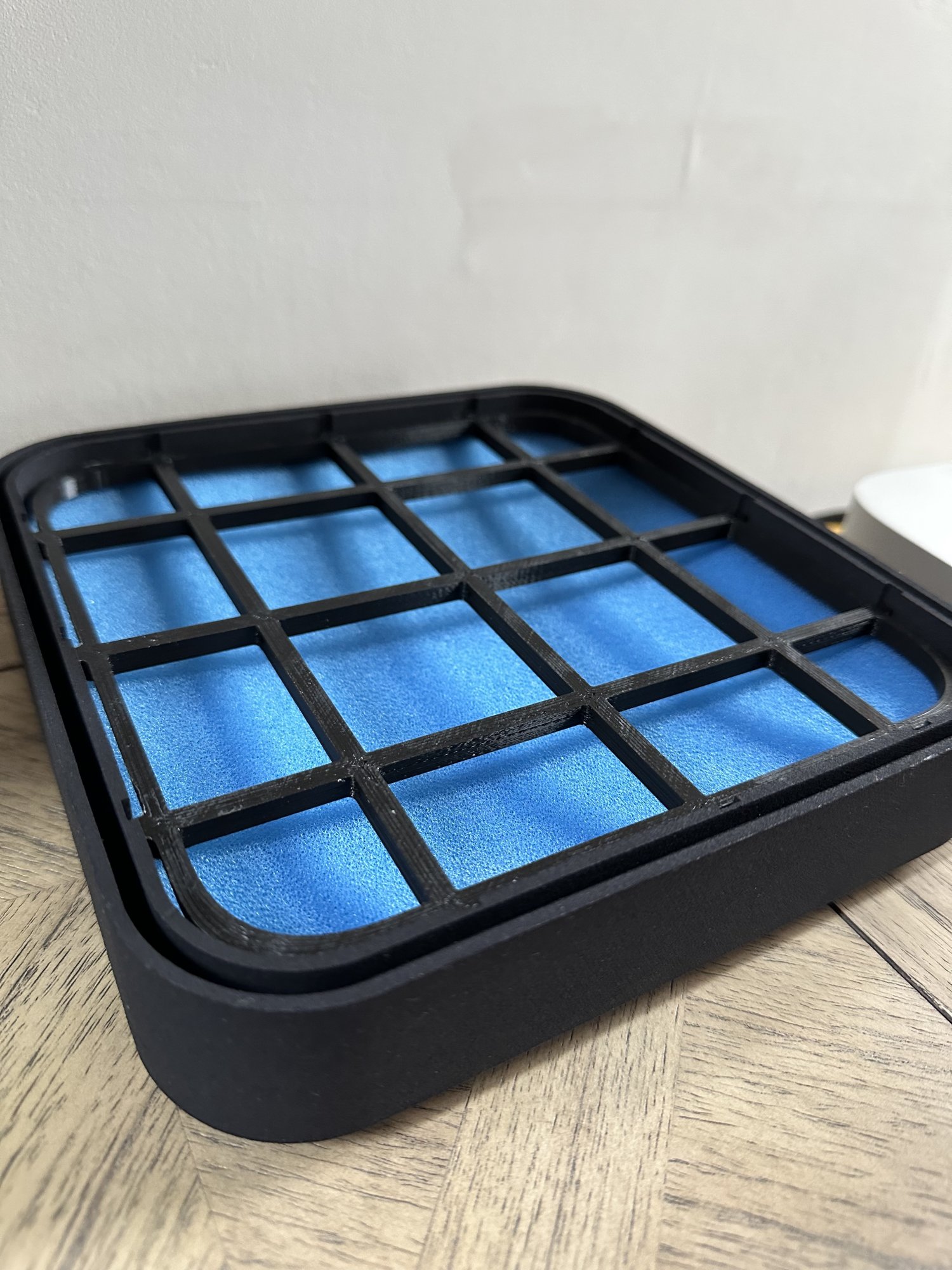

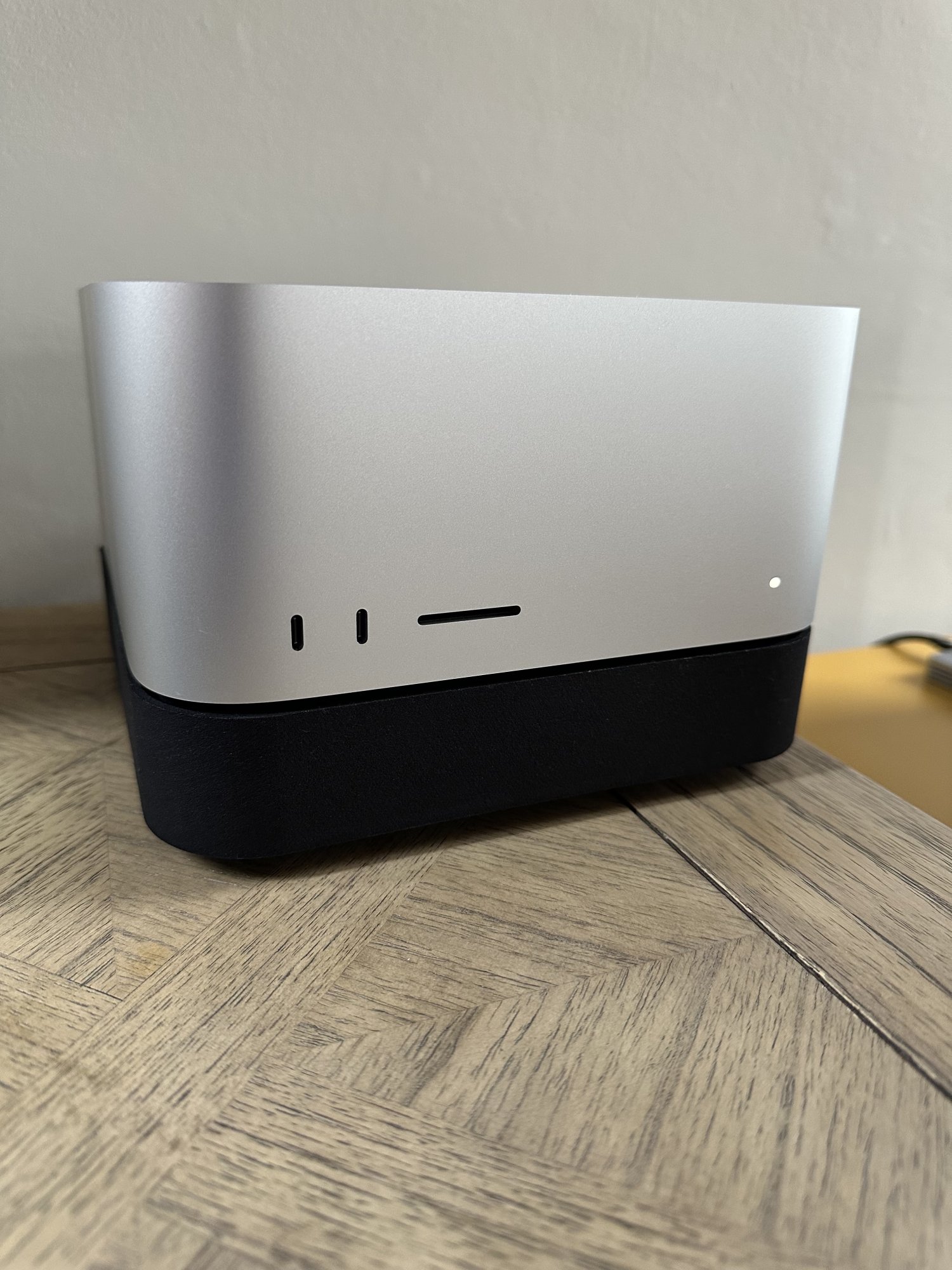

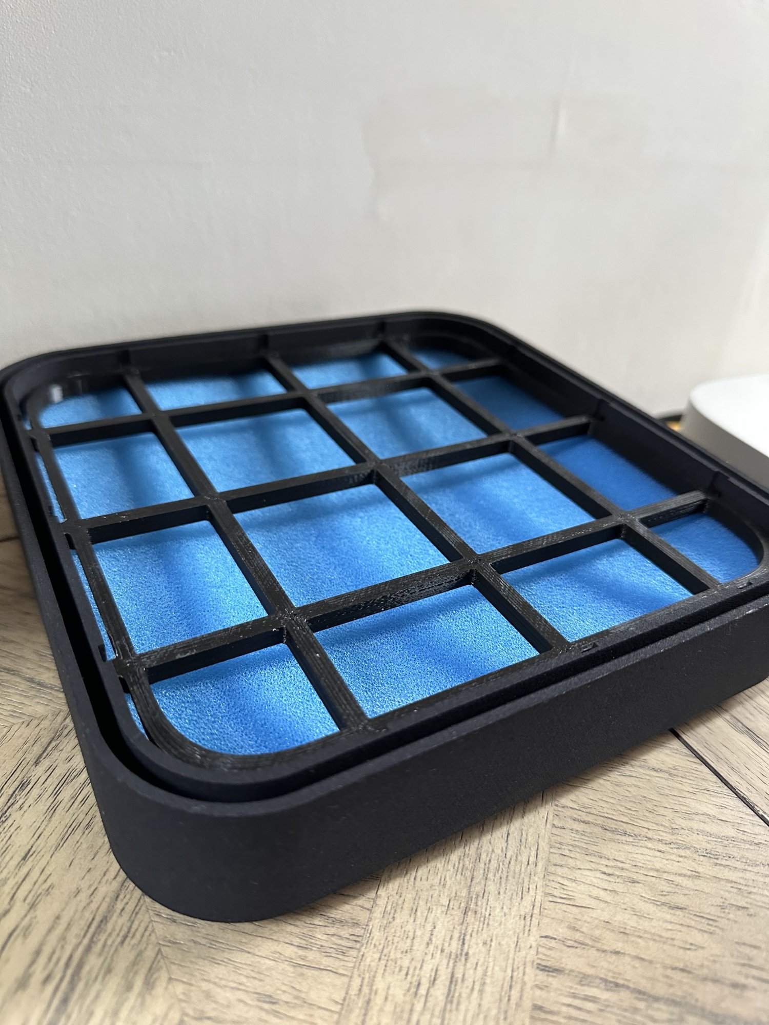

This is where I've landed. I initially jumped onto the Spiegen stand, which was fine. I opted to fill it, imperfectly, with some 45PPI reticulated foam filter. A ~2°C degrees increase on temps under a normal workload within a 20/22°C ambient temperature.

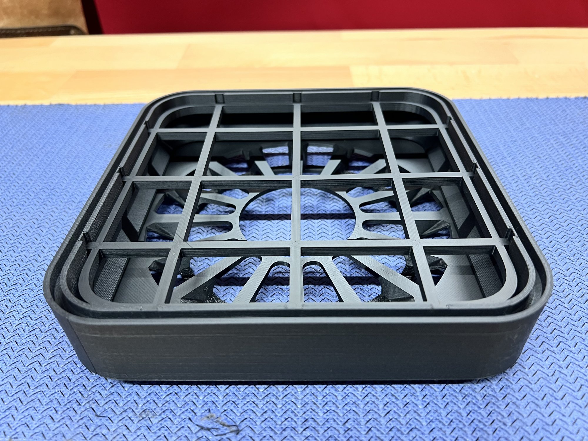

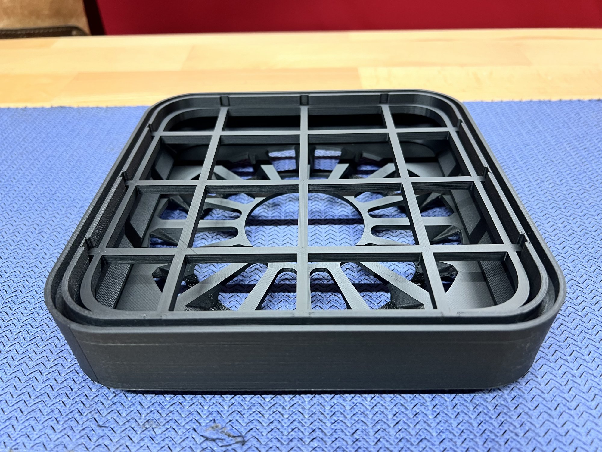

I came across the 3D print model, I liked the approach and without knowing anything about 3D printing, I thought why not.
I opted for the internal pieces to be printed PLA via FMD and the external housing dyed black nylon PA12 via MFJ, for a better finish quality, but at a higher cost.

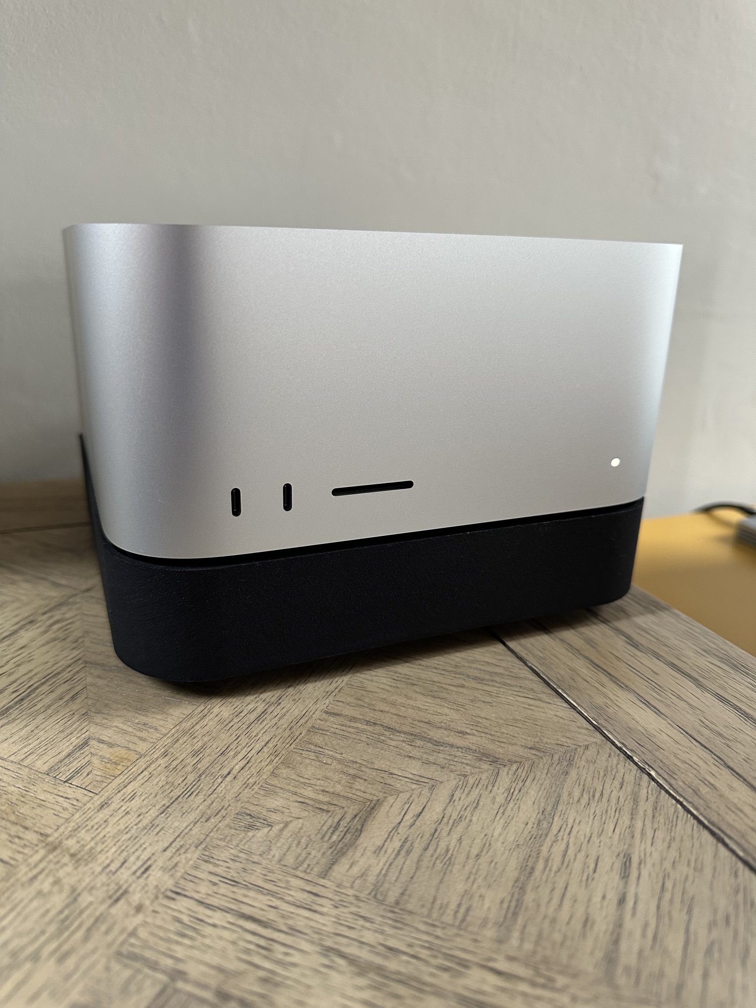

I've just sourced a silicone sealing strip to fit around the case and create a more air tight seal, to finish it off.
