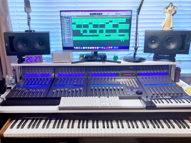

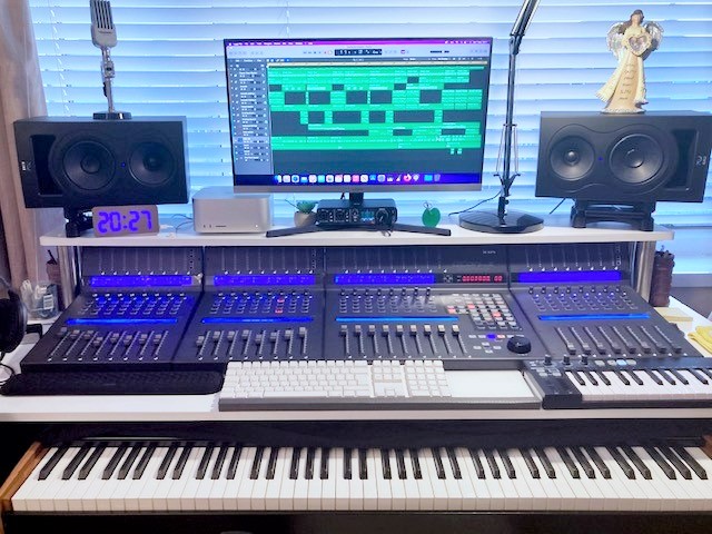

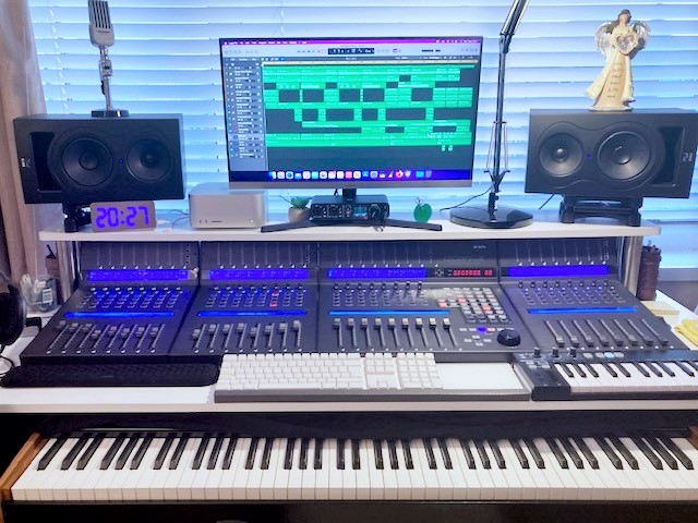

I turn mine upside down once a week and vacuum the inlets with a cordless vacuum. Same method I use to vacuum my control surfaces, my A1048 keyboard, and my midi controllers. Probably this vacuuming is doing literally nothing but in my mind it's helping.
Not to derail the thread, but how do you like those IN-8s? I just got a pair of LP-8s after one of my KRK's went haywire and I'm utterly in love.
Love them. I opted for the IN-5s because the room is just not big enough for the IN-8's. Couldn't be happier.

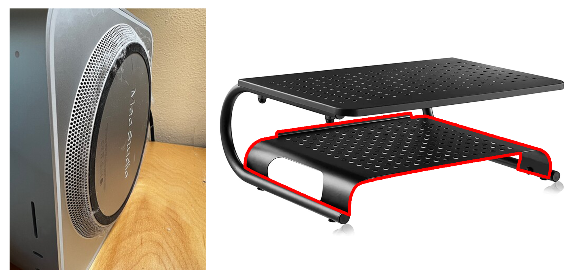

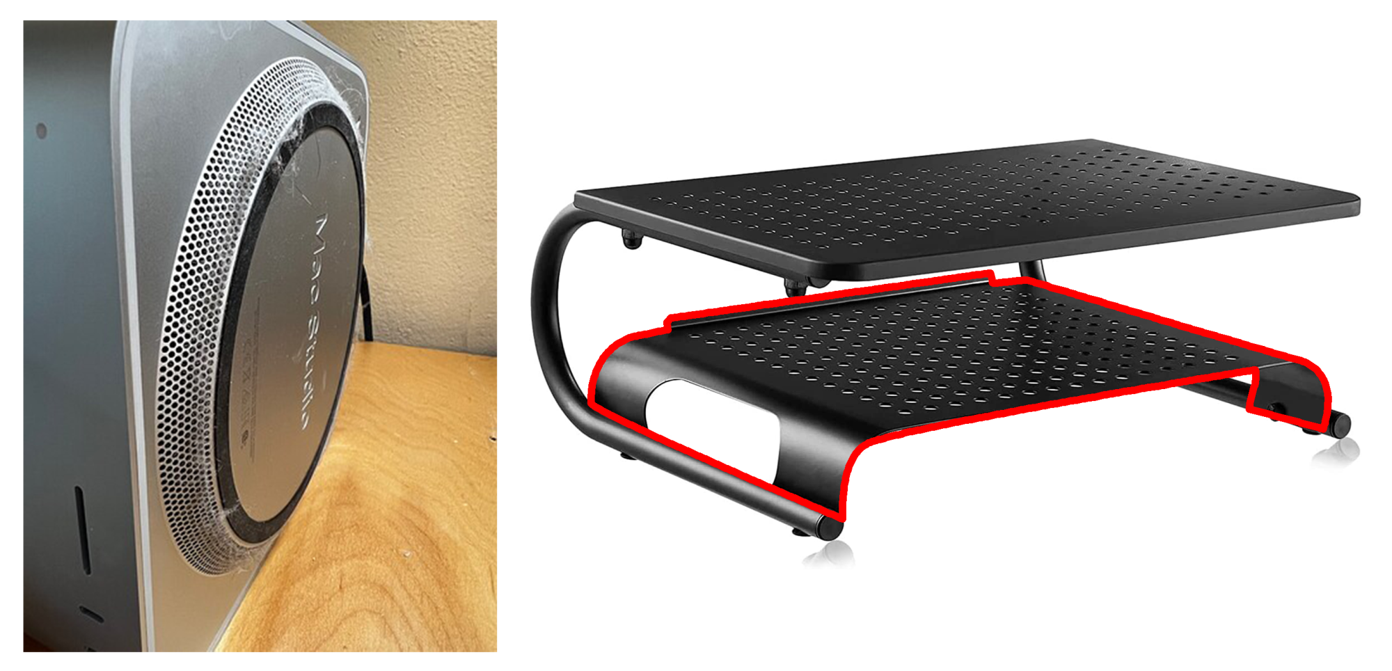

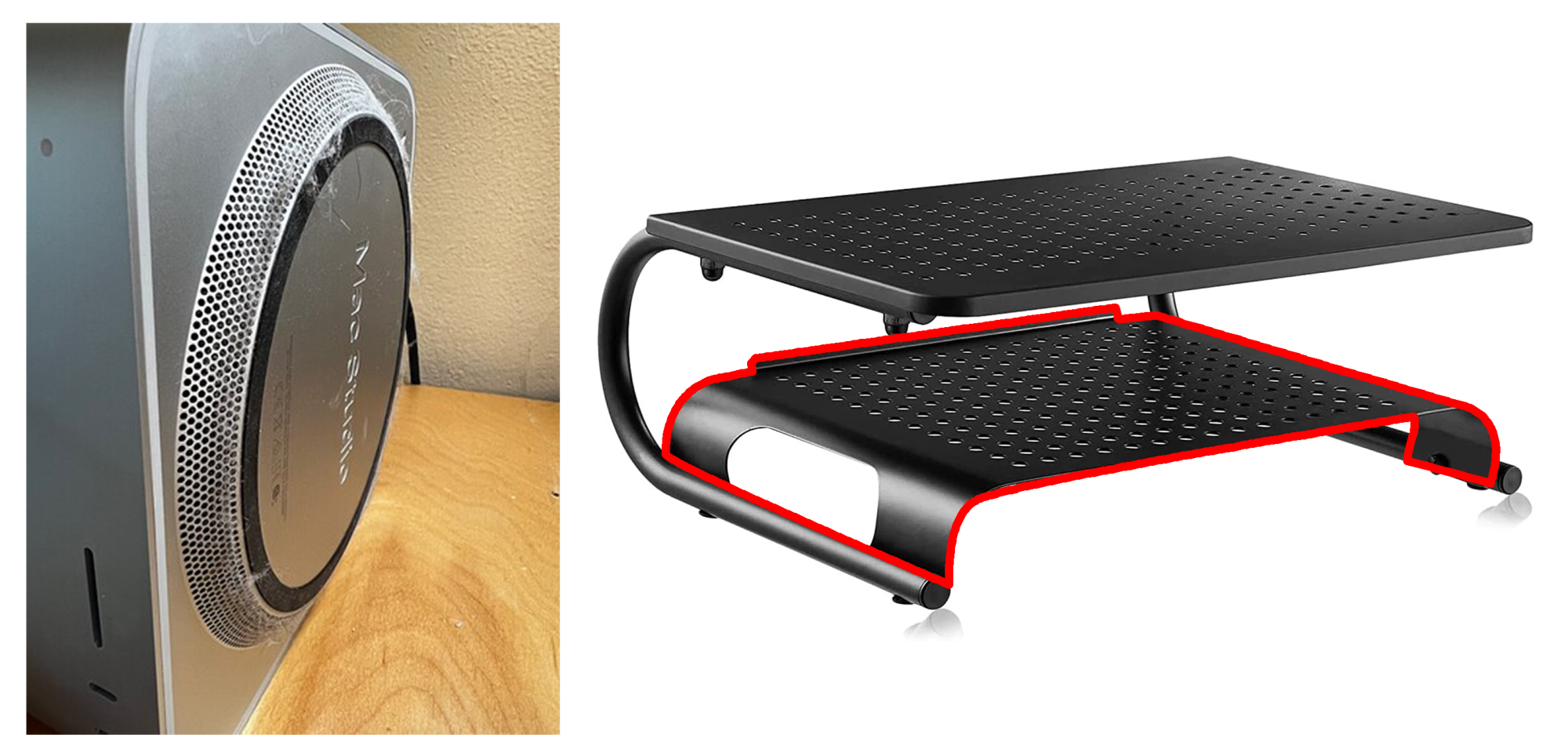

I have seen the dust issue first hand on a display model at an Apple Store and some horrific photos and posts about the Mac Studio and it's attraction to draw in dust, I have invested in a 'monitor riser' to help combat the dust issue and the area of the riser highlighted in red is what I envisage to lift it from the surface of the desk to hopefully combat this issue.
Other than under desk mounting (and vaccuming!) - which I am not inclined to pursue - does anyone else have any ideas to slow down the intake of dust? Or are we stuck with it?!

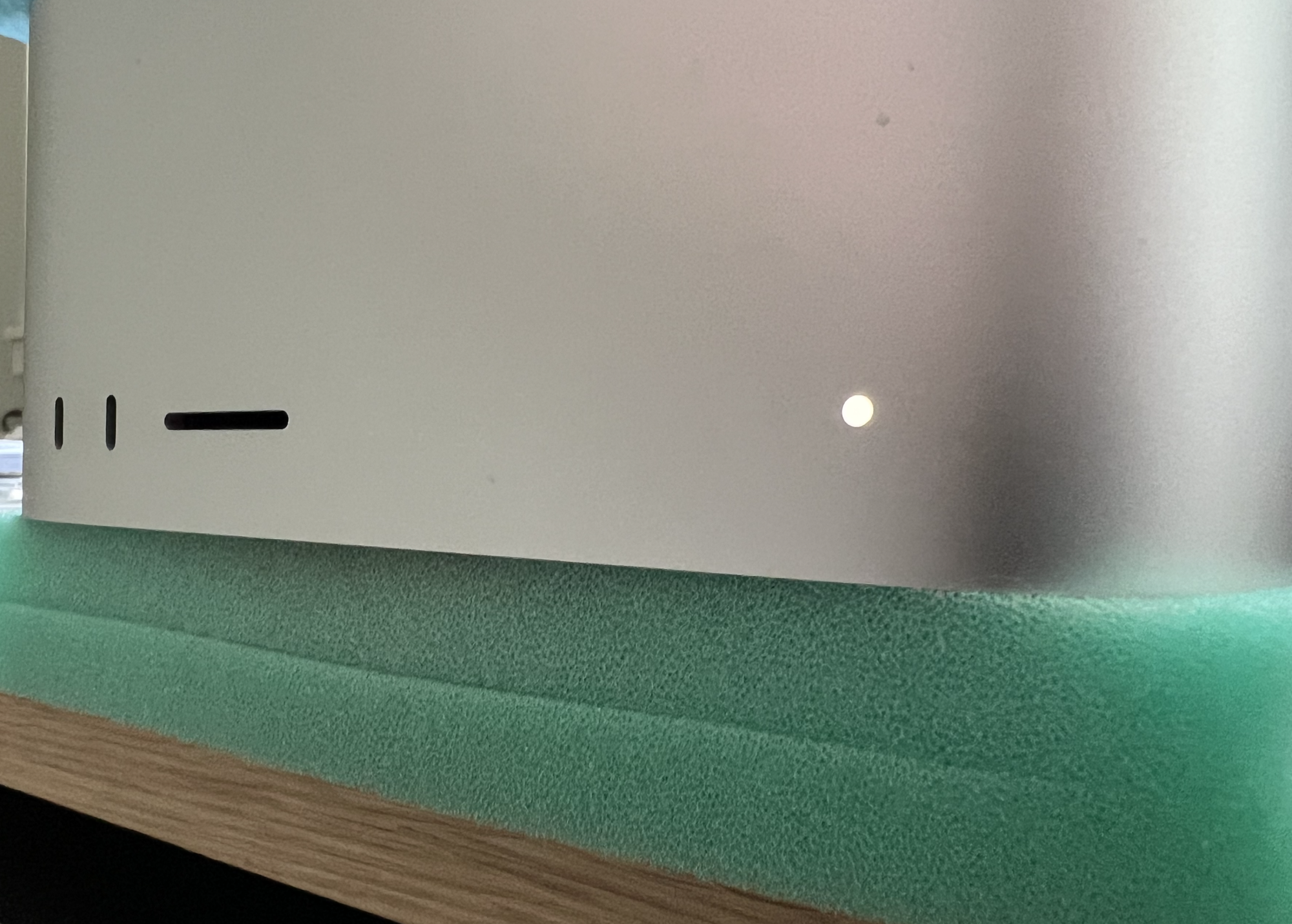

Apple Mac Studio Air Filter

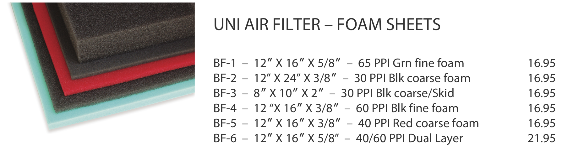

Most foam used for packing material is "open cell" which means that air can pass through it. You can test that it doesn't offer resistance to air flow by simply blowing air through it.
Most motorsport air filter manufacturers like UNI sell sheets of it — their BF-1 offers the smallest cell size and therefore the best filtration.
Cut to size and place the foam under the Mac Studio as a base — its weight will compress the foam enough to cover the air inlet holes if the foam is over 1/2-inch thick. Air now needs to flow though the foam to reach the Studio air inlets.
In my experience, there's not an enough air flow restriction to raise the internal Studio temperatures a measurable amount at idle fan speeds. I'll do a another temperature check if I can ever get the M1Max to run at higher fan speeds.
Clean with compressed air and reuse.

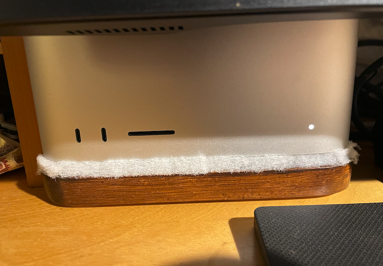

I made a wooden platform, and put narrow strips of air filter material around it. Used 2-sided tape for the filters, easy to replace when needed. The wooden base protects if I would manage to spill coffee etc. Monitoring the temps now, but seems there in no increase, so all is fine. I ordered some black 5mm thick computer filter material. Will swap that when it some day will arrive.
Reactions: b17777
How does that work?

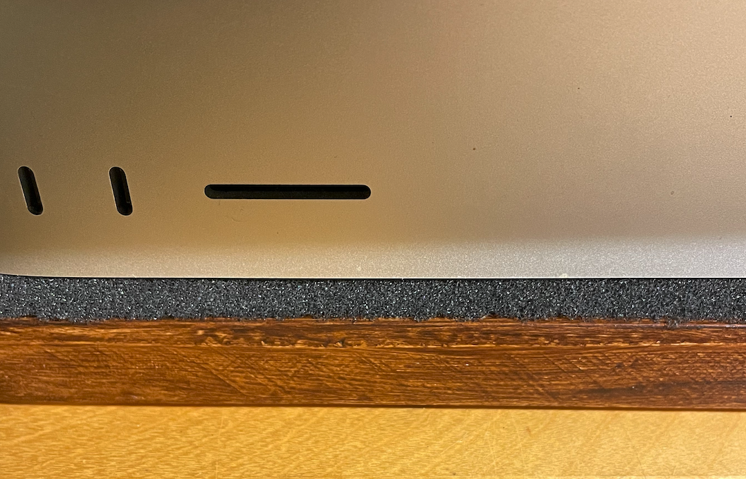

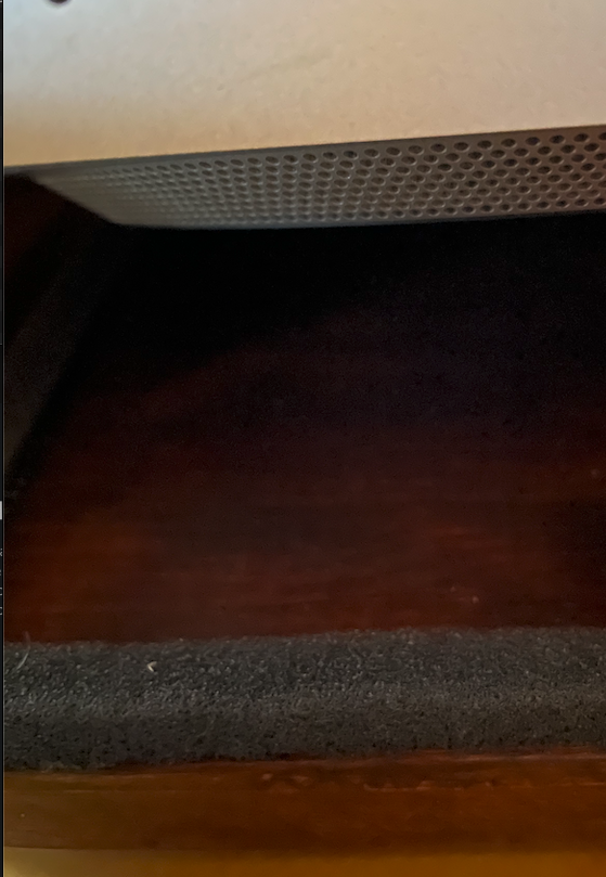

It works fine. Studios temps are the same with the filter than without one. I cutted around 1 cm wide strips from that material. Used 2-sided tape to get them in place around the wooden base. Think you can use that filter material without a base, just cut a long strip with suitable thickness and wrap it around the Studios base.
I highly recommend using thicker filter material to assure a larger filtered flow area all around and from below. As the filter material collects dust, the resistance to air flow will increase causing temperatures to rise — so more filter material will extend the cleaning interval. It will also offers less flow resistance as the fans speed up to handle higher internal temperatures.
Shown are two layers of UNI Filter BF-1 material often used to protect motorsport engines.

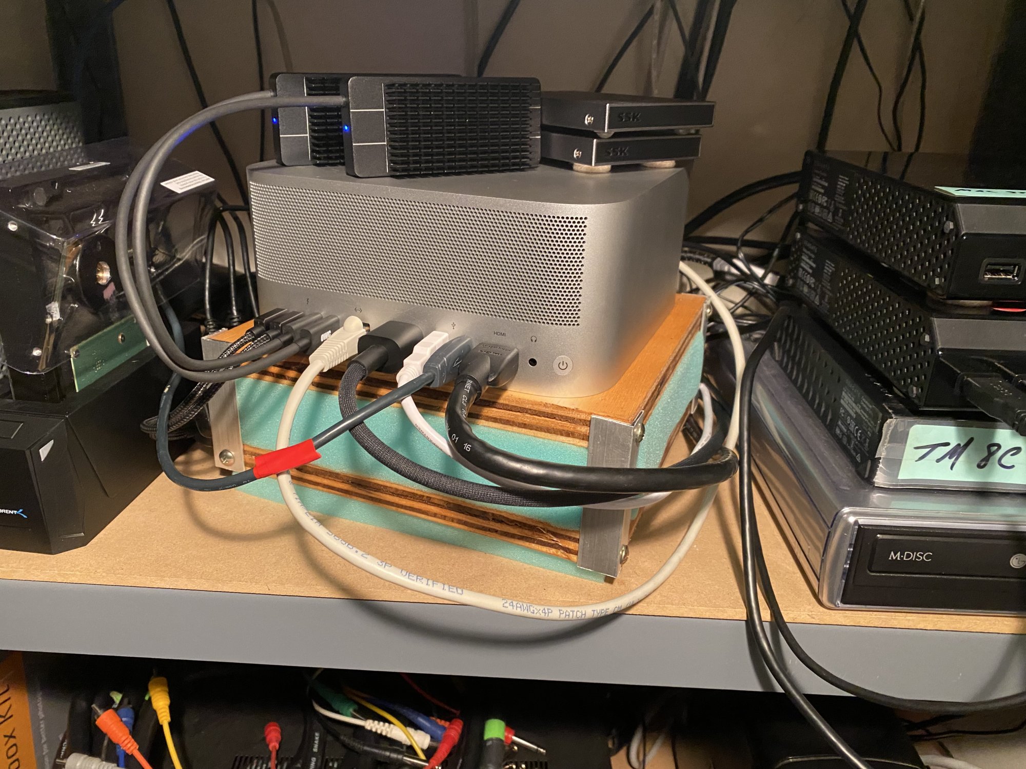

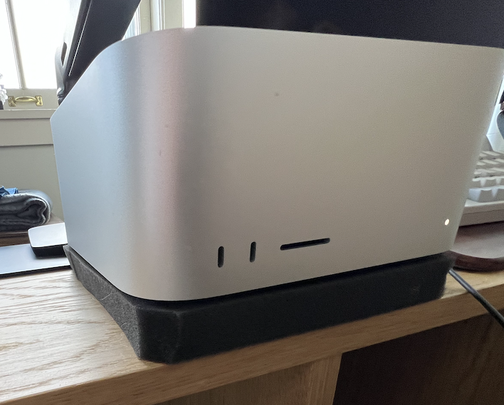

A Thing of Beauty? No. But my Mac Studio sits in a machine closet, and this home-built filter should keep its internals protected while still allowing good airflow. I've noticed no increase in fans speed or temp since putting the filter in service.
