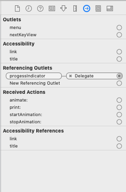

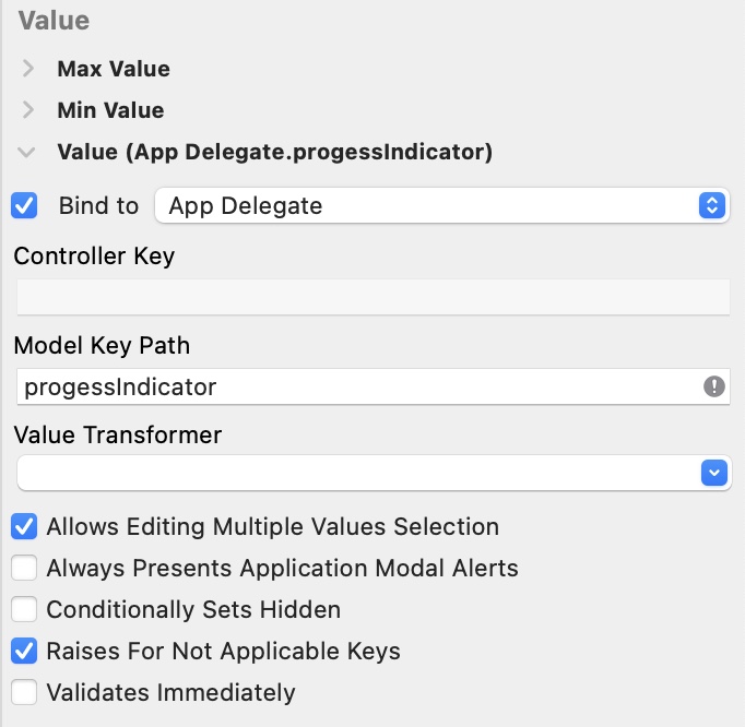

Hi Mark,
I copied and pasted that into a new project.
I have added a progress bar on to the UI and then in the Bindings I have bound the value to App Deligate and set the Model Key Path to progessIndicator. Is this correct ?
When I run the app, I am getting an error popup in the console saying
2022-07-09 21:09:06.335233+0100 TEST-13.0[21855:402591] ***
-[AppDelegate applicationDidBecomeActive:]:
Can’t set usesThreadedAnimation of missing value to true. (error -10006)
Ian

No do not use the 'Value : Model Key Path', but use 'Referencing Outlets : New Referencing Outlet', and drag from the little round circle to the Blue AppDelegate Cube Class Object, then select 'progessIndicator' from the list of two properties.
You can also do the same thing by clicking the Progress Indicator object on the window, and right clicking it to reveal the connection panel, or right clicking the Blue AppDelegate Cube Class object instead.
But my understanding is that there are bugs in Xcode 13 as regards connecting UI elements to Script properties.
There are very few resources for AppleScriptObjC Xcode projects on the interweb, but you'll find more help on the subject over at the Macscripter forums, where I occasionally hang out myself, and help out with AppleScriptObjC code solutions.
But in all honesty you are better off learning Swift instead these days, as Apple stopped support and updates for AppleScript a few years ago, and have even removed the New AppleScript project template form Xcode 14.
Regards Mark
Instead of a binding, you need to use an outlet (via the Connections Inspector) so that you can refer to the object. A binding is a two-way connection between a property and an element (such as the value of a progress indicator), while an outlet is a reference to an object (the indicator itself). An outlet is used when specifying the receiver for methods (the progress indicator’s usesThreadedAnimation method, for example).
When using the Script Editor, you lose a lot of the help that Xcode provides, so it becomes a bit more noisy since you have to define everything yourself. For example, a simple handler to just create the progress bar is about 20 lines, but something more involved such as a complete working sample progress indicator controller with descriptive text fields and a cancel button is around 220 lines.
As for tutorials, there isn’t much for AppleScriptObjC (even from Apple), the expectation is to just translate an Objective-C project. An example project that does not use Xcode would be something like:
