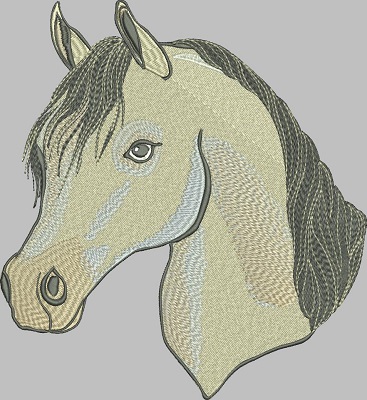

He sent it to someone to digitize it for $10. Probably crappy work from India or China. I use Wilcom Embroidery Studio for my digitizing. I've been doing it for 25+ years.
Reactions: Teri Young
If there is any interest, I'll put together a YouTube video of me digitizing something. It's very similar to working with Illustrator or even a 3D program like Sketchup. You do need to have a good understanding of embroidery though.

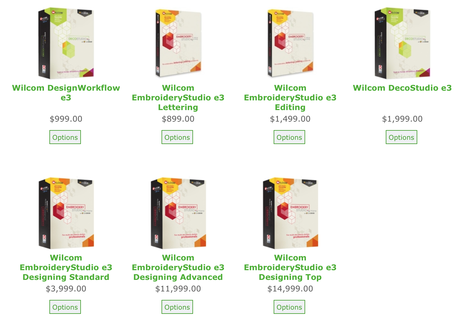

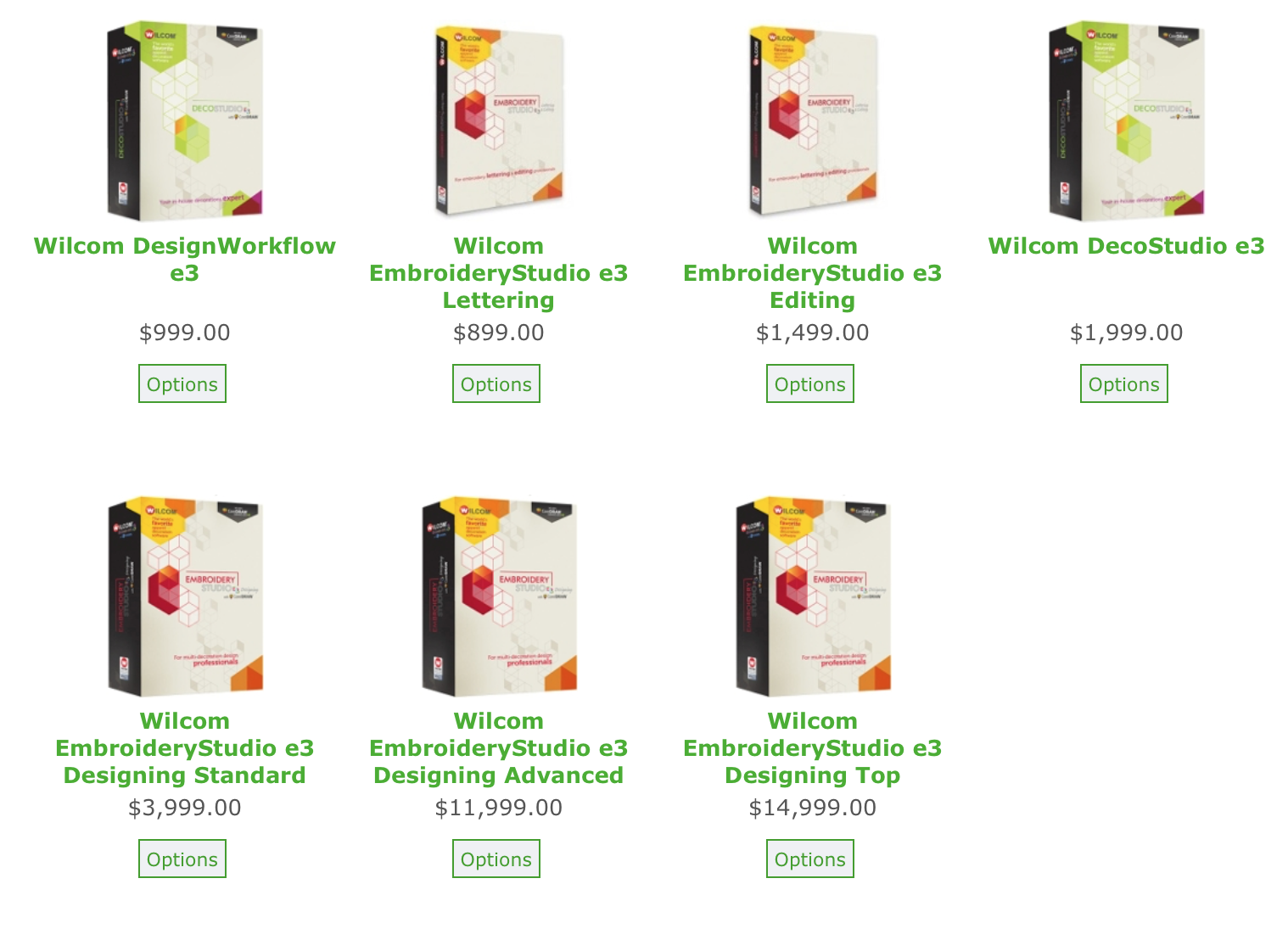

Yikes. Those prices!
No wonder the digitization fees are steep.
Yep digitizing software is very industry specific, thus the cost. I paid in the neighborhood of $20,000 for my software back when I first started. The prices have actually come down.
