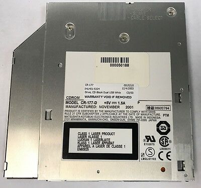

This is what you need:-
Hey! When I received the drive, it was some sort of "slim" interface, not an ATA 50pin interface! What're you trying to pull here?
