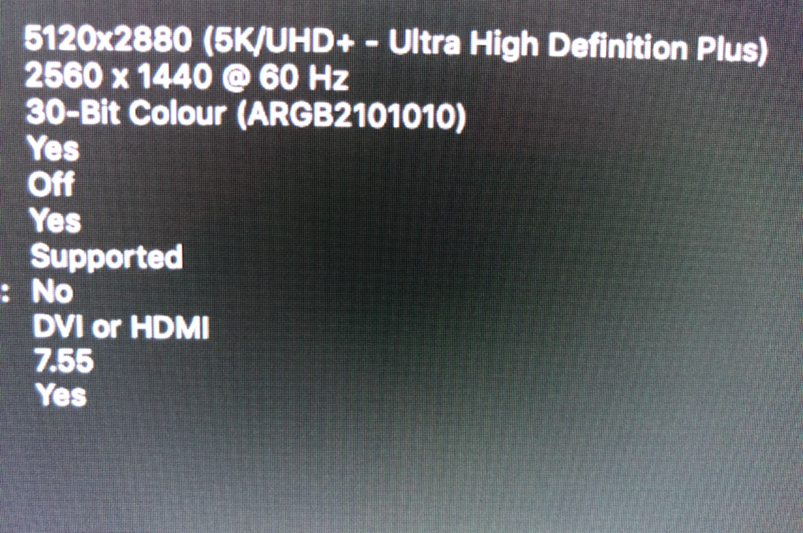

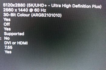

I can even drive a 5K display at 60hz and 10 bit color. Here is my system profile whole I am watching a HDR movie right now in glorious high color.
Your screenshot shows that you’re driving 2560x1440 10-bit. That's only 3.7 MP, so it's easy to get 10 or 12-bit color RGB at that speed. . A 4K display is 8 MP. But there is no HDMI product available today which can exceed 17.82 Gb/s.

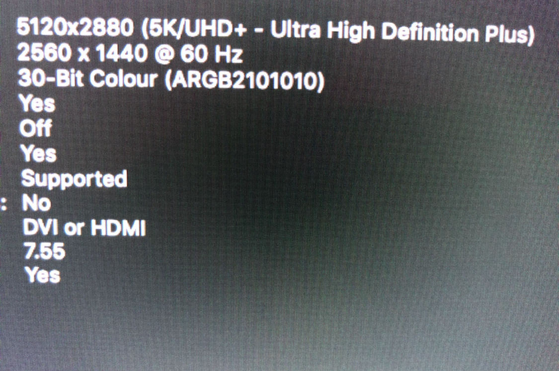

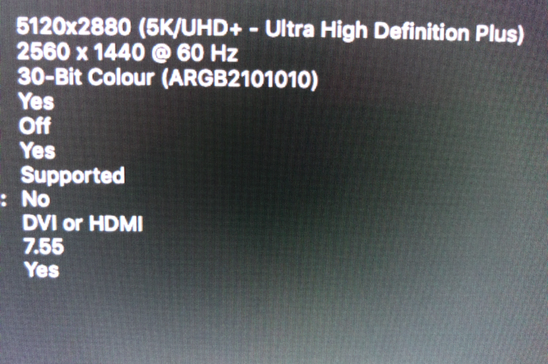

Here, you can 'verify' it yourself.
2560x1440 is the UI scaling, not the display resolution. At least understand how macOS interface works.

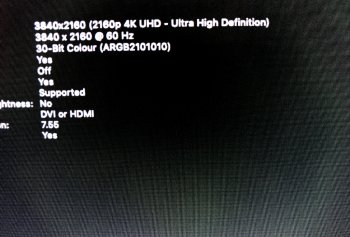

Here’s my 4K monitor with the UI set to native resolution, 60Hz, 10 bit color, over HDMI adapter.
Now you can stop being ridiculous. It’s really annoying when someone is uneducated on a subject and refuses to learn. You just misinform people because you are misinformed.
He probably won’t listen still. He didn’t know the difference between UI scaling settings and screen resolution. It’s like he missed the last 17 years of macOS progression towards these goals. He could have done a 3 second search and read Apple’s support document for this subject.

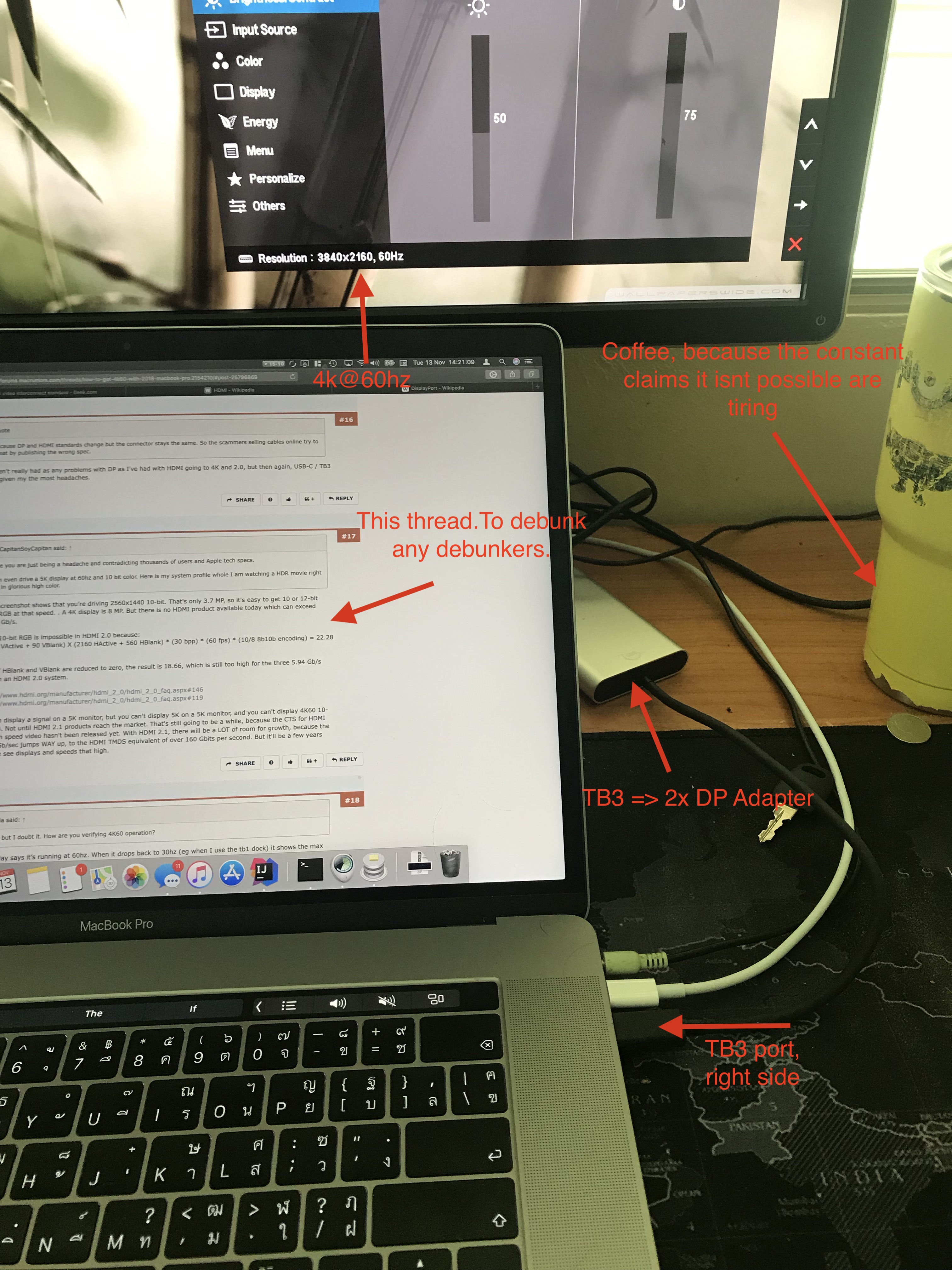

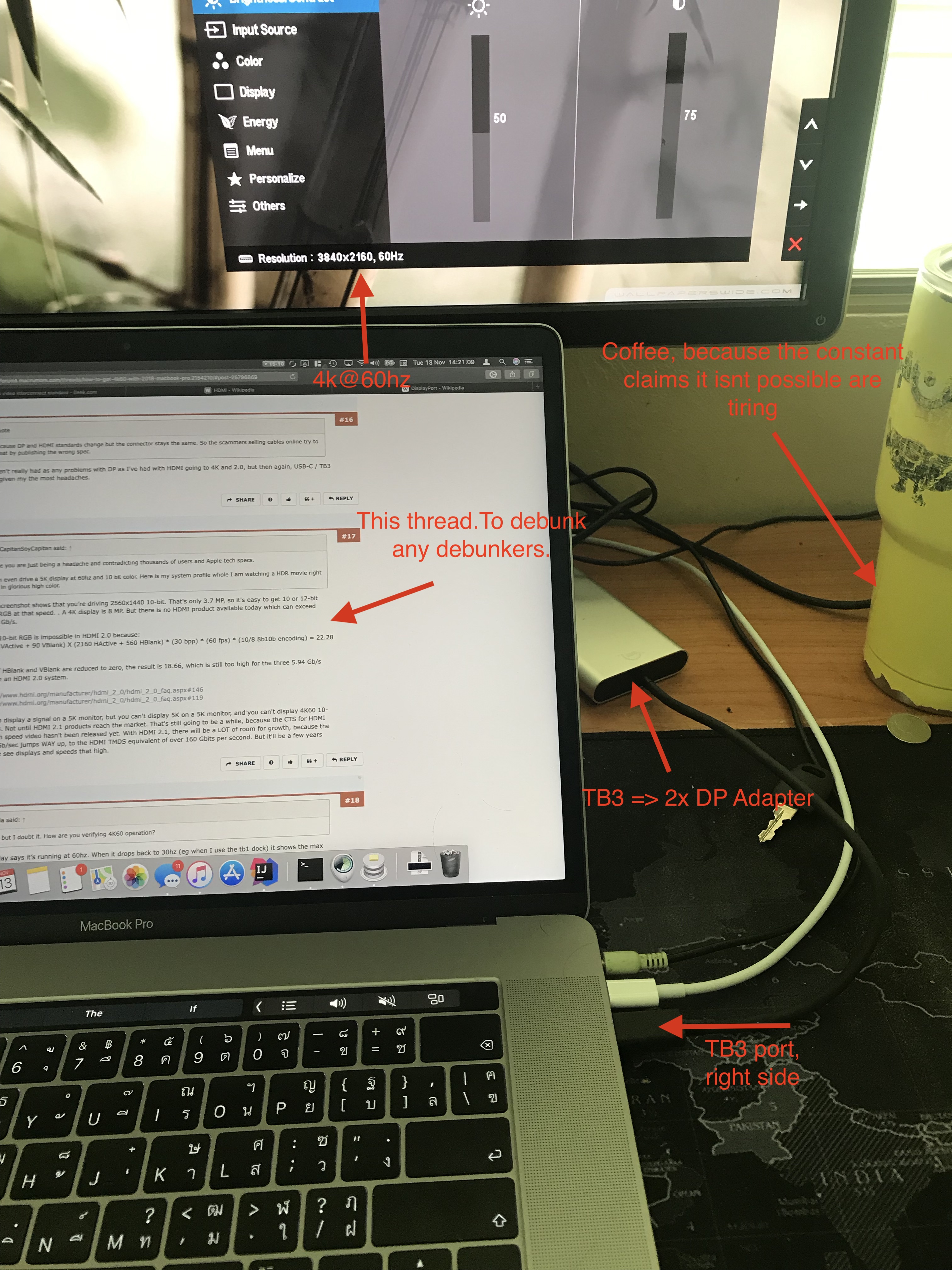

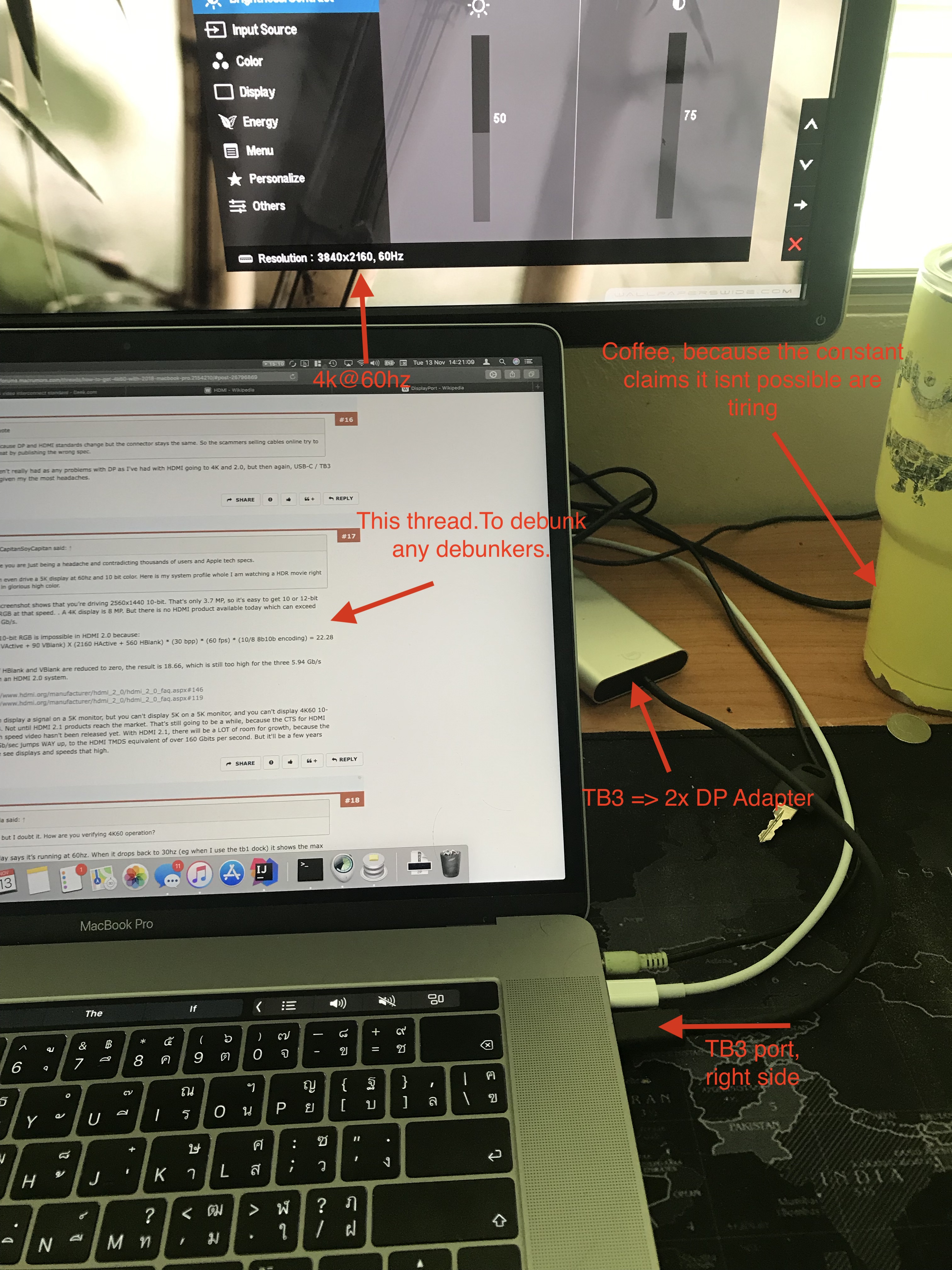

Well explain how other people including myself can get 4k60 to work on any of the ports without any configuration at all?
Do we secretly have the 2019 model?
Maybe you have the 15” model and it’s different from the 13”

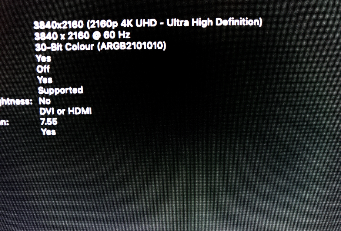

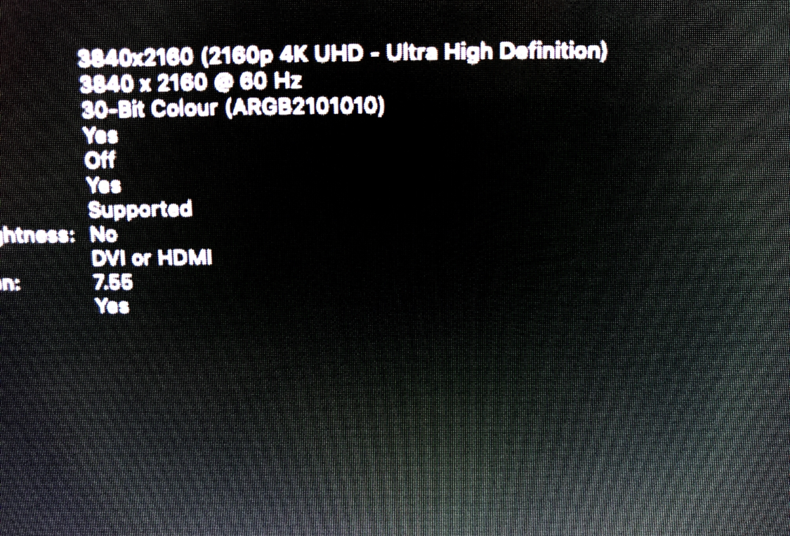

And here’s me telling you it isn’t possible. Either it’s sending 8-bit color or 4:2:2, but HDMI can’t send 10-bit RGB at that resolution:
http://community.cedia.net/blogs/david-meyer/2017/06/22/4k-60-444-hdr
