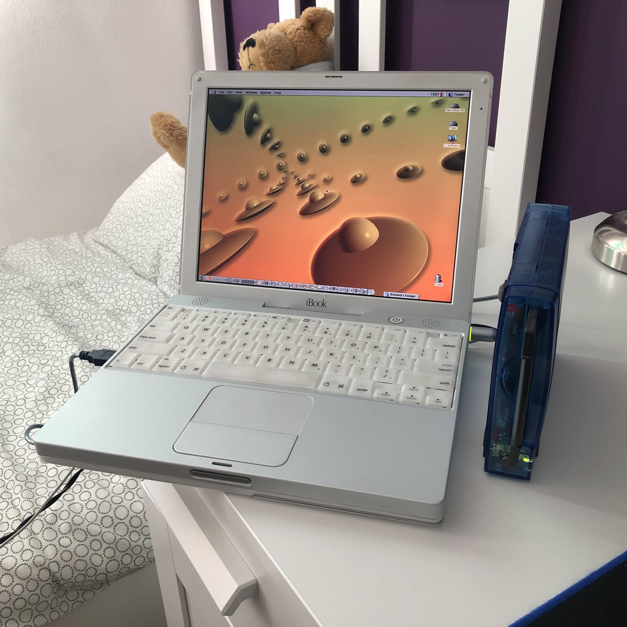

Sorry to the OP as this isn't really helping, but here's the latest edition to the family.
