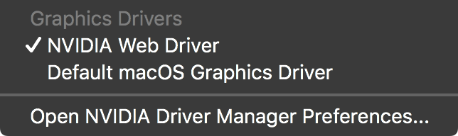

Ah, I see. Sorry for my poor English.
In that case, it's easy.
For initial installation.
1) Download and install Nvidia web driver. Be careful each OS build number has it's own web driver version. If in doubt, go to check the sticky thread. But if you download the wrong driver. It won't install anyway, nothing will hurt.
2) After web driver install, restart, and check if web driver is selected from the menu bar icon.
3) shut down
4) swap in the Nvidia graphic card
5) boot the computer. It should work like any other non flashed card now, the screen will be displayed once driver is loaded.

17) You should see there are 2 Nvidia logo on the menu bar
18) One of them should be selectable, and shows that you are with the web driver.
19) Select Apple driver, and then select web driver again (in other words, recycle it).
