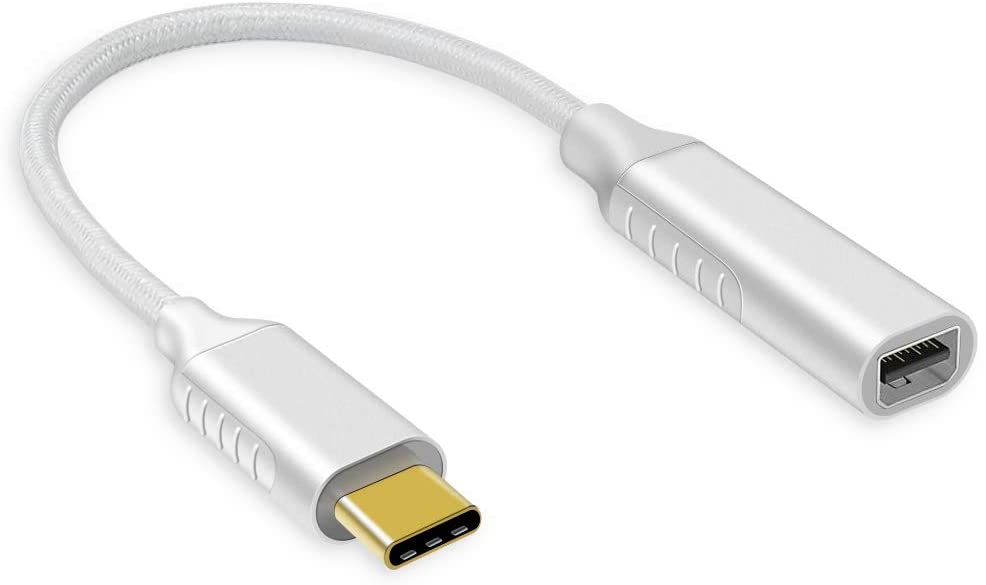

This will not work. The TB3-to-TB2 adapter does not pass through a DisplayPort signal. You will need a USB-C (male) to Mini-DisplayPort (female) adapter for the 24".

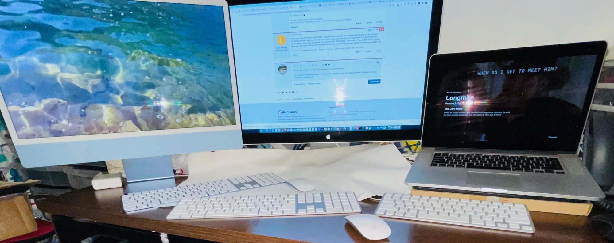

I was able to connect a 11 year old 24" Apple LED Cinema display to my M1 iMac using this adapter - USB-C to MiniDisplay port adapter:
The Apple 24" display lines up pretty well with the new iMac.
Sound, microphone and FaceTime camera works perfectly thru the adapter.
This is a good setup for Zoom, Skype, Team, WebEx meetings - choose between the 720 and 1080 Facetime cameras.
