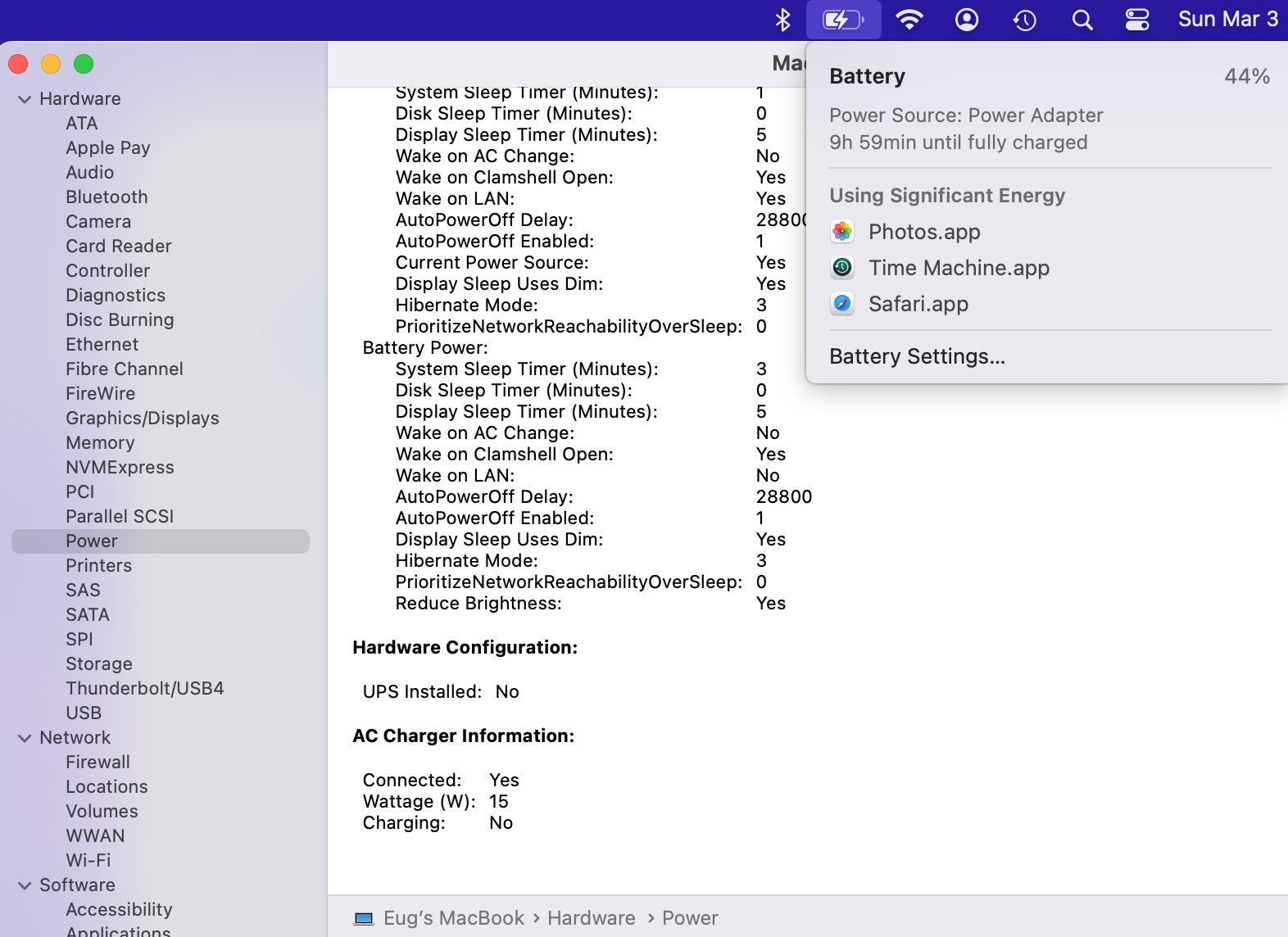

According to System Report, my 12" MacBook charges at 15 W with the Eaton dual USB-C 25 W outlet. So that's 5.0 V 3.0 A. I wonder what it'd be with the Leviton dual USB-C PD 30 W outlet.
BTW, the battery icon in macOS Sonoma sometime says the MacBook battery is not actually charging*, but in my experience it does charge even with the iPad 12 W (5 V 2.4 A) charger, albeit very slowly when in active use.
*Actually right now it says it is charging, but that it will take 9 hours and 59 mins to charge from its current 44%. Yikes! o_O
