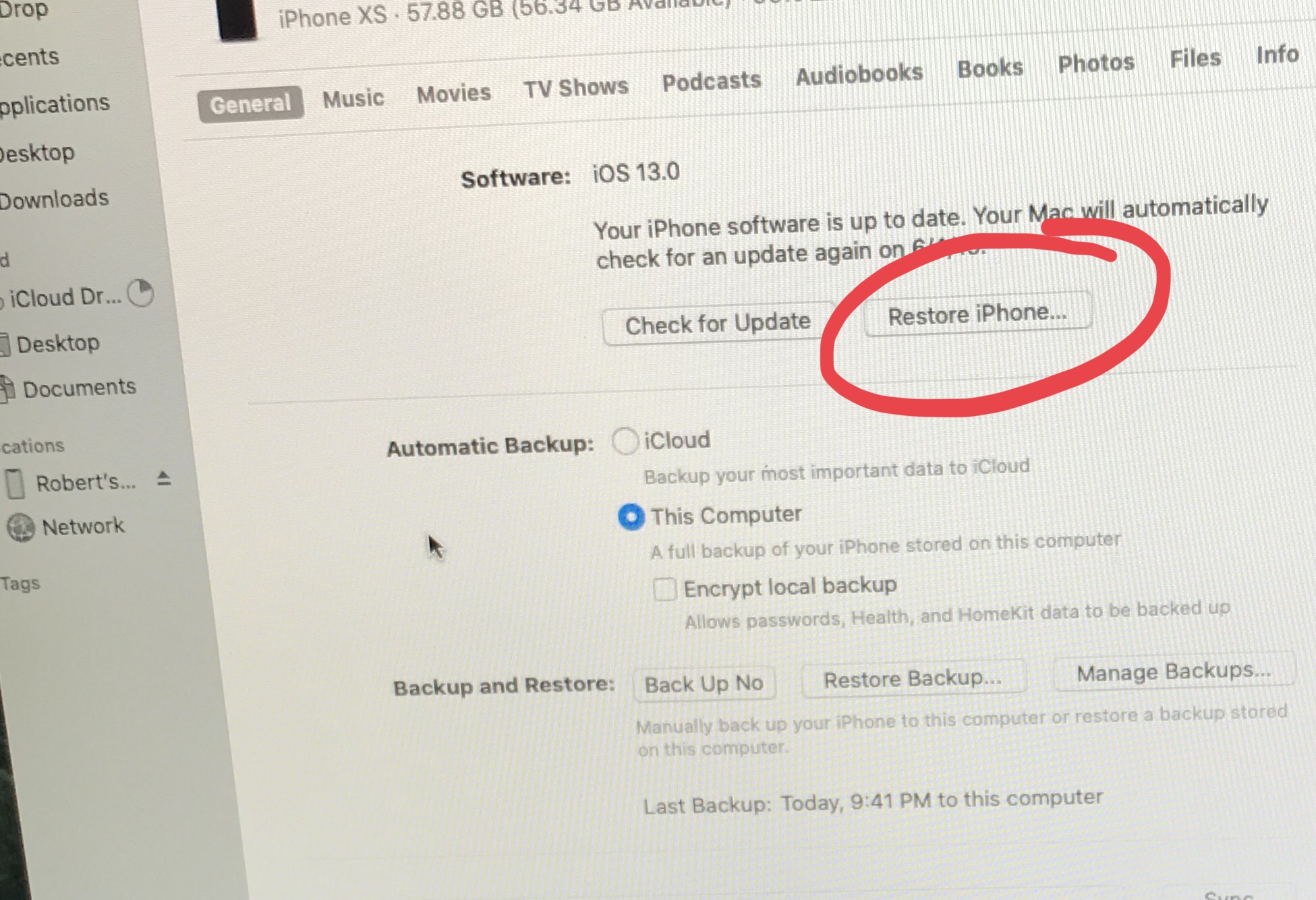

Here is where I “hit restore”. I simply held down the Option button while pressing. That immediately brought up a finder window where I directed it to my ipsw file.

I'm running iOS 12.4 beta... could that be the issue??? that would be stupid..jajajaj Because I do all that and once i select the iPSW file.... nothing... even if I just click update, (No key) It just pops and say "latest version installed" then, blank... whatever i click, it goes blank
