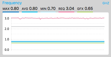

I'm running a Late 2011 MBP on 10.14.6 High Sierra.
OEM battery, OEM charger and dedicated graphics (radeongate) all died years ago. Aftermarket batt was finally expanding so much it was popping out the trackpad so I pulled it before it explodes and am running on just AC power.
After pulling the battery and updating to the latest high Sierra update I started having the kernel_task 300%+ cpu usage problem (but it's probably not having a battery)
I had to boot to recovery mode to be able to edit the kexts from the post on page 1 (below) which so far seems to have fixed the issue, but like you I'm now limited to 800Mhz, probably because the charging system can't handle the power for higher clock speeds. Even if you could disable the throttling, the computer would likely shutdown the moment it tried to ramp up the clock speed. CPUs need a lot of power.

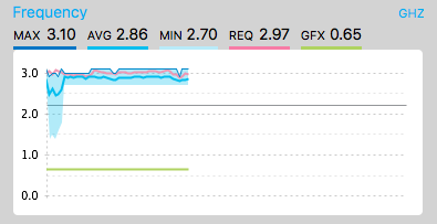

YES!!! I still had the OEM battery. It doesn't really hold much of a charge. maybe 20 minutes or something, but it's enough to get the system back to 100% cpu available without having to buy a $50+ battery for an almost 10yo laptop.
BEFORE:

AFTER:

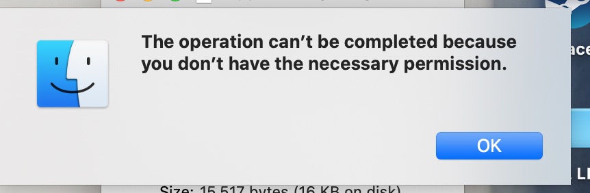

I want to do the same with my Imac but it denies me the authority to delete this file saying I do not have "ownership".
Can anyone explain how to take ownership and delete this file please?

Even if I try to change this .plists file or ownership attributes I get this..
