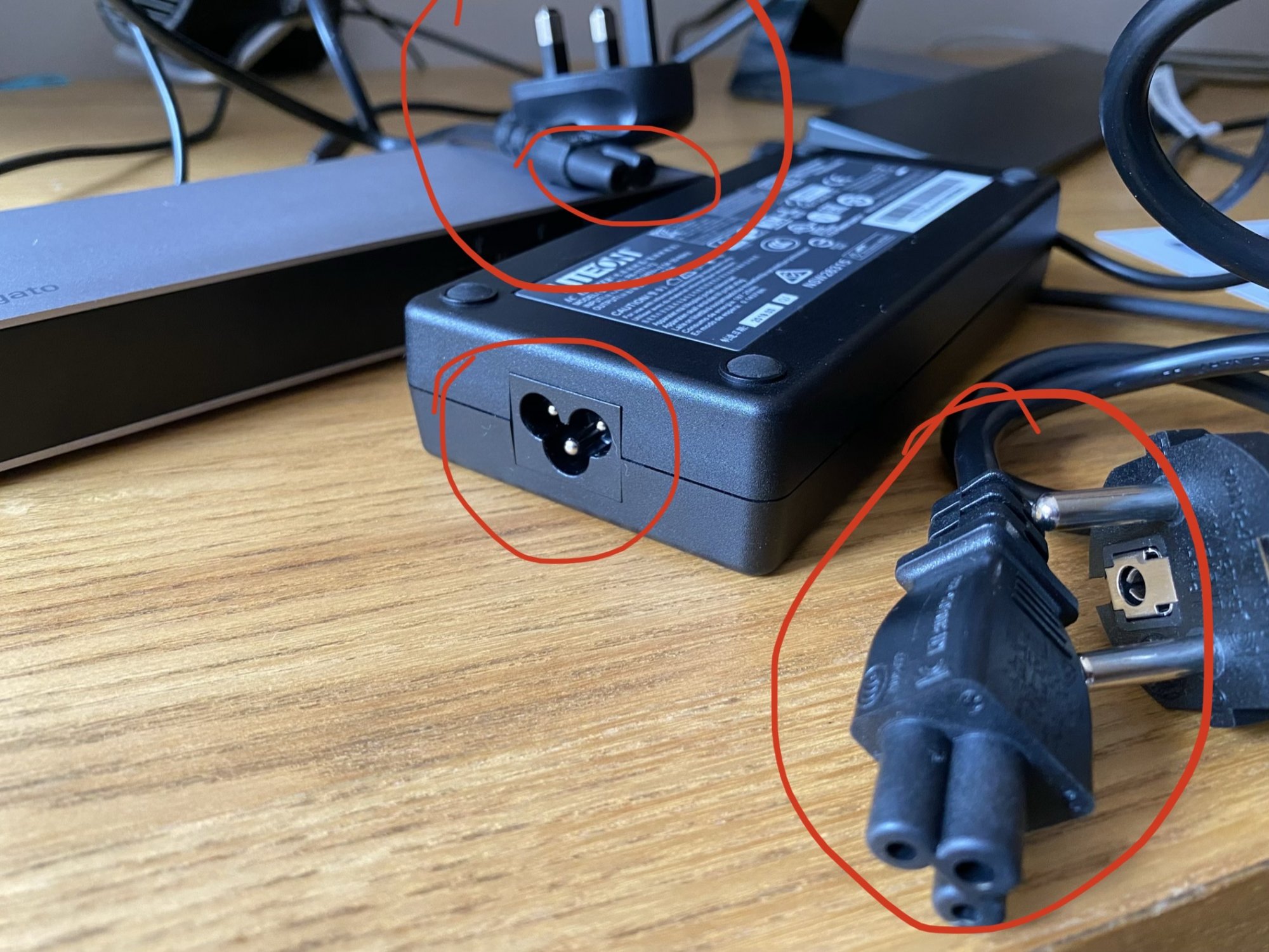

I bought the Elgato Thunderbolt 3 Pro Dock, as that seemed to meet all my needs...though I'm a bit confused sometimes as to when a TB3 will work and when it specifically must be a USB-C. However, when it arrived over the weekend (I live in the UK) I found that the UK plug adapter didn't fit the power brick (image attached) and so I am having to send this back For a £300 purchase, I find that incredibly poor service.

For the plug issue, if you like the dock otherwise, I'd just buy a replacement plug cable. You want a UK plug one end, and C5 plug (the Mickey Mouse looking one) the other end.
