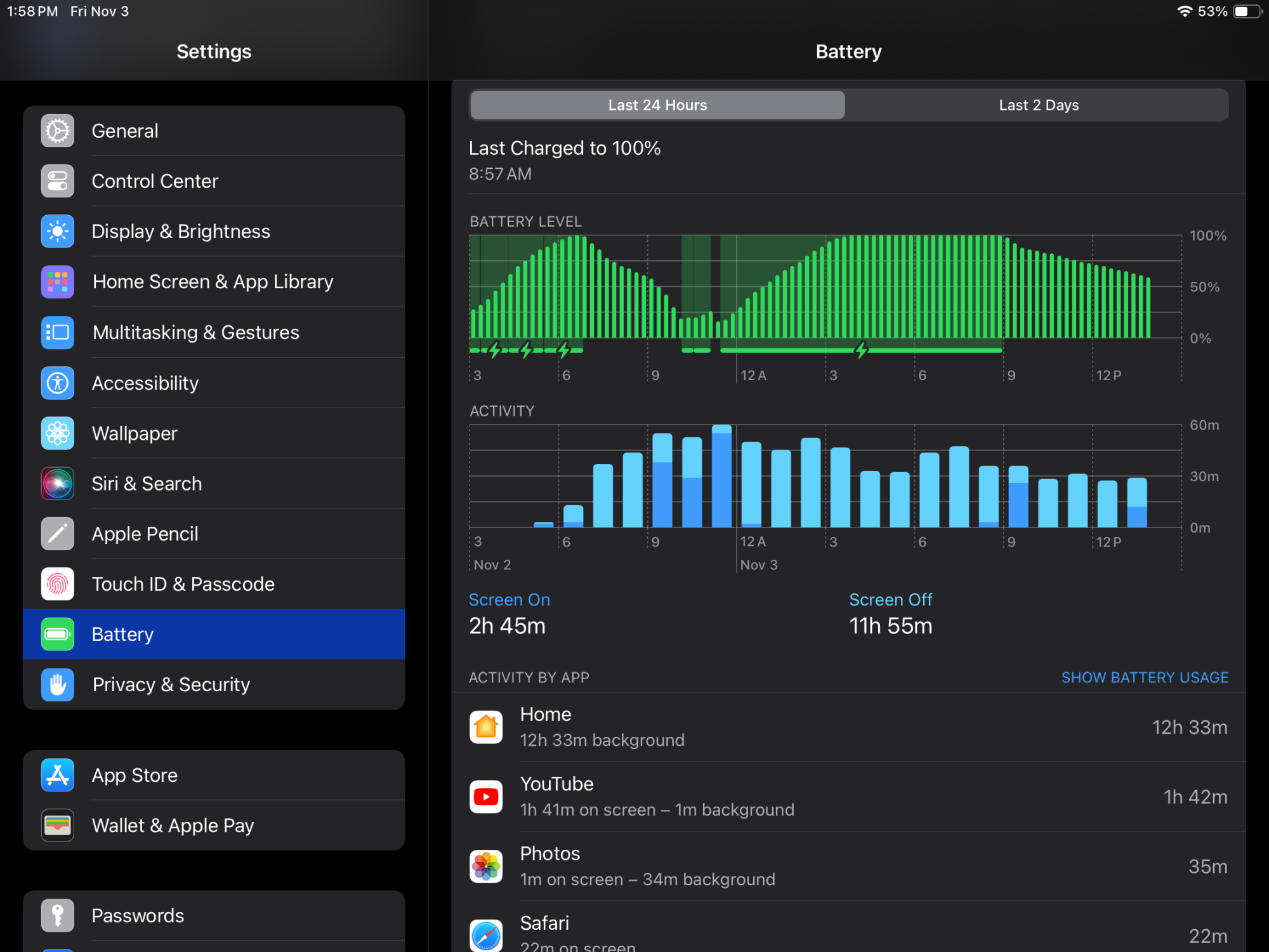

Since performing a wipe & iCloud restore on my iPad Pro 10.5 yesterday, the battery settings page showed me something interesting. Seems the Home app, which I haven't even opened or used since the restore, is binge eating my battery.
The battery usage screen didn't show this kind of usage about the Home app before the wipe & restore.
Now, I'm thinking I'll have to leave a home and possibly set it up again. I'm not a Home app expert. Maybe this will help someone else too.

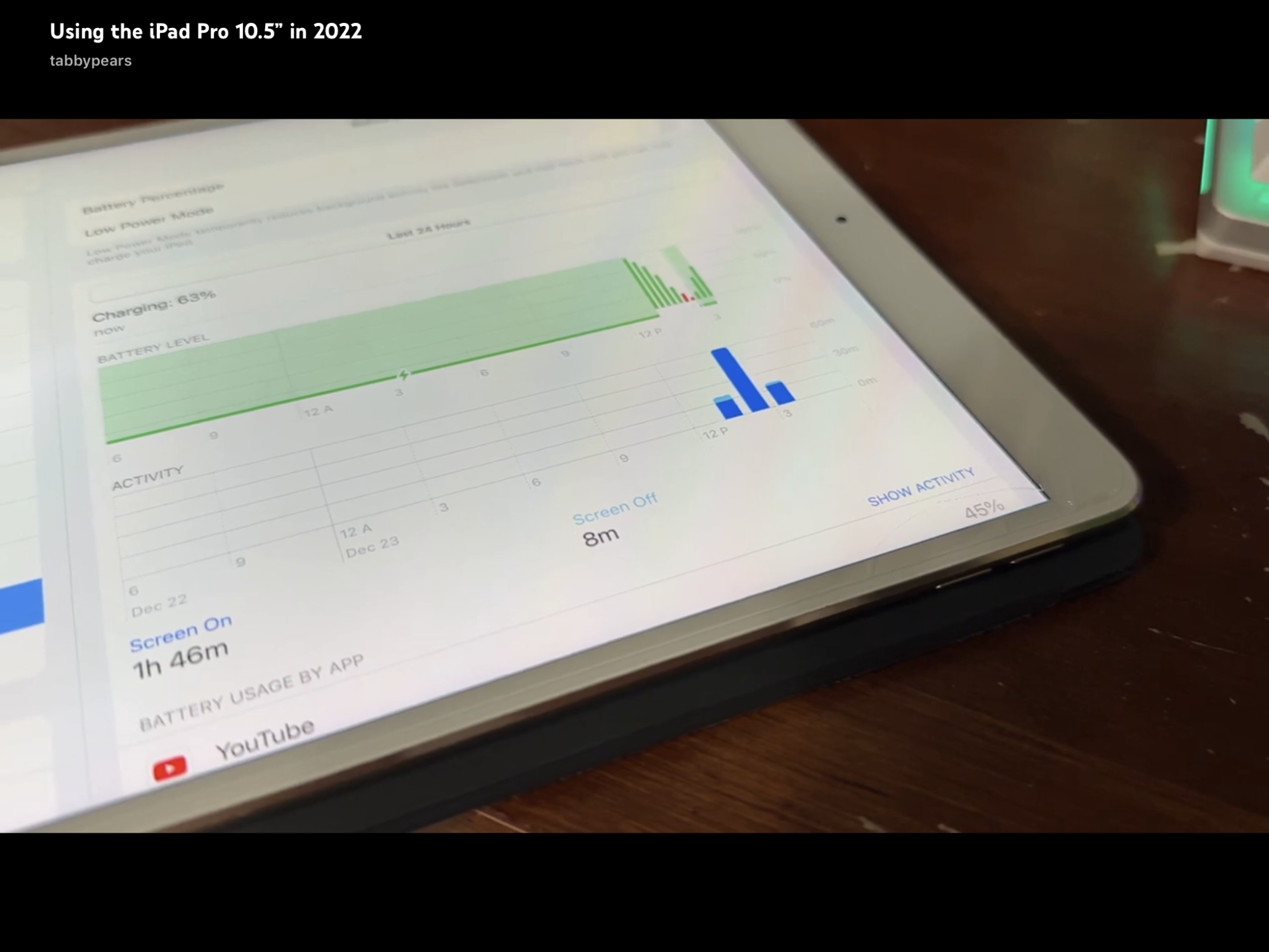

This is a screenshot from a video I found of a 10.5-inch iPad Pro user complaining about battery life on iPadOS 16:
That’s 1 hour and 15 minutes of screen-on time from 100% to almost dead. And that’s on iPadOS 16. They really pushed too far this time. Reminds me of the iPhone 6s on iOS 15. Battery life-wise, these devices are just gone regardless of what you do or how you use them.
