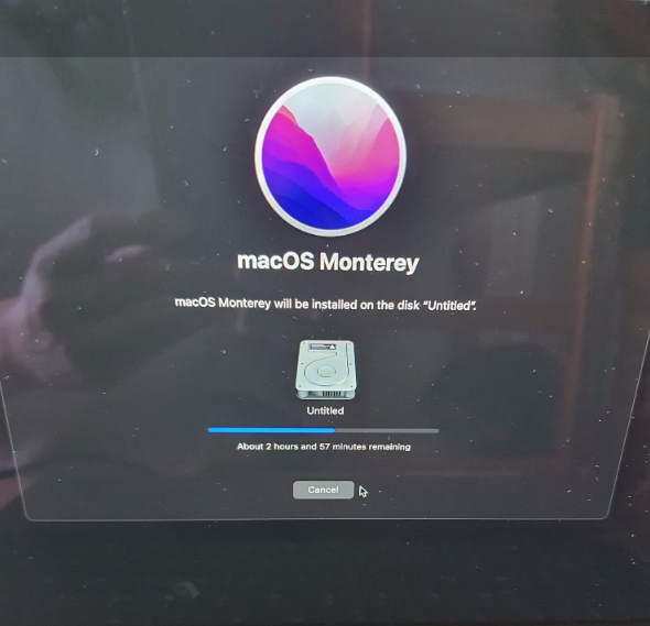

Bought an used M1 laptop, received it yesterday but have huge issues reinstalling OS. I had to goto startup options and then reinstall via downloading the internet, but since leaving it last night no progress has been made. I'm not sure what the previous owner has done and maybe be something to do with the partition?. The HDD is there but for some reason when I load up startup options I only see the gear icon and no HDD?.

When I first booted it up it went to the choose language section and then a screen to install OS?. However, there was no wifi icon on the top bar. So I googled and was told to power off and then hold power on to get start up options. There ws disk utility, reinstall os, time capsule thingy and using safari for help.
So I choose reinstall os but nothing happens, tried on a different wifi and still always start and states 2hrs 57 minutes but like I said I left it over night and still the same thing.

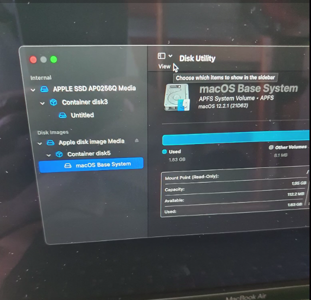

SO I then decided to check disk utility and the HDD is there but not sure what to do?

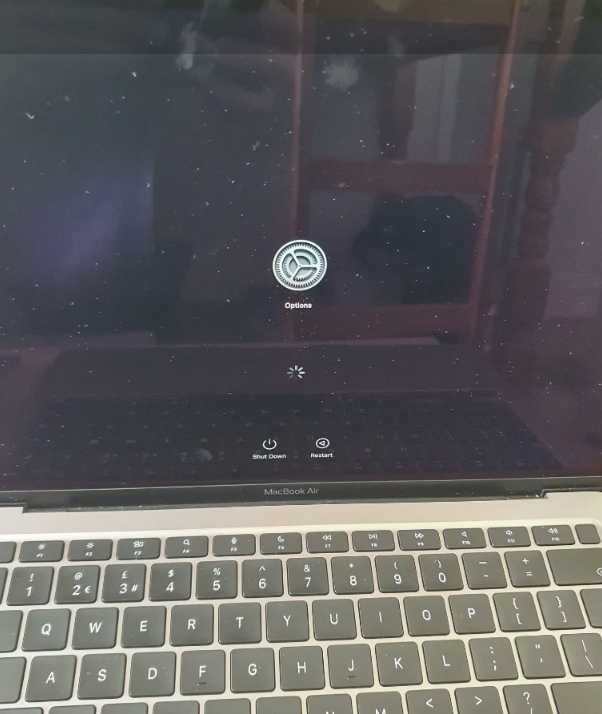

Thanks checked diagnostics and found nothing wrong, feel like the previous owner has messed with the partition?
Here is what I see when I load into startup options
Partitions
Wiping the HD still and I have the same issue, starts and gets stuck at 2 hours 57mins

Partitions

What worked for some is to erase the disk again and try reinstalling one more time.
Also put you Mac the closest possible to your WiFi router.
Thanks I have put the laptop next to the router, just start and same mesage
installer log says it downloading but then notied a few messages failed to bridge device?
Erase the disk one more time (Inside Disk Utility, click APPLE SSD AP0256Q Media, then Erase with default options).
Try to install again and give it time. If it's not progressing after 5 hours and since you don't have other Mac to use Configurator, you won't be able to solve the issue by yourself.

You mentioned you wiped the HD, but not sure how you did this. I would try booting into recovery mode, then, in disk utility select the option to show all devices. Then, select the drive (Apple SSD AP0256Q Media) and erase it. This will erase all the volumes and containers and then recreate them.
Then, try reinstalling macOS. If that doesn't work, I would return for a refund.

The HDD is visible but when in start up options despite erased it just shows the gear and now HDD
