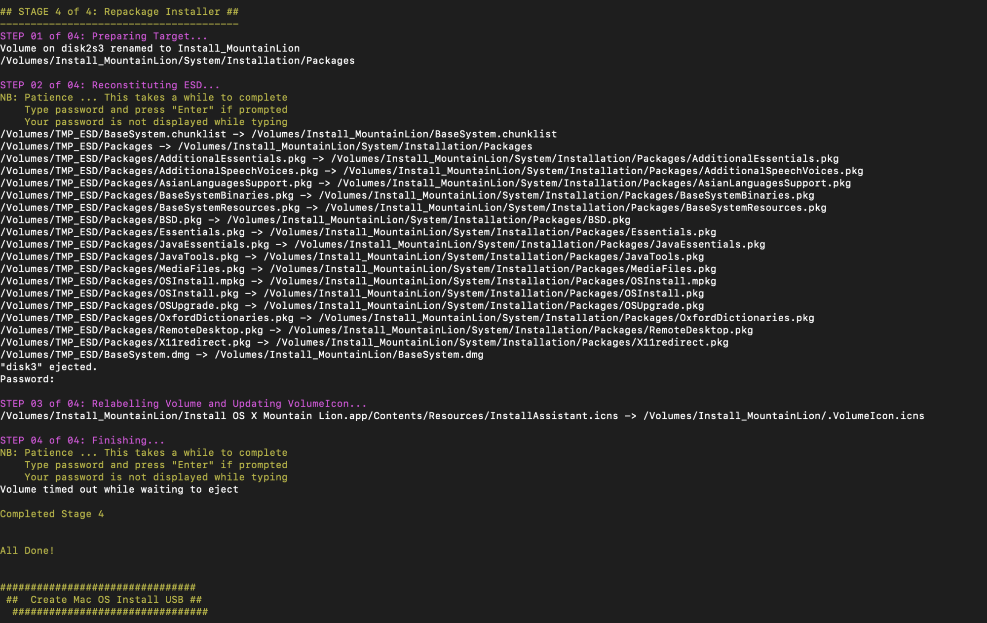

first step done
Step 0: Download the script zip file
Step 1: Download the Mountain Lion Install DMG from Apple via the link provided
Step 2: Create the target USB stick sized and named as explained
Step 3: Double click the Install DMG to mount it and close the window if it shows
Step 4: Run the script file in Terminal after unzipping as explained
Leave Step 5, running the installer, for now and get back after you complete Step 4, creating the USB installer.
Reactions: Lizzy85

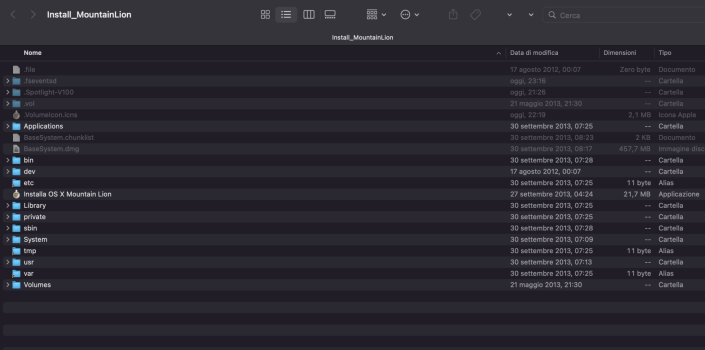

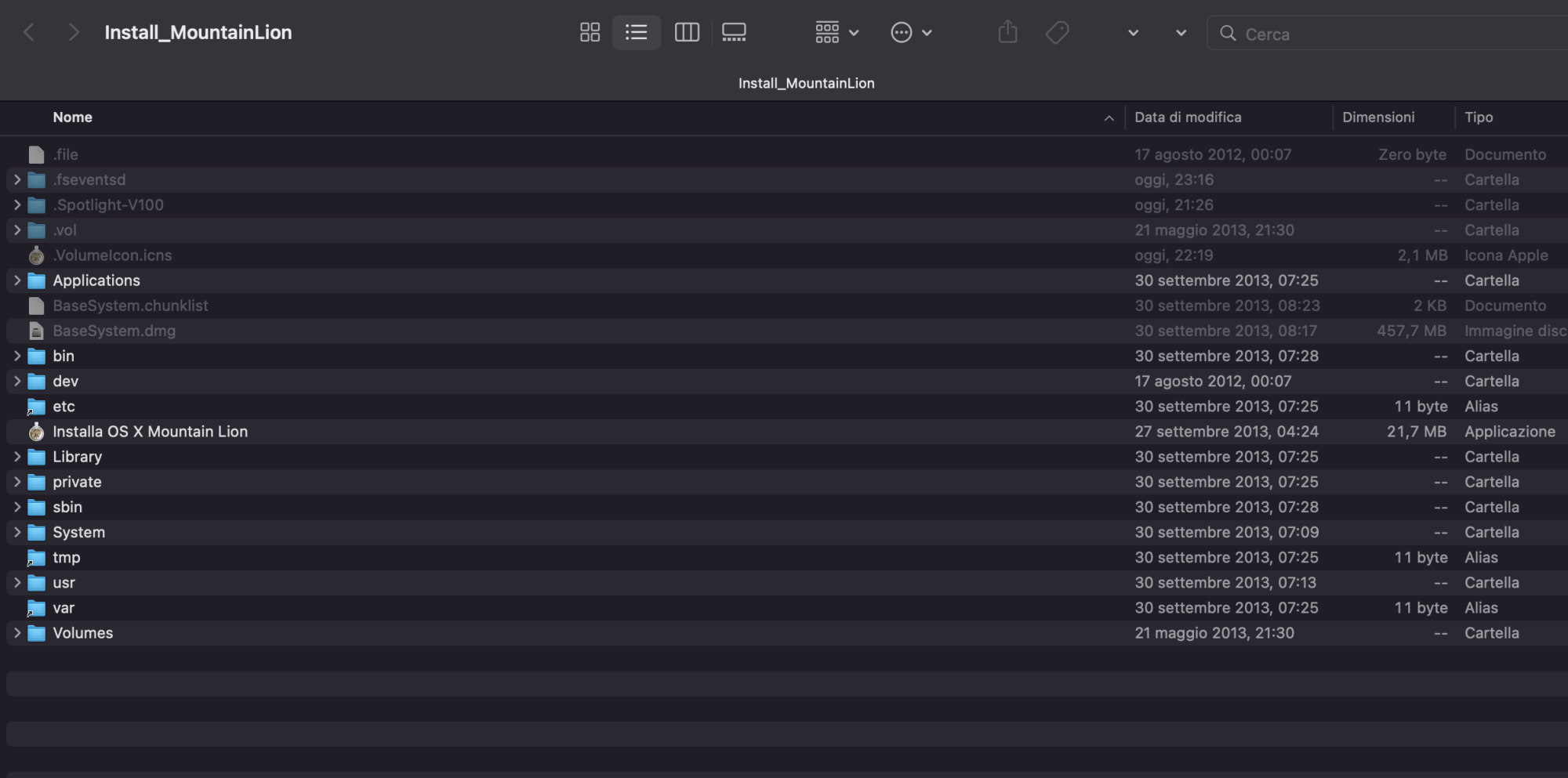

I'm on the right way? USB create.. now here to understand the point number 5. I have a blank HD. Need to use carbon copy cloner?

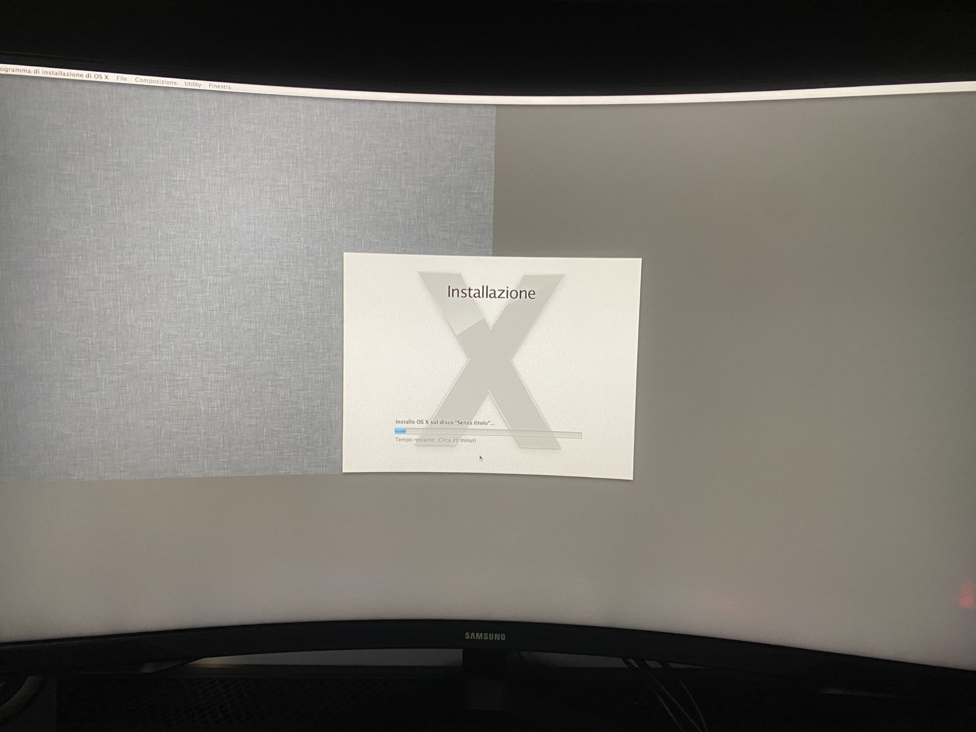

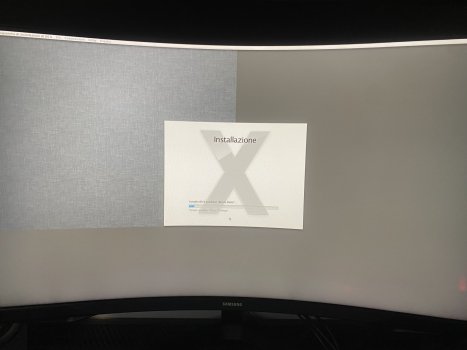

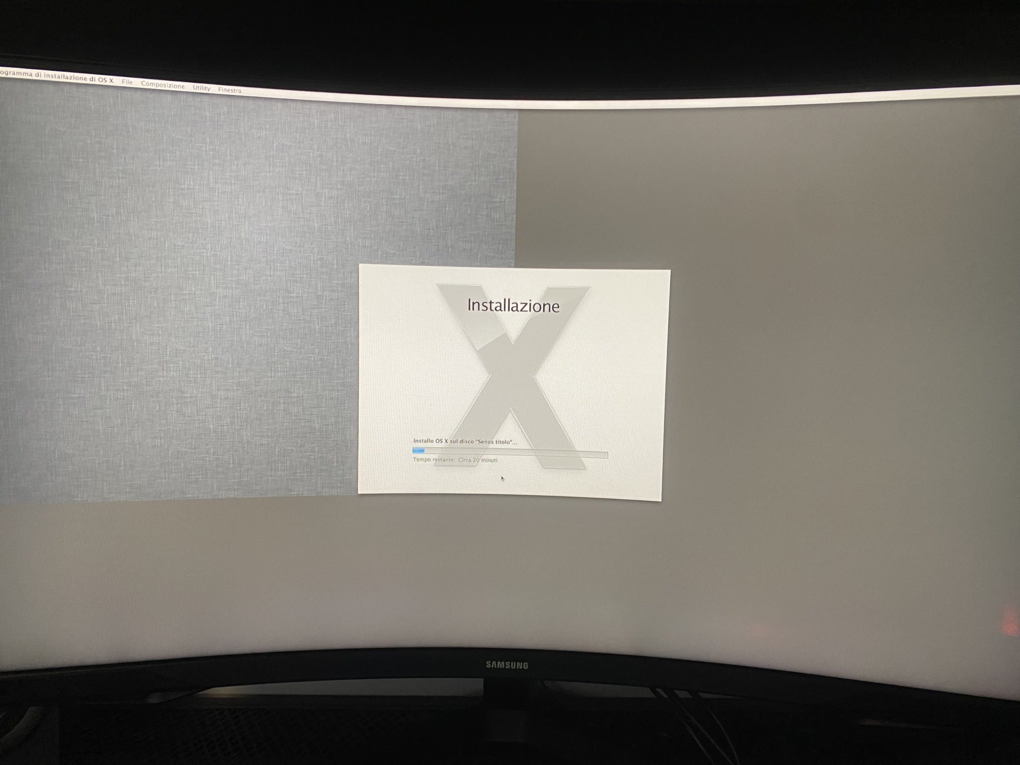

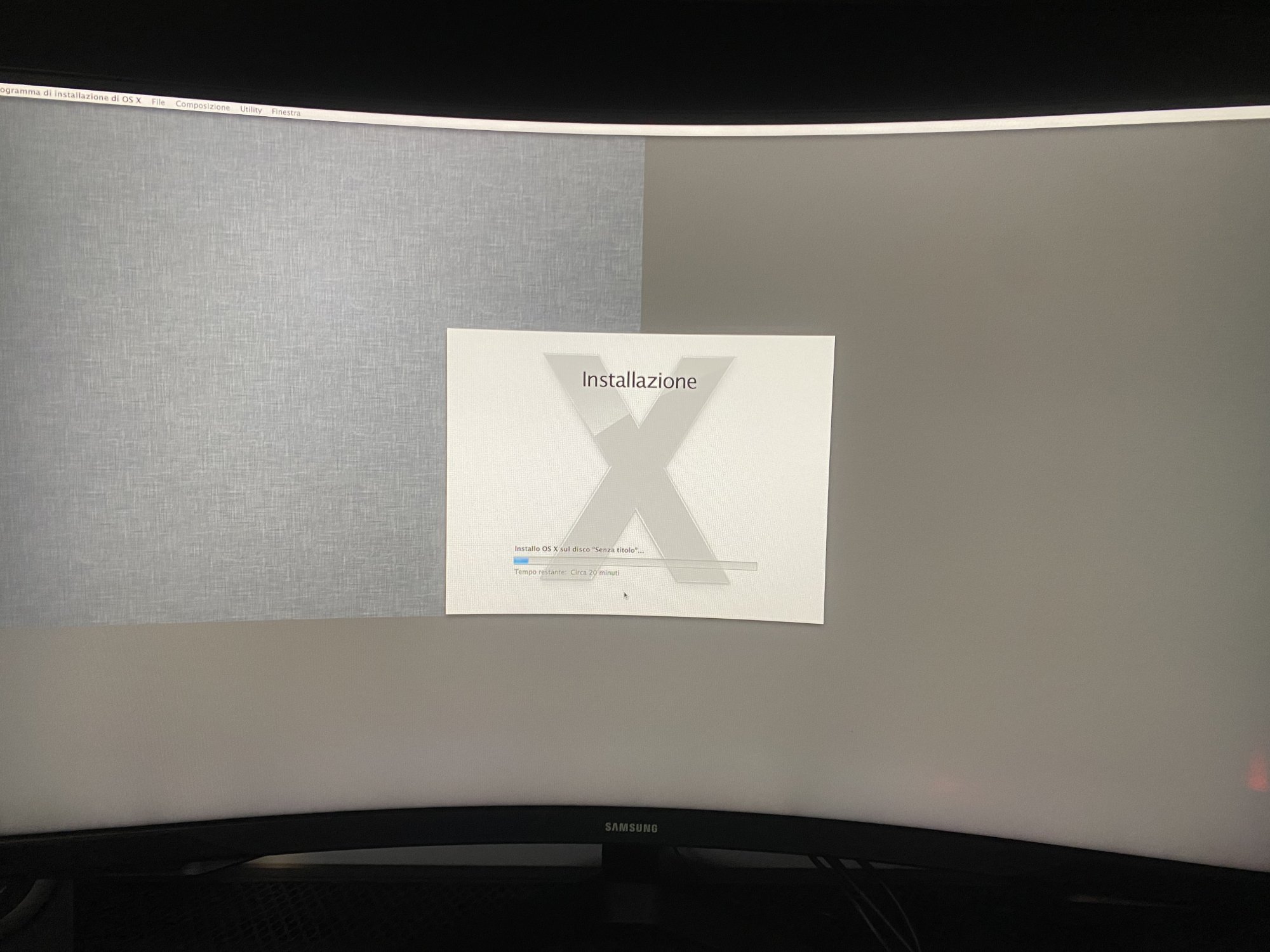

NO 4 chimes.... but appear this... I-m still waiting the 20 minute,in the meantime I would offer you a beer for the great support given 😎
Reactions: paalb
