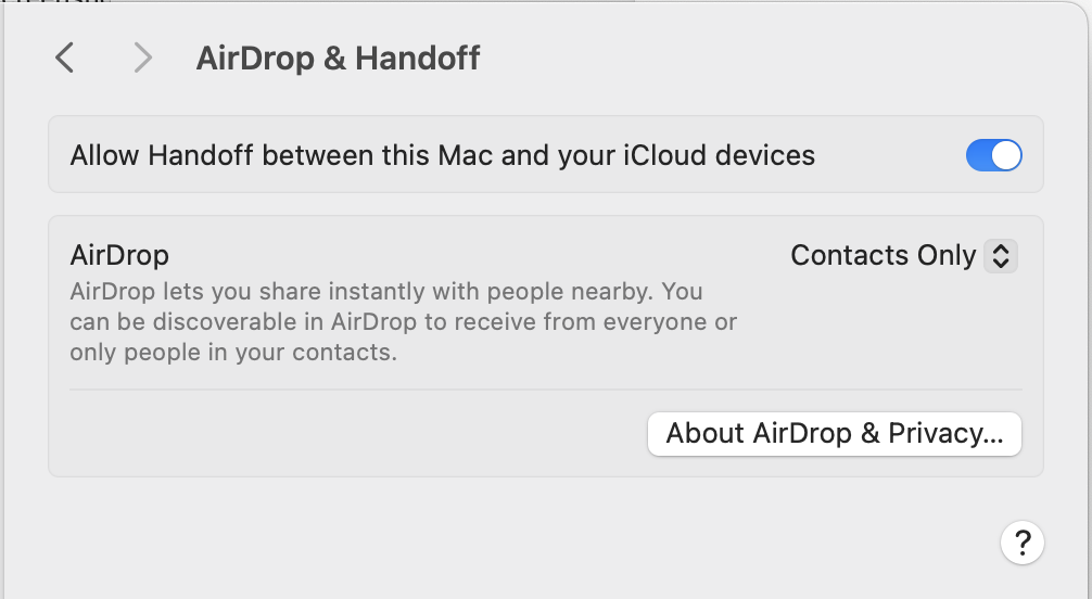

Point 1: Apple's minimum system requirement for Airplay (to iMac) is iMac introduced in 2019 or later.
Point 2: One of the earliest posts suggested:
#3 install OCLP and use Airplay
as a method to allow iMac use as external monitor.
I combined points 1 & 2 and interpreted them as meaning: updating to a recent macOS (Sonoma in my case) would allow/trick iMacs older than Apple's minimum system requirements to become Airplay receivers.
For my late-2015 iMac, this does not seem to be the case. Apple's instructions for setting up Airplay are:
  • macOS Ventura or later: choose Apple menu  > System Settings, click General in the sidebar, then click AirDrop & Handoff on the right. Turn on AirPlay Receiver.
Unfortunately there is no such option on my AirDrop & Handoff screen. It seems that Sonoma is smart enough to identify that I have a pre-2019 iMac.
You can use OCLP to turn on Airplay to Mac on the 2015 with Monterey to get OCLP working. I think that I tested this out on my 2015 MacBook Pro. The other free alternative is to create a virtual desktop on the other system using Better Display and then screen sharing into it from the iMac.
