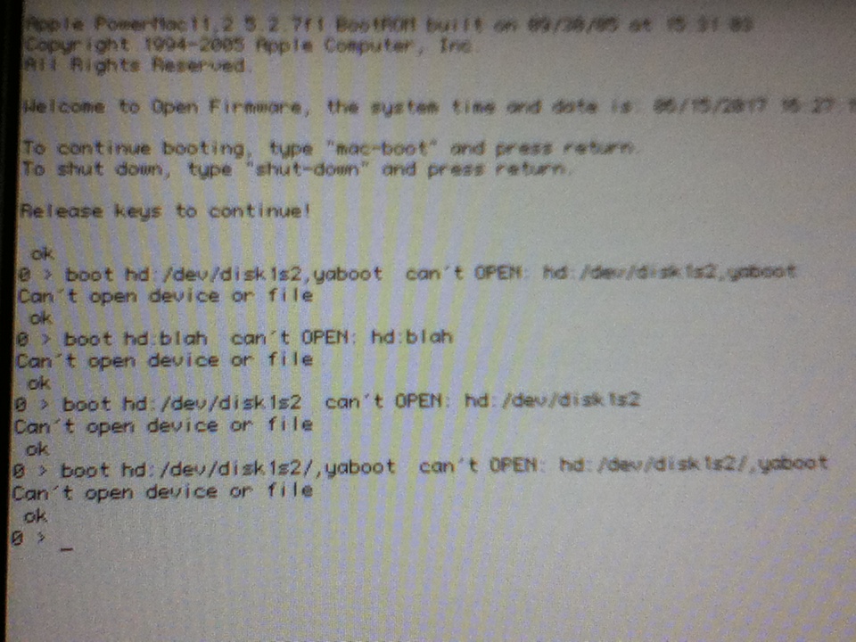

Well, I formatted the boot partition as HFS, rearranged all the partitions so they're all in the right order, and installed Ubuntu on a Ext4 partition, HFS newworld boot partition, and linux-swap, and then it doesn't go into yaboot.
I go into Open Firmware and try to manually kickstart it, and I get nowhere.
I've been weeks at this damn problem and I'm getting flippin' fed up.
What the f*ck am I missing?! What am I doing so wrong?!

Well I suggest if your patience is running out, to open a topic on the Ubuntu PowerPC forums.
https://ubuntuforums.org/forumdisplay.php?f=328
These are people who might be able to pinpoint the problem faster than me.
I don't have experience with a dual disk setup nor when the second disk has a OS X data partition on it.
Do you still have the Apple HFS+ OS X data partition as the first partition on sdb ?
As regarding to your Open Firmware attempt, devalias should give you an alias for your 2nd disk ,
maybe this helps understanding the drive paths in Open Firmware.
Open Firmware uses device paths like for ex. these
/ht@0,f2000000/pci@7/k2-sata-root@c/k2-sata@0/disk@0:
so for easier use there is a devalias to have a shortcut to this long path.
"https://help.ubuntu.com/lts/installation-guide/powerpc/ch05s01.html
At the prompt, type
0 > boot hd:x,yaboot
replacing x with the partition number of the HFS partition where the kernel and yaboot files were placed, followed by a Enter. On some machines, you may need to use ide0: instead of hd:. In a few more seconds you will see a yaboot prompt"
So you need boot <devalias of your 2nd disk>:<bootstrap partition NUMBER>,yaboot

Is it the path after Ultra/Sd1? Because that didn't work.
If it is, would it then follow with ":2,yaboot"? Because that doesn't work either. It just says that it cannot open the file.
So far, the command is "boot ?:2,yaboot".
Yaboot is located on the second hard drive, on the second partition. I've tried many things to get it to boot with that, but it always comes up with either an error, or the forbidden sign. What do I type in the hard drive portion??
To reiterate, what's happening is that in Open Firmware, I'm putting in "boot hd1:2,yaboot". 'hd1' being that everything Linux is on the second hard disk, and '2' because it's on the second partition, ON the second drive. So after that's entered, some text gets thrown up for a split second, there's a bit of orange, and then it goes to a grey screen as if an OS is being booted up, only the "forbidden" or "cross-inside-a-circle" sign comes up and doesn't go away. I'm absolutely stumped! Anything you might have in mind?
Remember, this was even done after the automatic install by the CD desktop installer.
