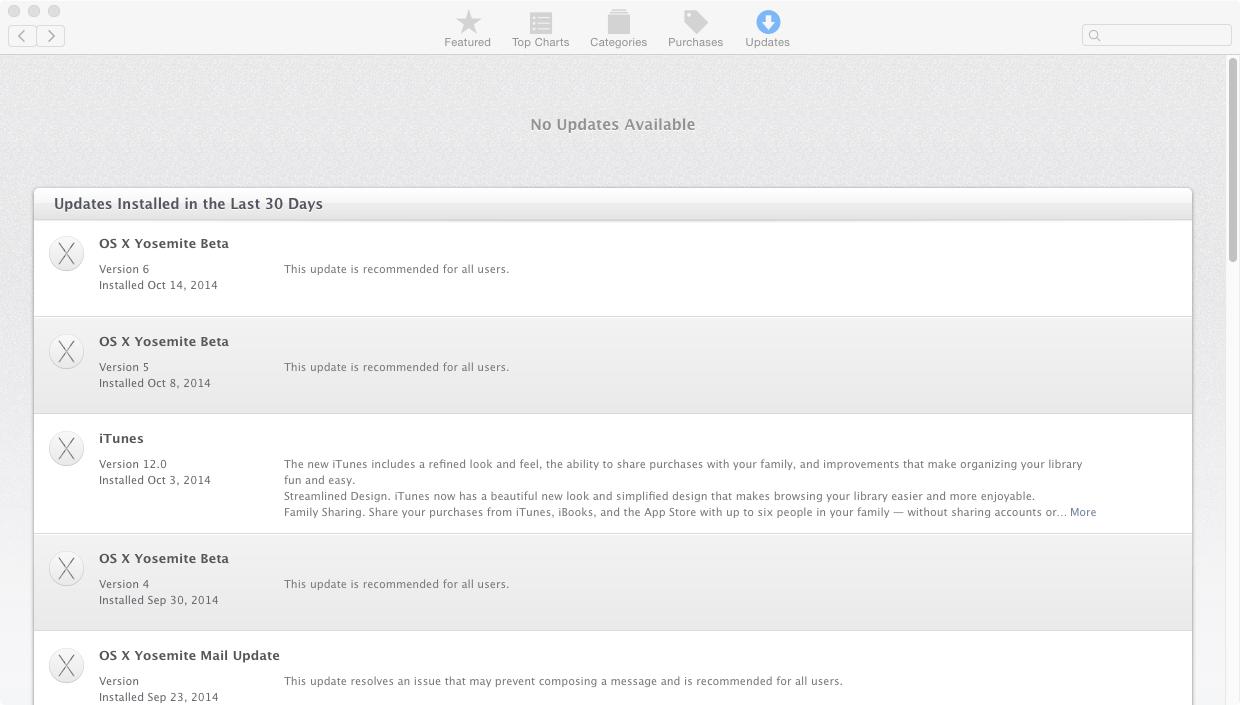

Hi, Early 2011 MBP 17'' (Yosemite PB5) and iPhone 5 here, I can't get sms sync to work, I can receive phone calls on my Mac but I am unable to start them from it (it always shows "call failed").
I tried disabling and enabling phone calling on FaceTime, and signed out and back from iCloud in both devices.
Anything else I should try to be able to start phone calls?
