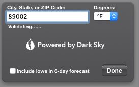

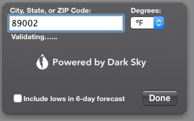

On 10.13.6, followed instructions, widget is stuck on "validating...." after putting in Zip code.
:Library:Widgets:Weather.wdgt 2020-03-11 09-12-20.jpg
Any ideas? Thanks in advance.

That's because DarkSky doesn't support Zip codes.

Have you added API keys as detailed in the first post?
Lion can't establish a secure connection with the DarkSky website.
*facepalm*
Yes, because of course DarkSky enforces https even when I explicitly tell it not to, because security, even though we're talking about weather data. What is an attacker going to do, trick me into thinking there's a thunderstorm outside?

I tried using City, State before Zip code. Got the same result. Validating.....
:Library:Widgets:Weather.wdgt 2020-03-11 14-08-23.jpg
And yes I added API keys.
Guess I'll have to live without this widget working. Shouldn't be a problem. I've done so for a few years now. 😜

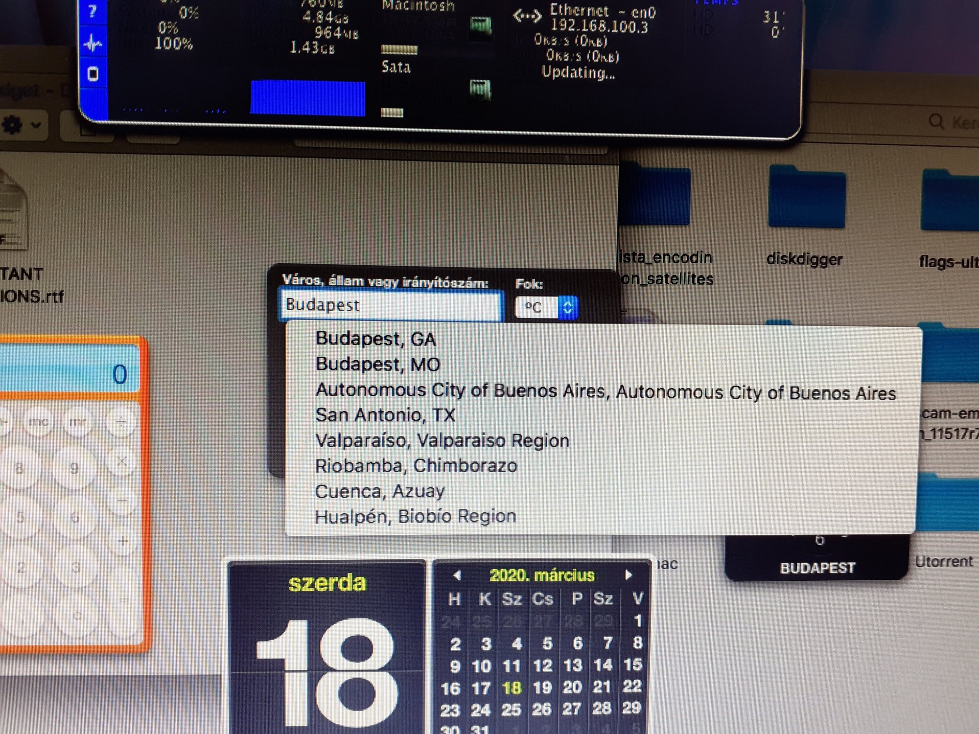

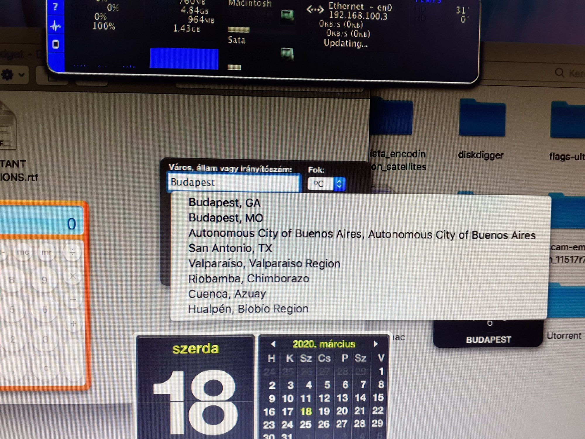

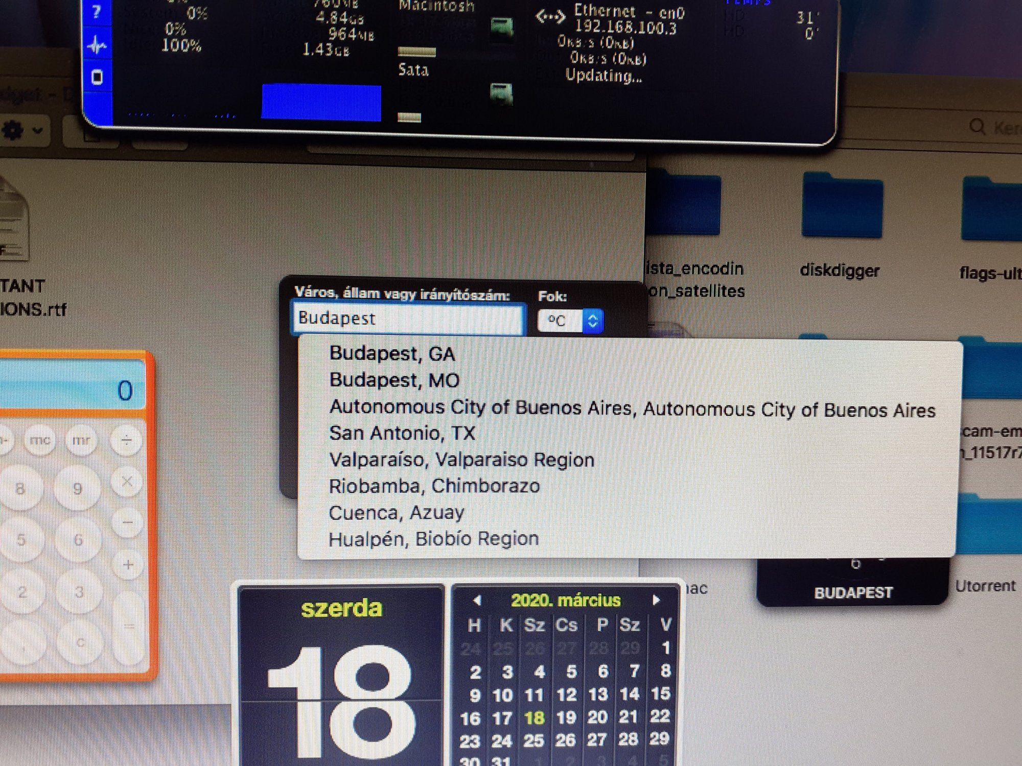

Please do something because Budapest, Hungary doesn't exist, only Budapest from USA. Thanks in advance.
The widget has been updated with a fix for the bug reported by sorcy. The download also includes documentation for 10.8 and below, and I made the setup process for those old OS's ever-so-slightly more streamlined.
No Budapest, Hungary only USA states.

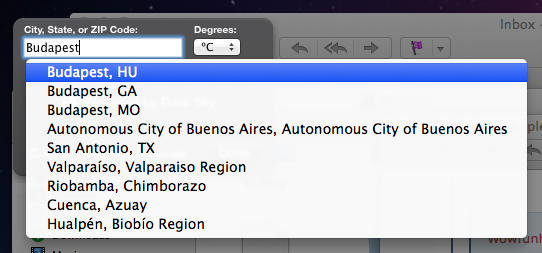

Make sure to reload, it works for me now. Top result in attached screenshot.
(You can also type in your latitude and longitude manually btw, although you shouldn't have to)
