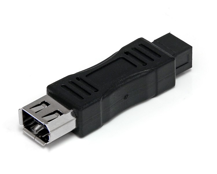

Or, there are also FW800-to-400 adapters which run pretty cheap and take up even less space. 🙂
I keep a couple of these around in my adapter cubby (in both configurations) when I don’t feel like digging out a spare FW400 cable or vice-versa. 🙂

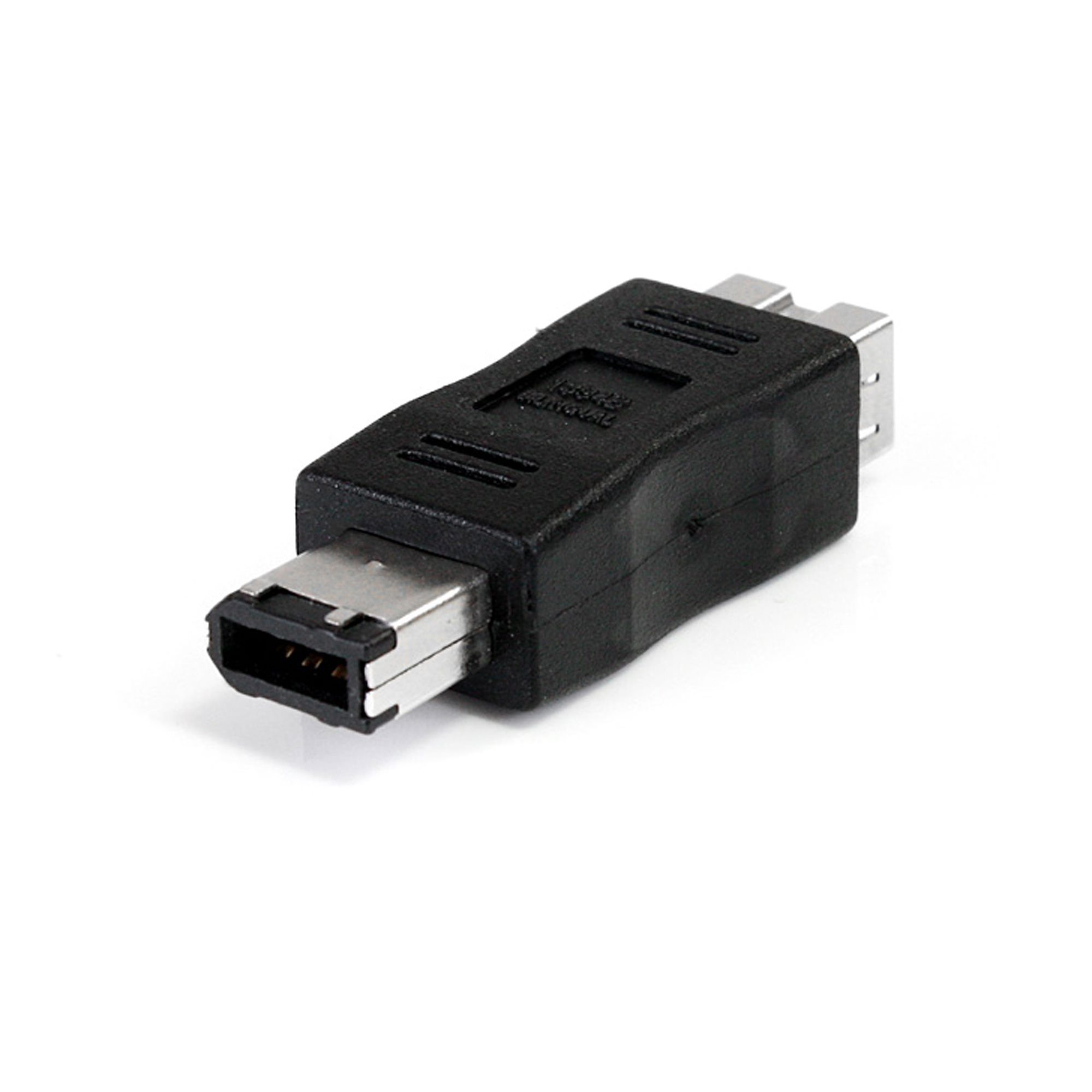

I keep a couple of these around (in both configurations, i.e., with inverse plug-receptacle) when I don’t feel like digging out a spare FW400 cable or vice-versa. 🙂
Thanks so much! I don't even have any firewire cables but I am planning on buying a FW 400 cord, but I might buy that too so I can go from g4 to G5, for example.
