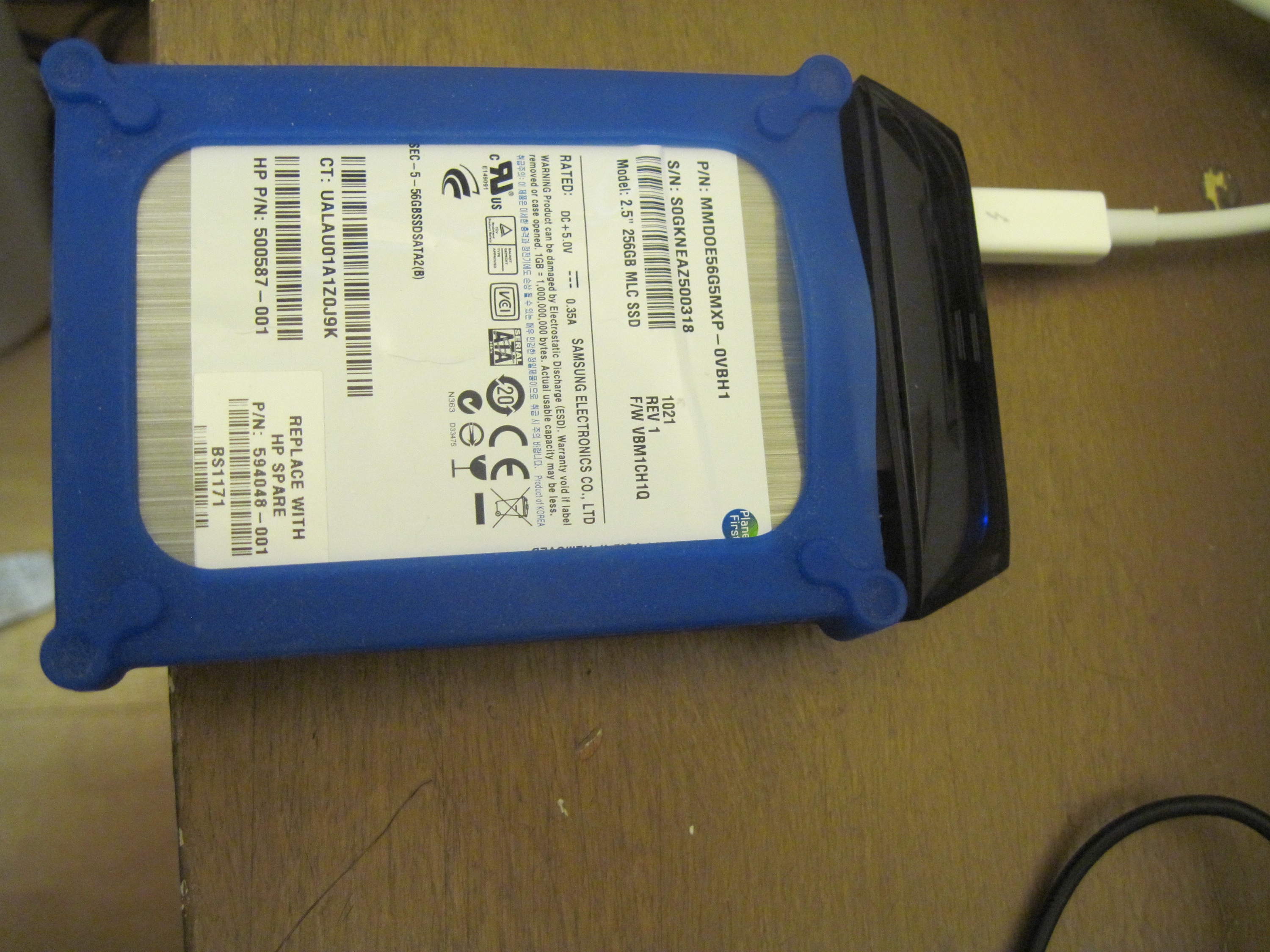

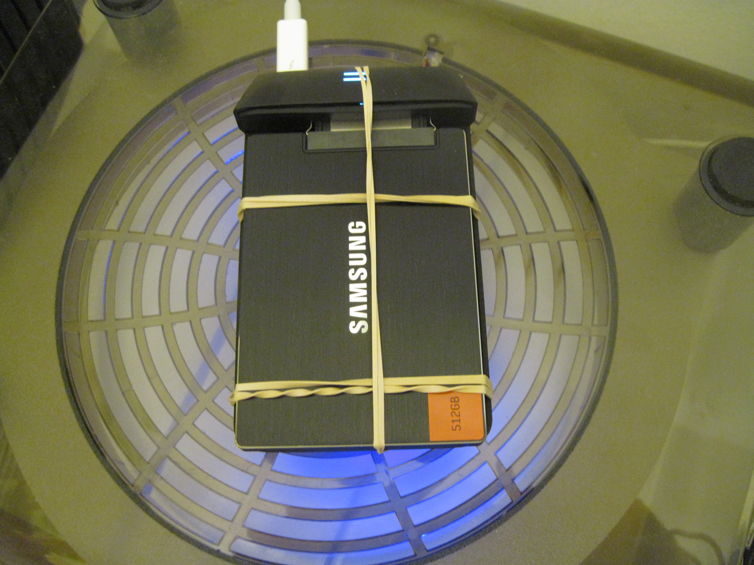

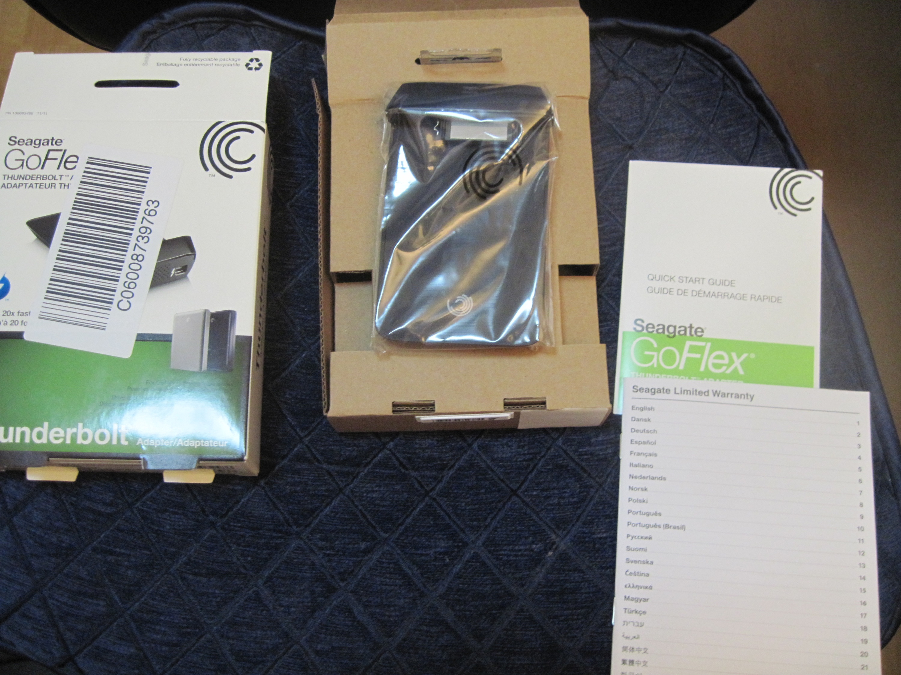

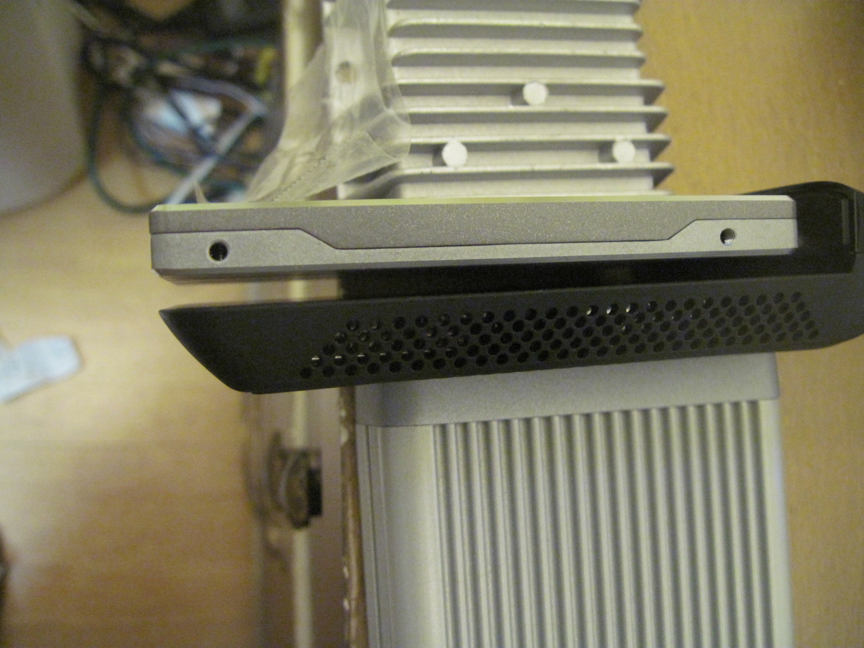

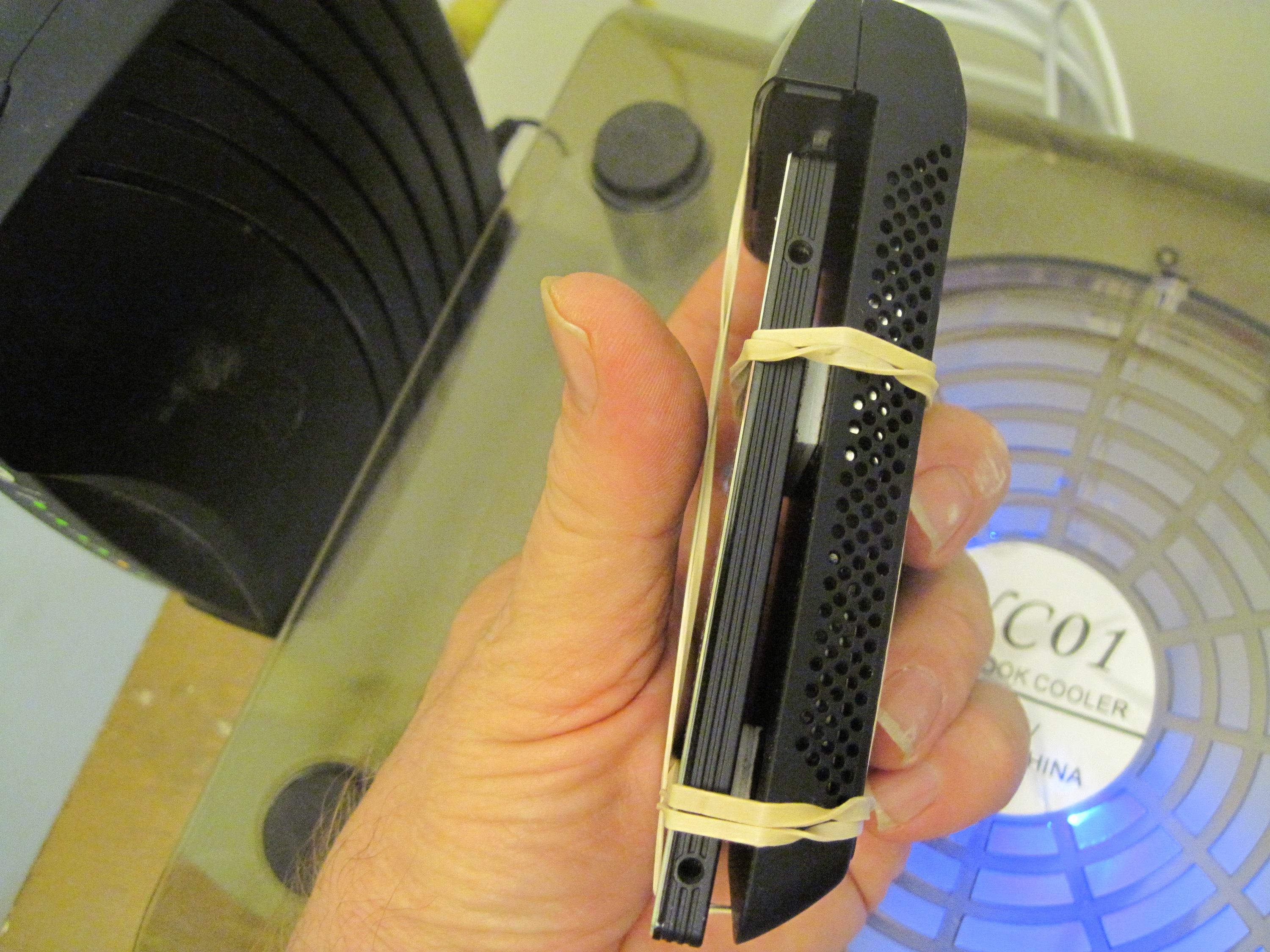

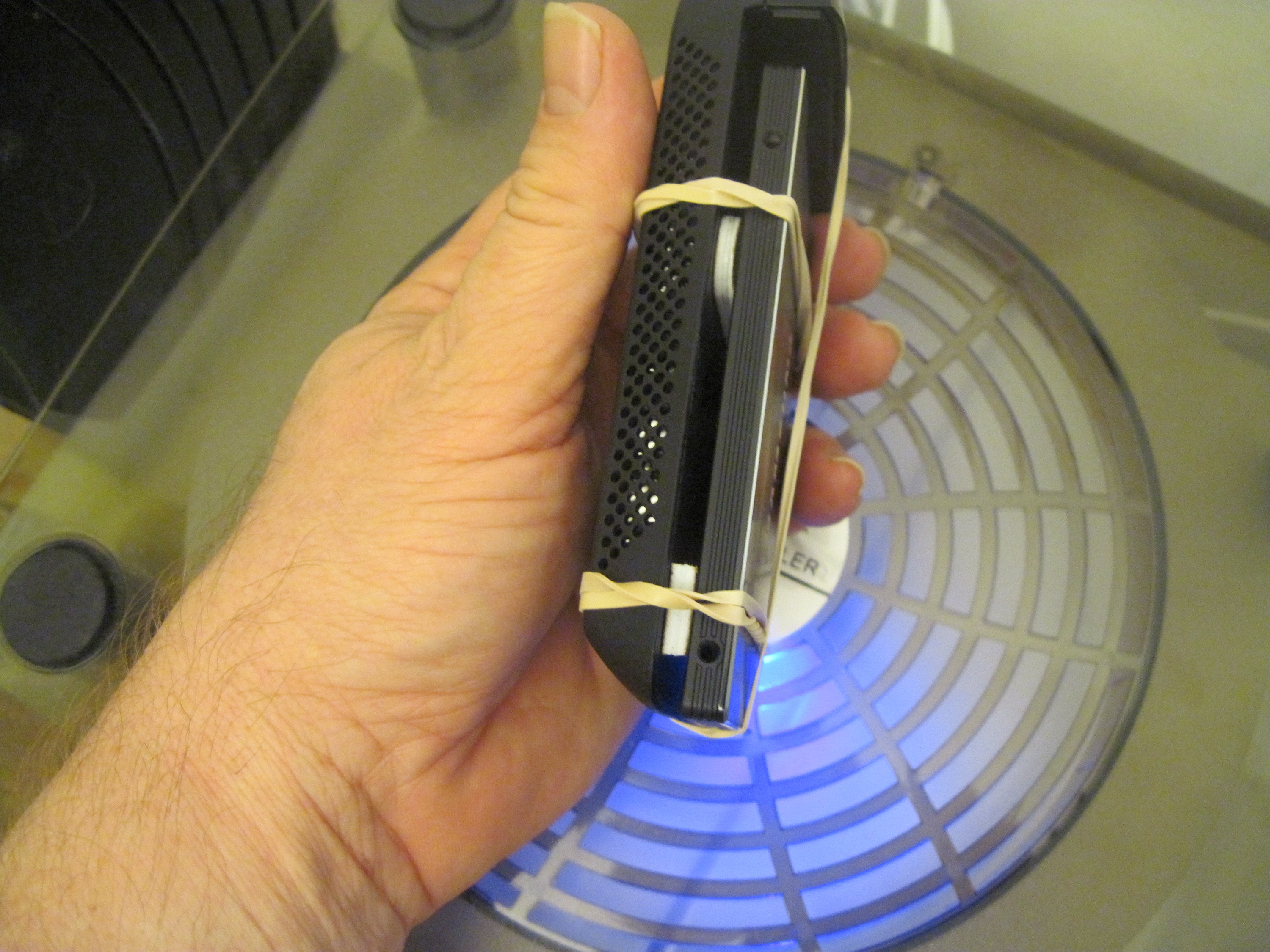

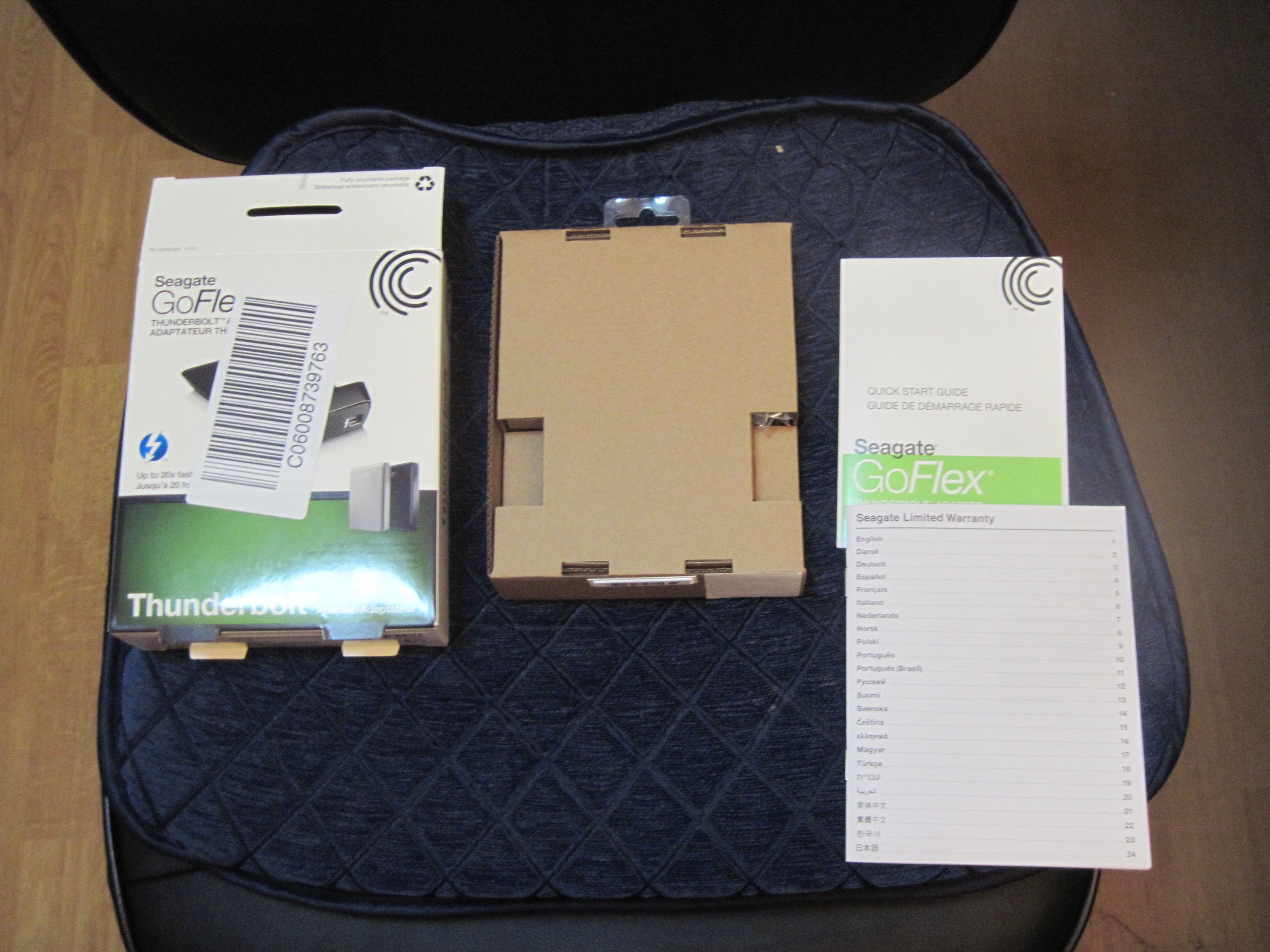

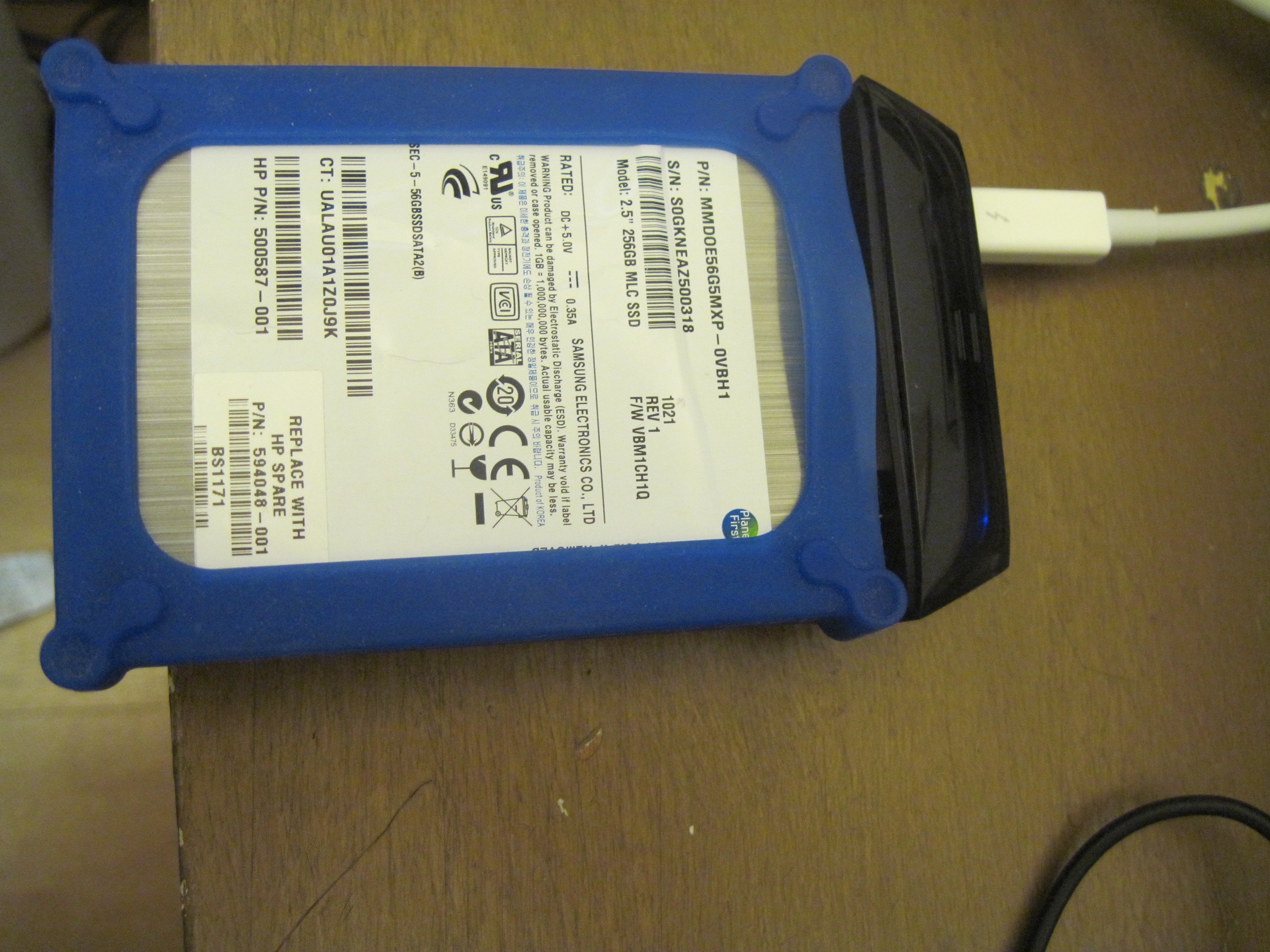

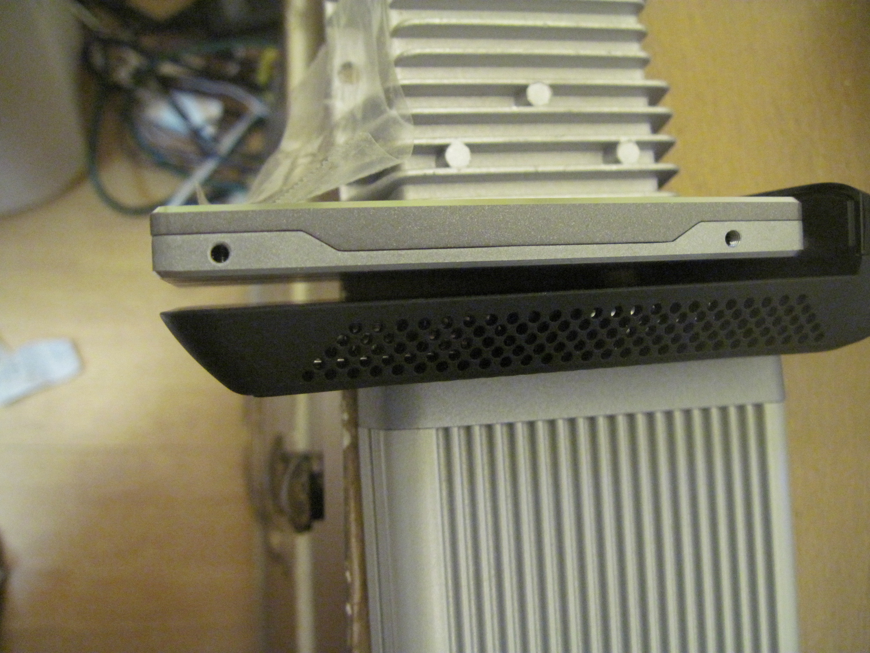

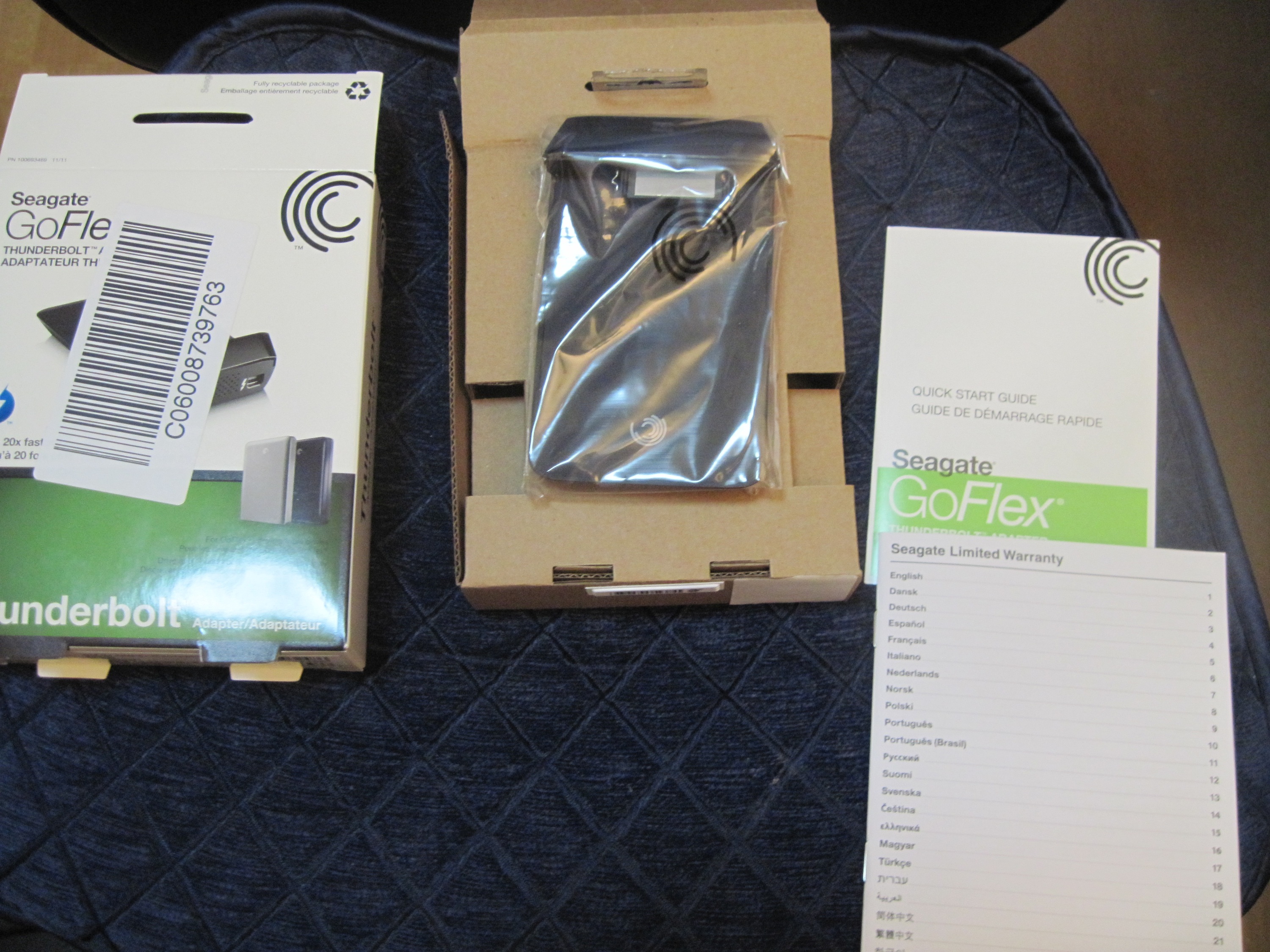

It is here!! real fast some photos
notice first problem is any 2.5 inch hdd will slide into the sata connector but these units are designed to use a portable goflex drive that has an exposed sata connection so the naked 2.5 inch drives leave a gap, easy fix a 6 dollar silicone case from ebay

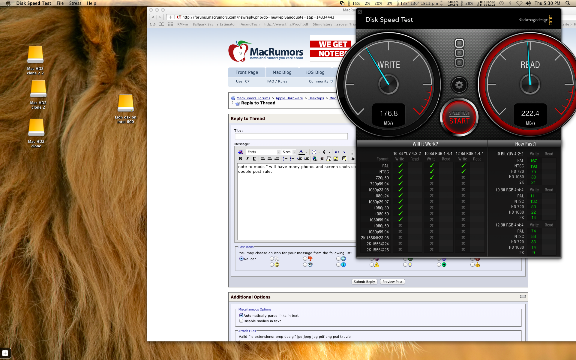

note to mods I will have many photos and screen shots so I may break the double post rule. if you look at this screen shot you see a blackmagic disk speed test taken of mac HD2. mac hd2 is a partition on the seagate stae121. if you look to the left 3 yellow volumes ;
mac hd2 clone 2 2
mac hd2 clone 2
Mac hd2 clone this is the seagate stae121

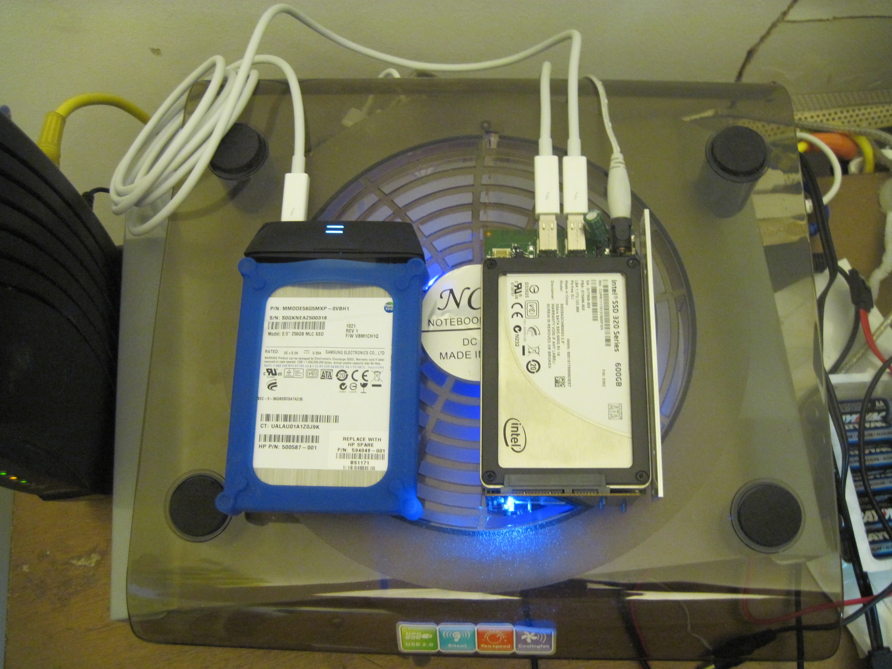

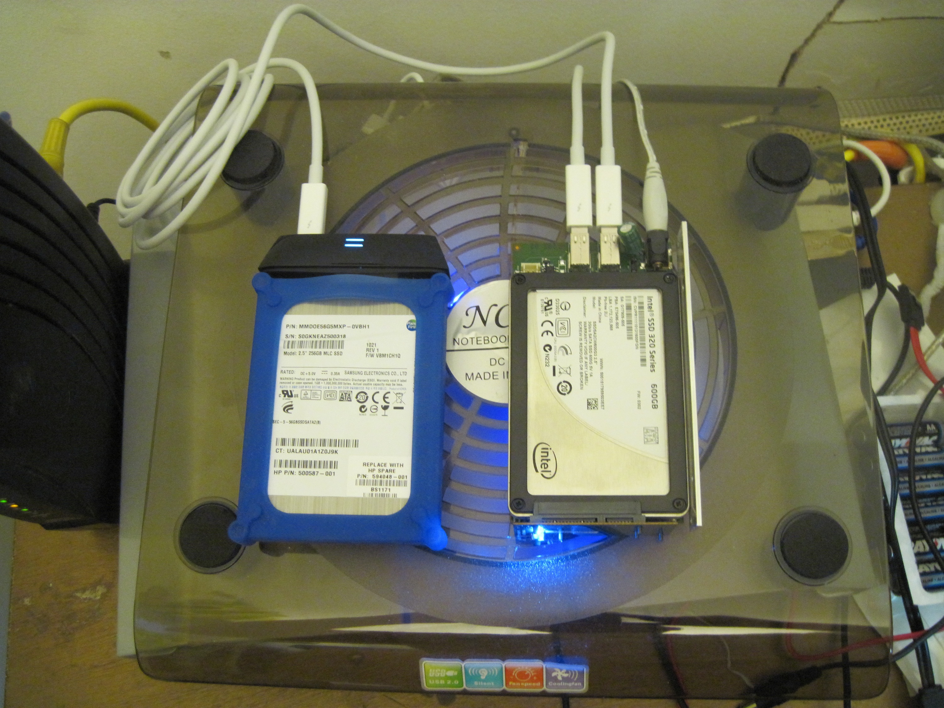

next to them is lion osx on intel 600 this is the lacie lbd. the samsung ssd is an older 800 model so scores are 220 and 170 pretty good for the ssd. and this shows the seagate can be daisy chained. here is a photo of the setup.
I tried booting the seagate stae121. mac mini ---- lacie-------- seagate
is the setup and it does boot! through a lacie lbd daisy- chained to the seagate. so now my next test will be to remove the lacie and play with just the seagate121
okay it boots just mini to stae121. next will be a few virgin ssds.

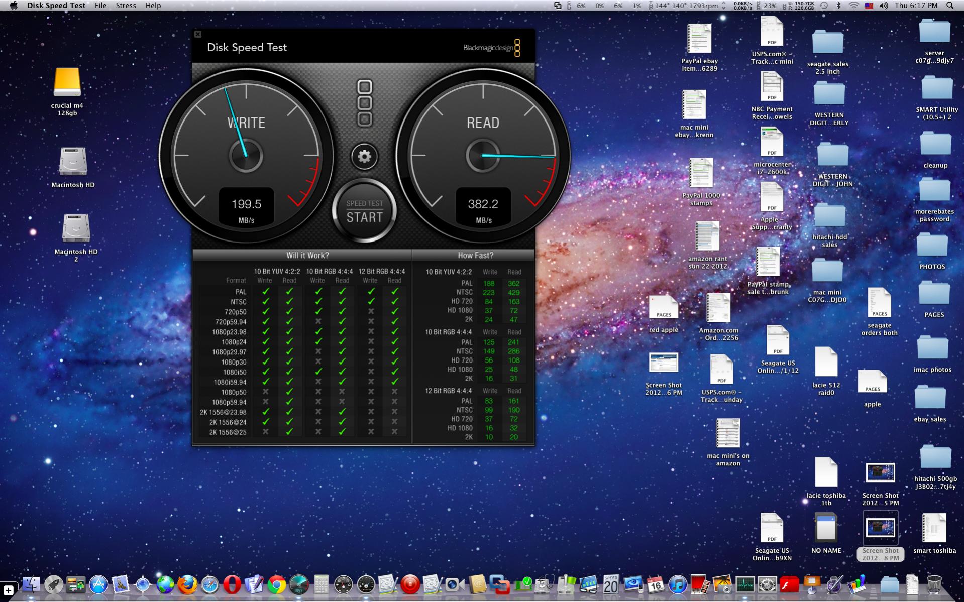

well a new out of the box crucial just did 382 read and 200 write.
now the crucial 128gb m4 ssd is a very stable sata III type ssd. ie not the fastest but i got a reading of 382 and that breaks the sata II barrier with ease> specs are 415 max read and 175 max write
http://www.crucial.com/pdf/Tech_specs-letter_Crucial_m4_ssd_v3-11-11_online.pdf.

after an hour of tests this product looks good.
I am doing an internet download to the crucial 128gb ssd so I won't have any results on the machine until tomorrow. I will run the machine with a few more ssd's I want to see how stable it is. I also want to see what it can read and write.
I have one of these and it is fast 520 max read 400 max write

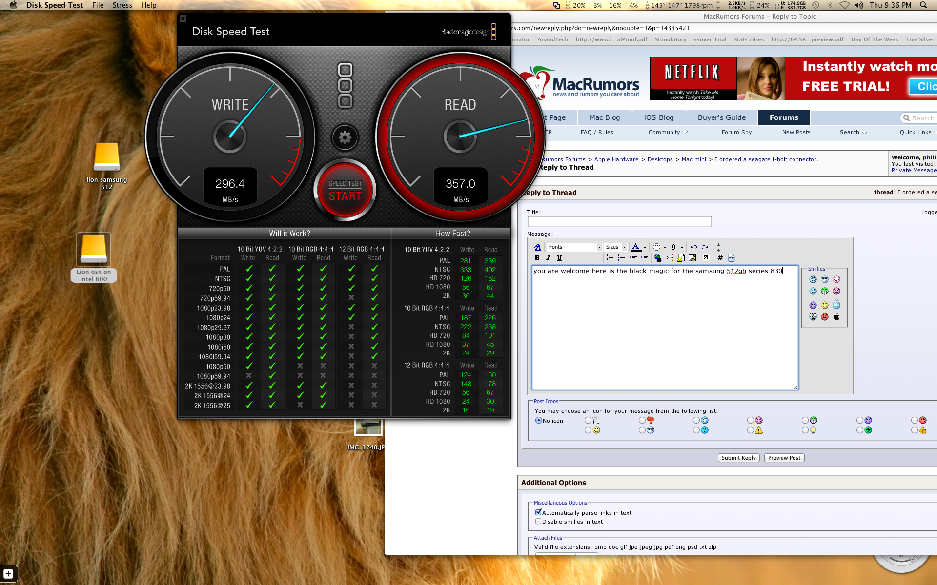

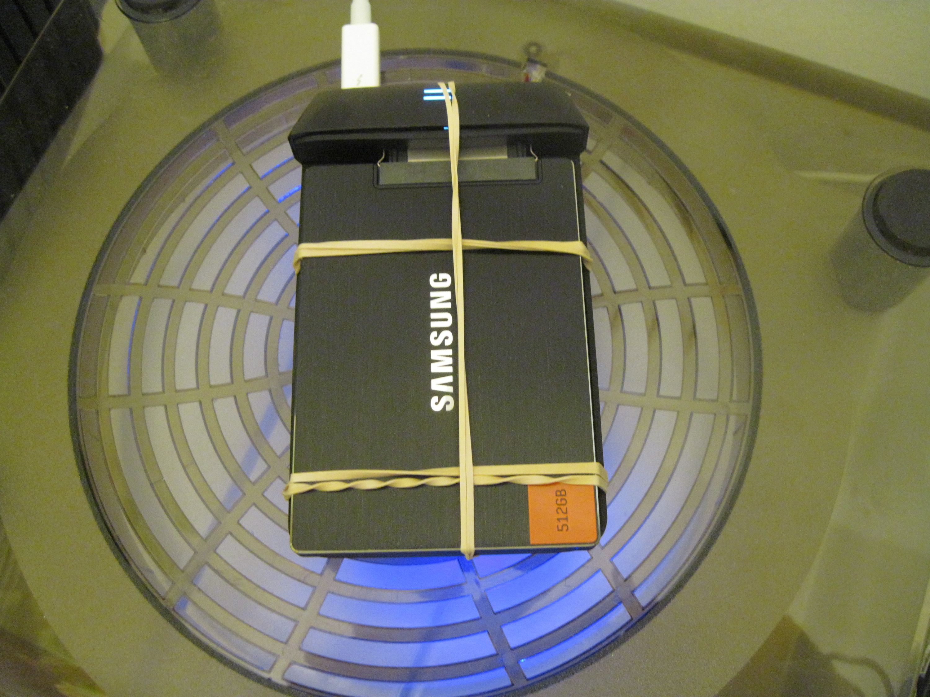

you are welcome here is the black magic for the samsung 512gb series 830.
this test is with ( mac mini ) > ( Lacie )> daisychained to > ( seagate 512gb samsung ).
very good scores but it is passing through the lacie LBD. 357 read 296 write. I will test with a direct connection later today.
I have a problem testing with a direct connection may be due to different lions 10.7.2 on the mini's hdd does not allow the samsung to test. but 10.7.3 with the lacie as the boot drive allowed a test. it will take a while to do an update.
the 10.7.3 was used to format the samsung. and the 10.7.3 was used to test the samsung and that test works. so if I pull the lacie (which has the intel 10.7.3 osx) and use the internal hdd which has the oem 10.7.2 osx the seagate does not see the samsung. In fact the samsung drops its connection.
I am going to clone the lacie LBD with the intel (10.7.3) to the internal in the mini.
Then pull the lacie out boot with the updated internal and I hope it works. this will be late tonight at best most likely early on fri.
I know some people have had a few issues with the 10.7.3 not working with everything. it could be the formatting is not backwards compatible to 10.7.2 I hope!

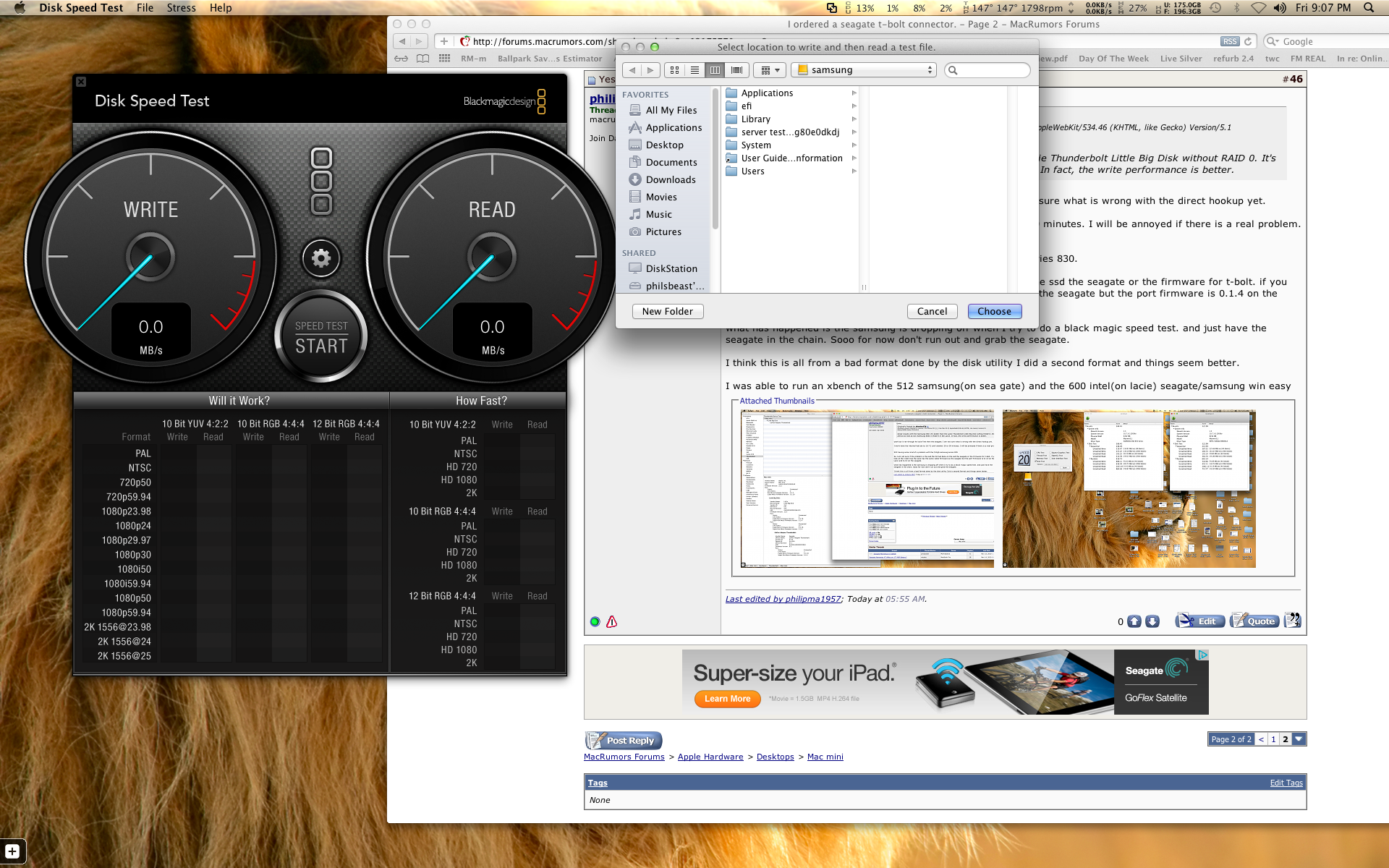

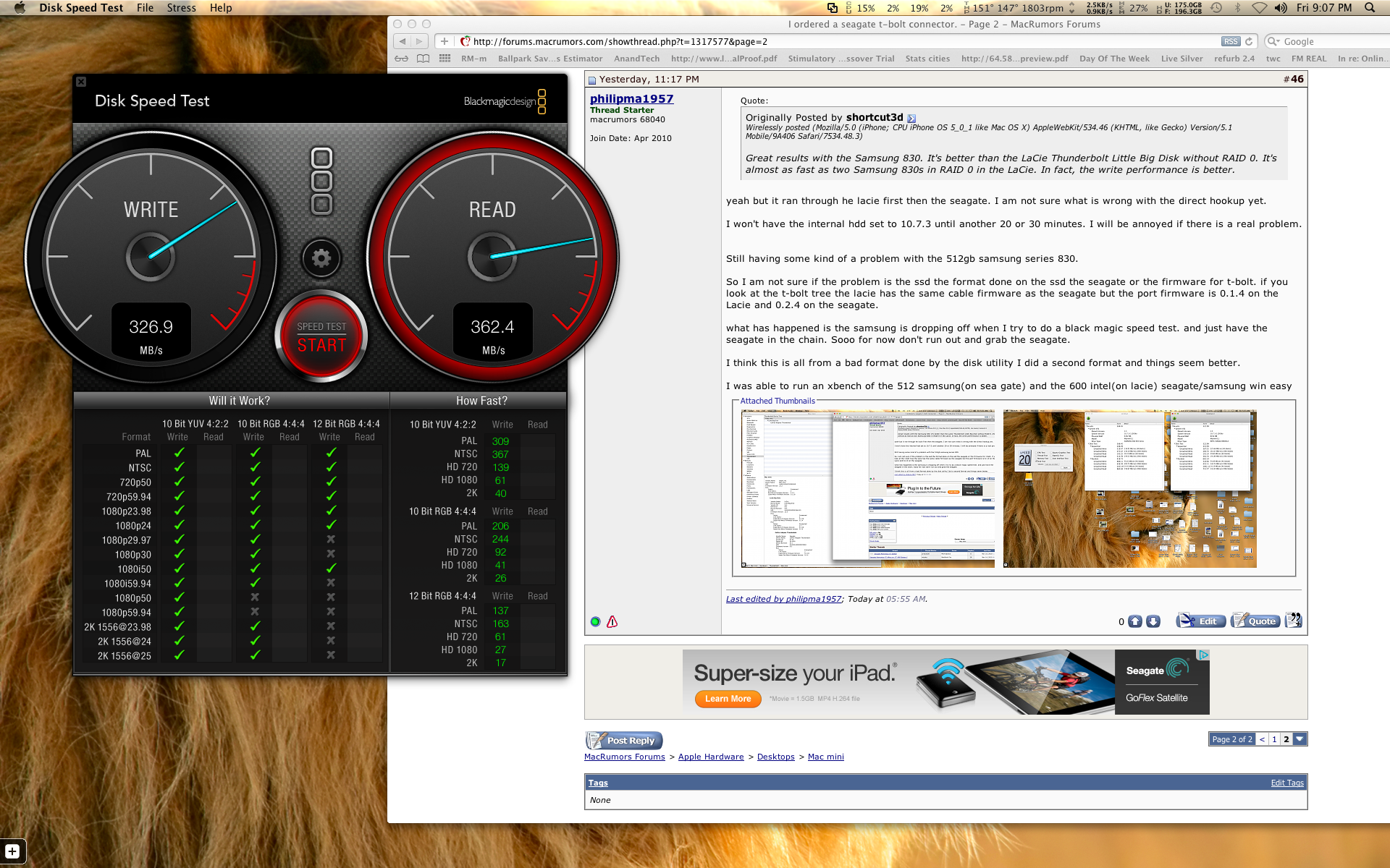

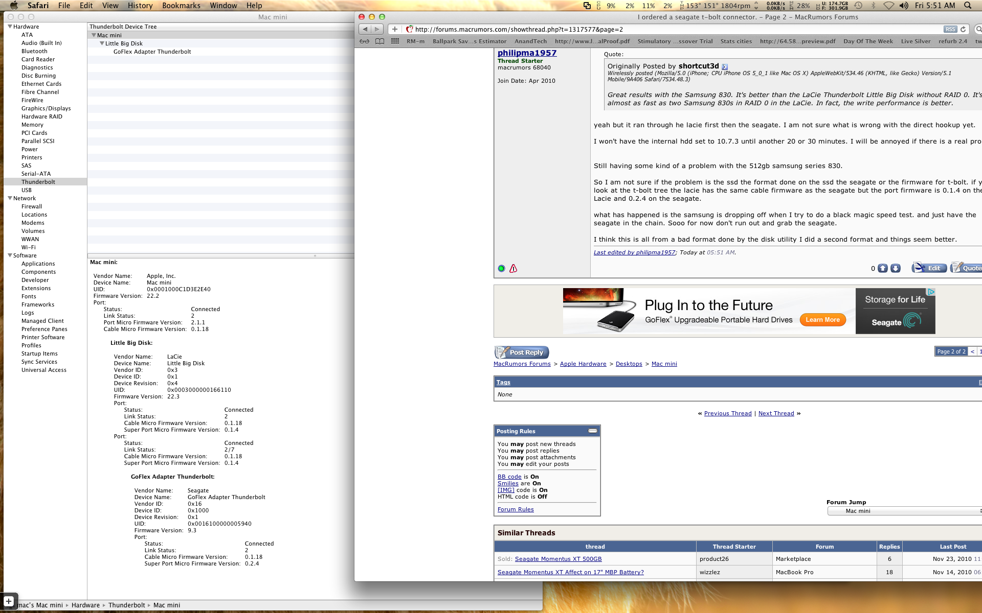

Still having some kind of a problem with the 512gb samsung series 830.
So I am not sure if the problem is the ssd the format done on the ssd the seagate or the firmware for t-bolt. if you look at the t-bolt tree the lacie has the same cable firmware as the seagate but the port firmware is 0.1.4 on the Lacie and 0.2.4 on the seagate.
what has happened is the samsung is dropping off when I try to do a black magic speed test. and just have the seagate in the chain. Sooo for now don't run out and grab the seagate.

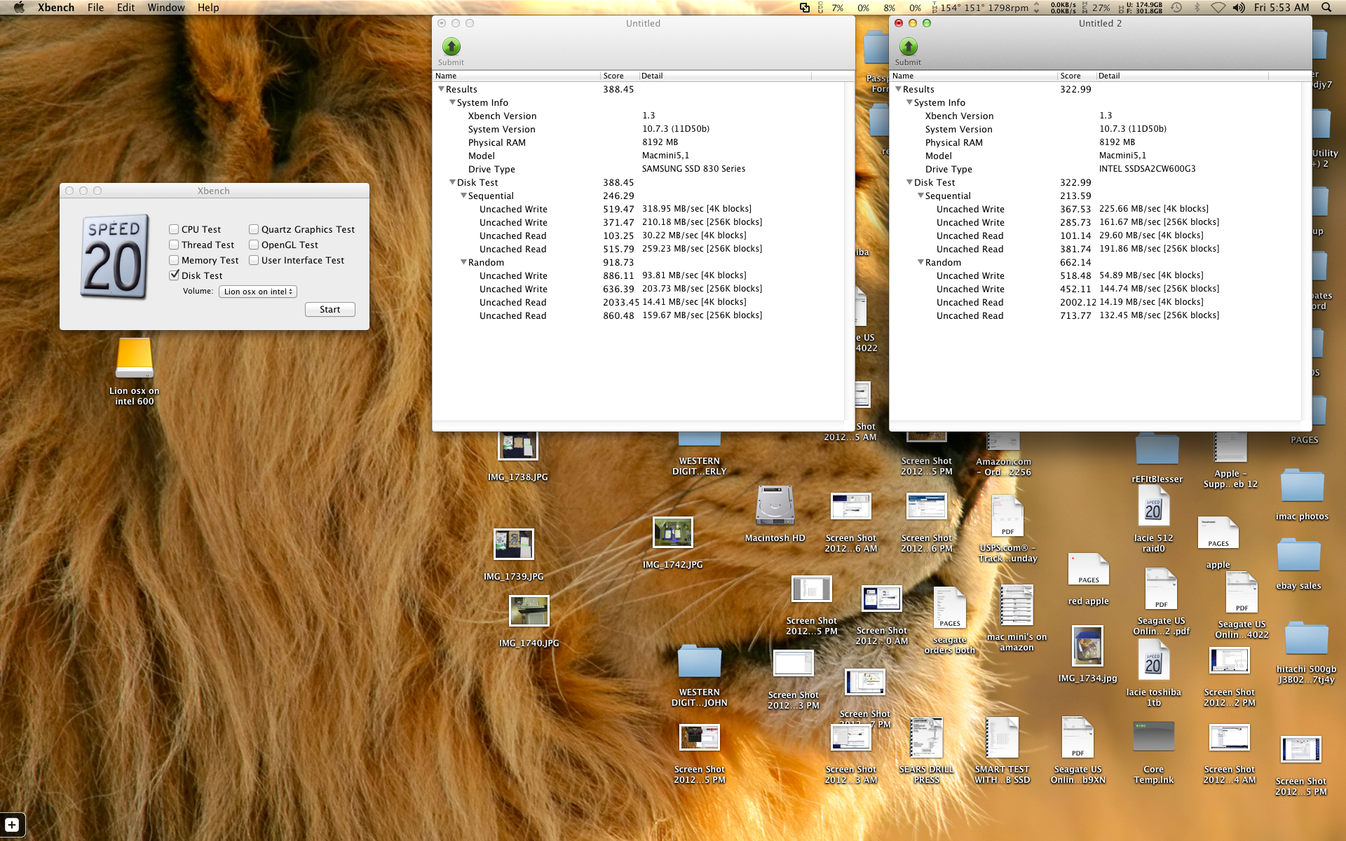

I think this is all from a bad format done by the disk utility I did a second format and things seem better.
I was able to run an xbench of the 512 samsung(on sea gate) and the 600 intel(on lacie) seagate/samsung win easy.

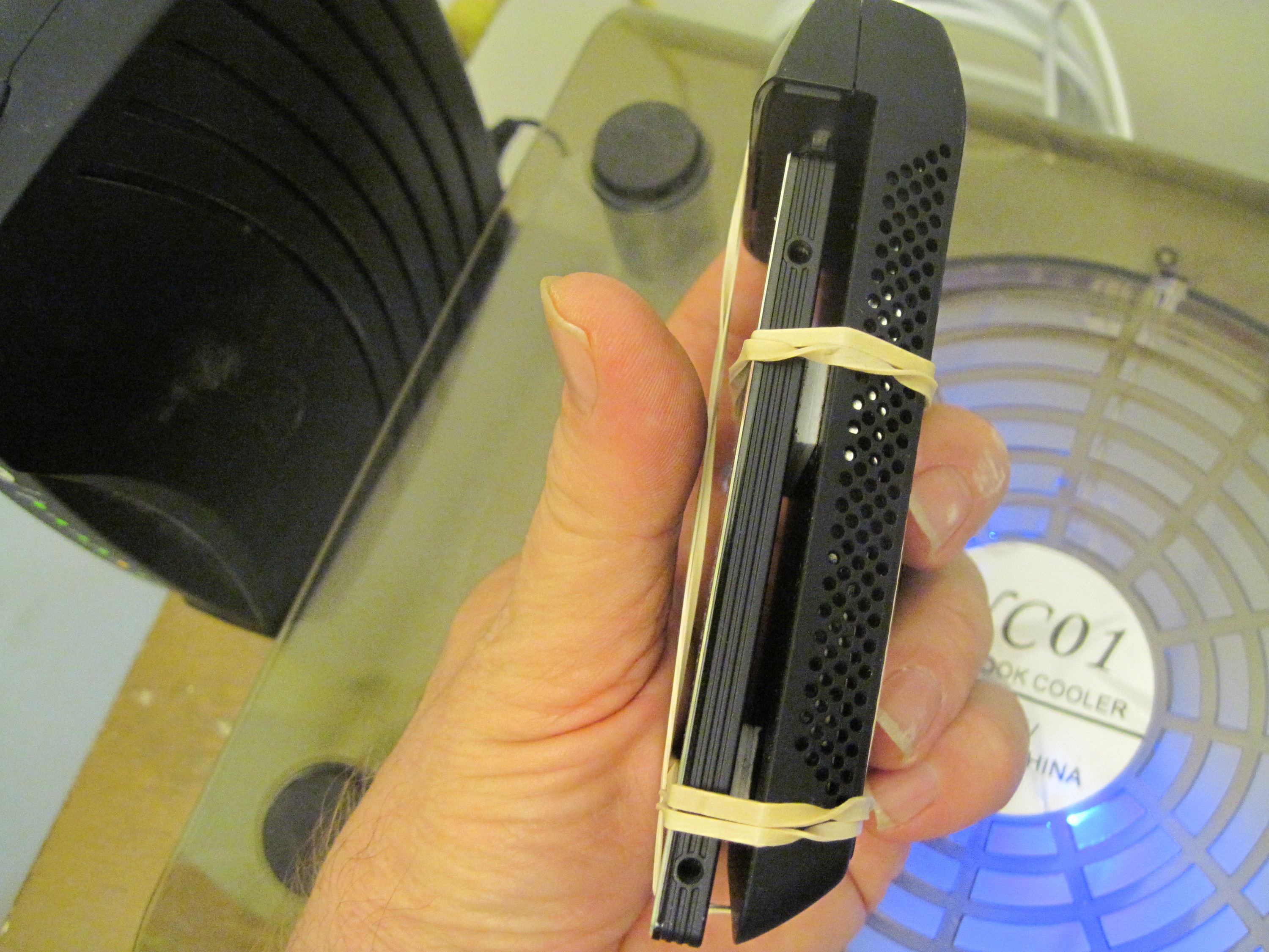

it took me a long time to figure out the problem but I did. here are black magic tests for the
samsung
mac mini> seagate direct all bus power. 360/ 320 really nice scores.

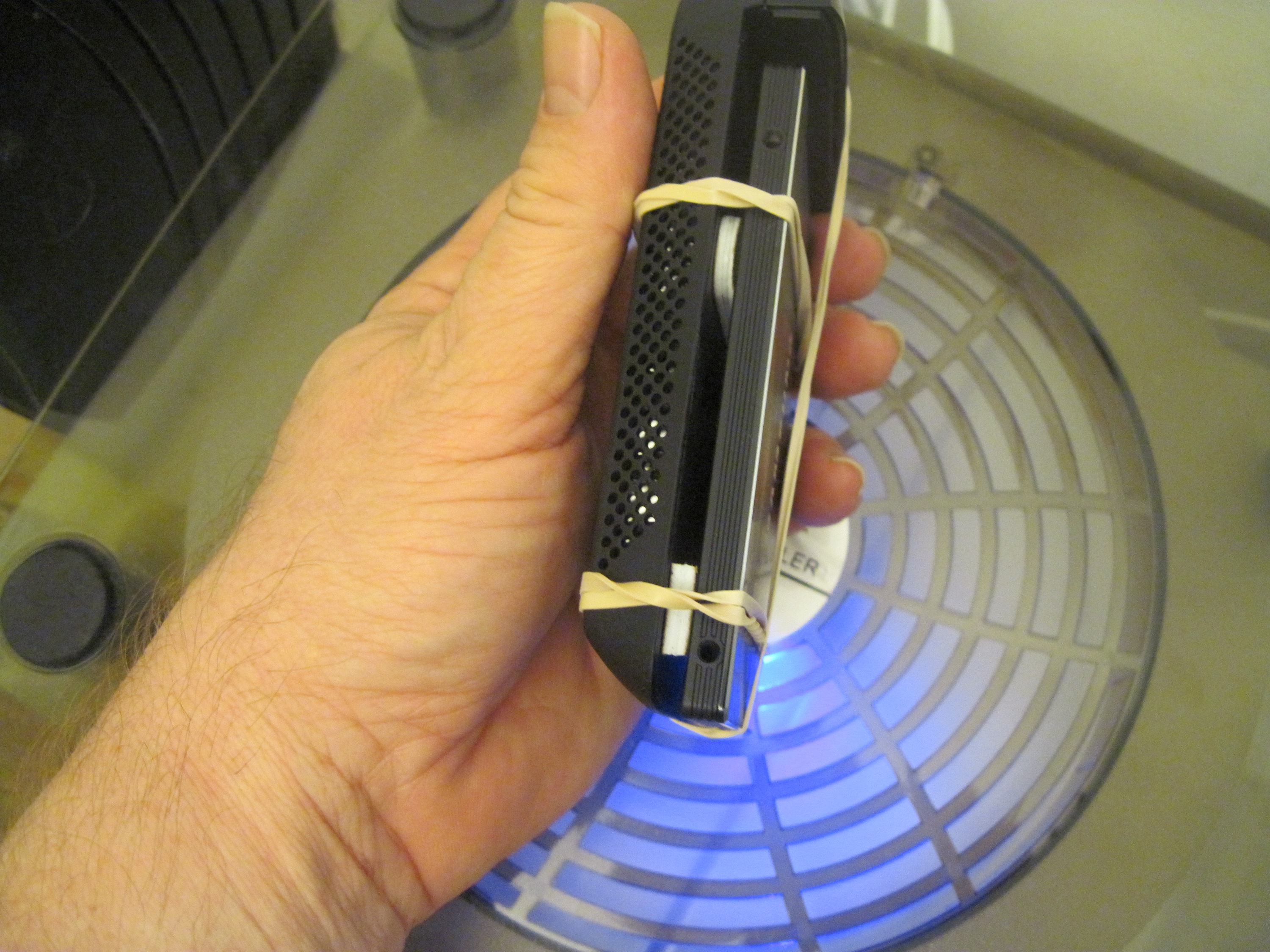

What about flipping the Seagate GoFlex Thunderbolt adapter over so the drive is on the bottom? Will that improve stability of the connection?

yeah but it ran through he lacie first then the seagate. I am not sure what is wrong with the direct hookup yet.
I won't have the internal hdd set to 10.7.3 until another 20 or 30 minutes. I will be annoyed if there is a real problem.
