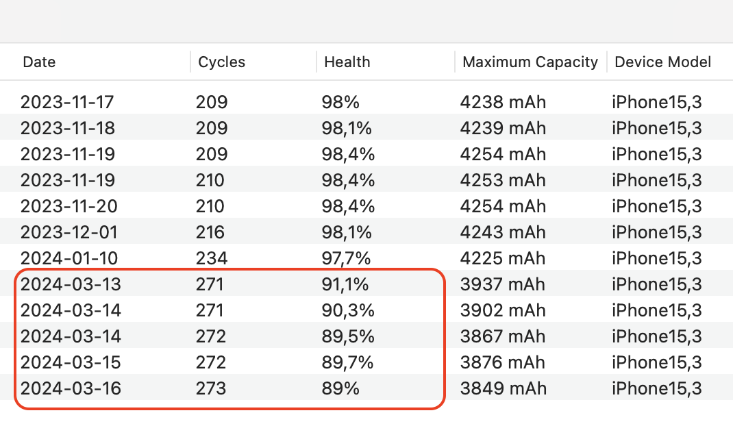

Hi all,
I pampered *) my 14PM battery from the day I bought it (jan 2023). Battery health was still at 98% one year later, but over the past few weeks it suddenly dropped to 95 -> 91%. Is this common for this model?
*) Treatment is basically to avoid 0% ~ 30% and 85% ~ 100% as much as practically possible. I did the same with my previous phone, iPhone 8plus, which I bought in 2017. My kid is still using that 8 plus, now seven years on and that battery is still at a respectable 75%.
Any input very welcome. Thanks!

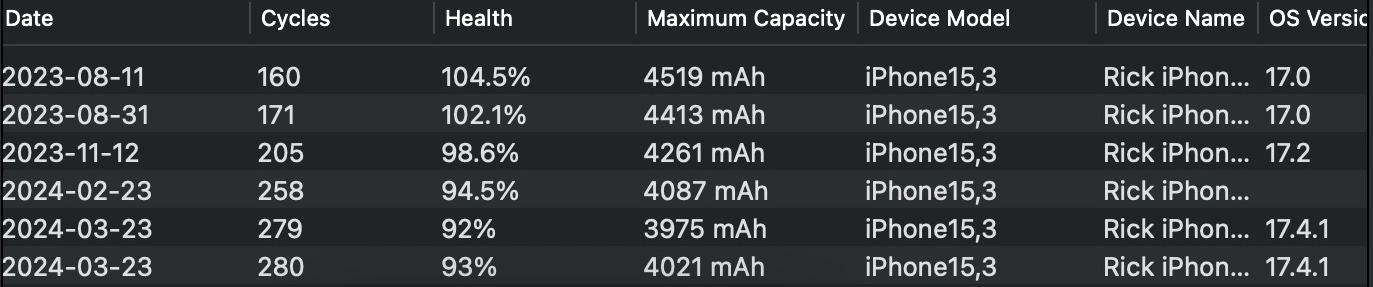

The battery states 100% even though it made be more than 100%. It could have gone from 105% to 98% the first year, and now from 95% to 91%.
This explains why many people can get maybe closer to one years with 100% BH. Many iPhones coming from the factory with more battery capacity mah than stated and iOS works off the min specced battery mah. This is giving more headroom and extra capacity before iOS starts showing the drop from 100% BH.
Eg… here’s my 15 Pro real battery stats from analytics. The original max capacity is higher than the supposedly 3274mah rated from factory (online sources) @ 3366mah and the BH is already dropping based on these numbers.
However battery health in iOS settings will stay at 100% until this drops below 3274mah.
Yep, that's why some people get "golden" batteries and some get "lemons". There is the design capacity, which is how much battery Apple intends each phone to have. Every iPhone will have at least this capacity. Then there is the actual capacity, which is how much battery the phone ships with. The actual capacity will always be at least the design capacity, but due to manufacturing variances, they won't all be the same. So some phones will start at 100% and immediately drop to 99%, while other will start at (e.g.) 105% of design capacity and then go to 104, 103, ... until finally reaching 99%. This misleads some people into thinking their babying of the battery is keeping the health up when it's really not doing much, or you'll have people saying they abuse their battery and the health barely changes. Battery health is also only a best estimate, and Apple may tweak the algorithms used to calculate it over time. IIRC, there was a big tweak they did a while back for the iPhone 14 (?) which really affected what was reported for battery health percentage.

All this aside, my 14PM battery health is declining very rapidly, as days pass I now have 2% off within 3 days. Please have a look at the table below.
If you look at the values at the top of the table, the BH was much more stable through nov-jan: less than 1% over 3 months.
So something seems definitely wrong at the moment.

A few more days in since I started this topic, the battery appears to settle around 90% rather than continue to drop. I'll keep an eye on it though.
Thank you all for your input and for educating me on how the iPhone battery can be over 100% off factory and that it can explain why BH stays at 100% for a long time.
But honestly 80% and 500 cycles seems to me like a worst case scenario. We have employed "sensible battery user management" *) for the last 10 years across 7 MacBooks, 6 iPads and 12 iPhones and we have much better BH performance than 80%/500cycles. See the coconut battery screen shot of an iPhone 8 Plus, bought in 2017, used by myself for 2 years, then passed on to my daughter and it's still at 75% after 1368 cycles. It was certainly much much higher than 80% at 500 cycles (I remember 93% when I passed it on).
