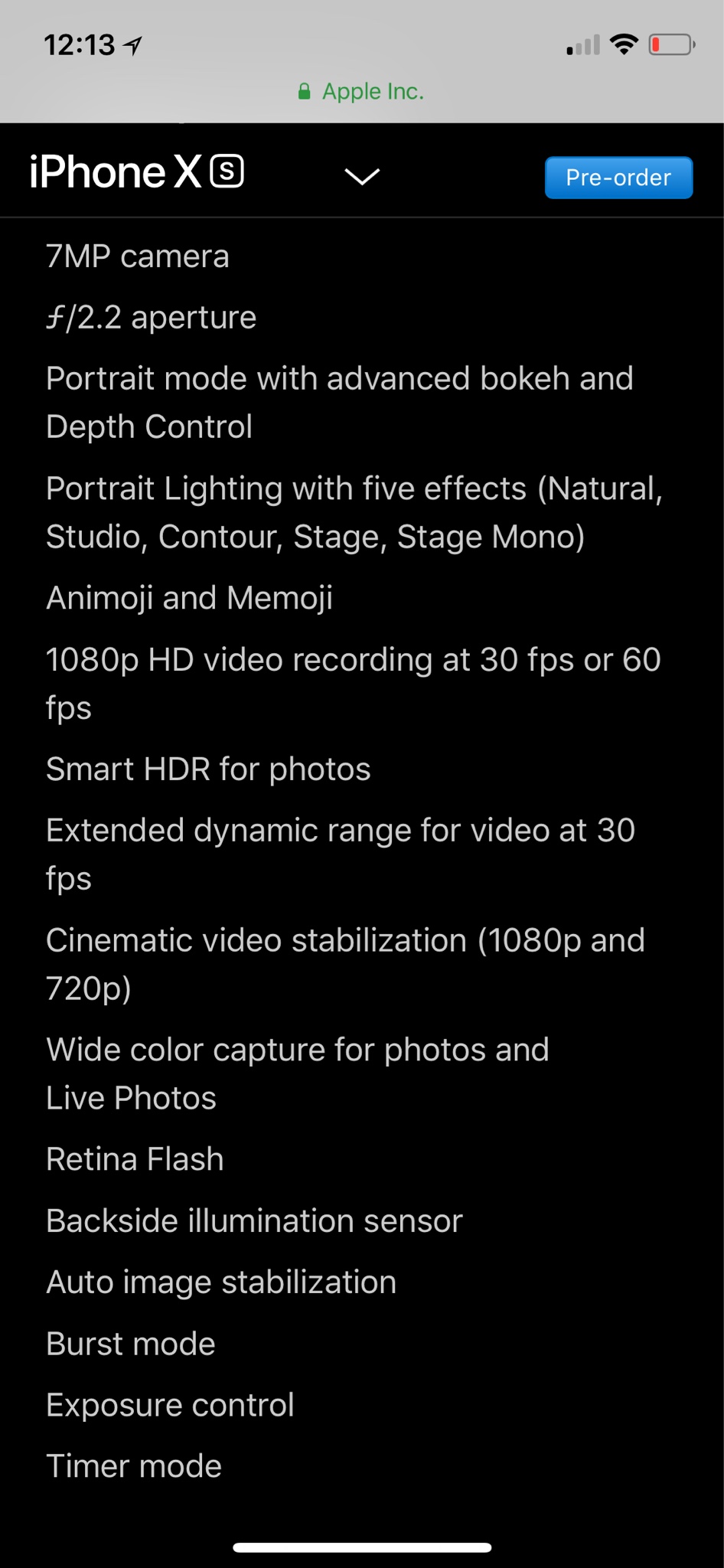

Isn’t the iPhone X just f/2.2?
No wide angle? So then the iPhone Xs will capture more on the sides right?
Call me stupid but I MAY UPGRADE for this feature...
Depends on how much I can get for my X
Where does it say wide angle?
It's called a wide-angle lens to make distinction from the telephoto lens. It does not suggest that the focal length is smaller than the previous generation. It it were, the actual focal length would have been noted in the specs.

Well what I’m saying is that will the new Xs show more stuff on each side of the photo than the X.
Like if you got me and my buddy in the selfie on the iPhone X, would the Xs include the trees and bushes next to me since it wide angle. Like it captures more stuff on the sides (hence WIDE angle)

And I'm saying that, no, it is not likely that this would happen.
In photography, "wide" lens generally refers to a lens with an equivalent focal length less than 35mm. iPhone X's rear wide camera has the equivalent focal length of 28mm, while the front camera is 32mm, both qualifying for the "wide" moniker. Competitors have used lenses with shorter focal length, but it still doesn't mean Apple doesn't get to call the iPhone lenses "wide". Thus, you should not assume that the cameras on the XS became "wider" just based on the spec sheet describing the lenses as being "wide".
It’s a 32 mm (full frame equiv) focal length lens, same as in the X. That’s considered “wide angle” btw.
[doublepost=1537167036][/doublepost]The two rear cams are 28mm (full frame equiv) and 52mm. Same as the X (regarding the focal lengths).
Everyone calls the 52mm (full frame equiv) a tele lens but in the world of photography it’s just a “normal” focal length lens. Similar to the same fov as the human eye.

The X has a selfie lens with a focal length equivalent to a 32 mm lens. That would be considered wide angle.
So, move along. Nothing to see here.
Quick q:
When you say 32mm lens, does that mean the camera captures a photo 32mm wide? That would be only 3.2 centimeters
I guess what I’m trying to understand what determines how much you get on the sides.
Like if I had a 42mm lens or a 52 mm lens I’m assuming I’d get more in the selfie on the sides than a 32mm lens.

The mm number for the lens refers to the focal length, not the size of the photo. The smaller (hence shorter) it is, the wider (field of view, that is) it is. You might want to take a look at this table.
http://www.jeffreysward.com/editorials/lenscov.htm
The "long (36mm)" value shows how "wide" in terms of angle that a photo will cover when shooting with a lens of certain focal length. You'll notice that the 28mm lens can do about 65 degrees, while the 32mm one can do about 59. That 6 degrees difference is why I shoot selfies with the rear camera, personally.
That’s not the size of the photo the lens captures. It’s the focal length and less (like say 25mm) is wider than more.
Why Apple doesn’t use a wider lens on the front no one but Apple knows.
One thing for sure, a wider lens distorts a person face more (for example makes their nose and forehead look too large) when used close to the person ( like a arms length selfie)
