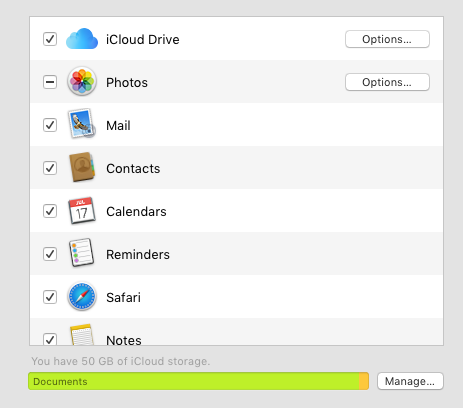

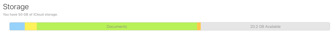

Ho hum, very odd. Could you open your Mac and throw on System Preferences> iCloud> Manage (located at the bottom right). I'll show you mine, you show me yours. 😉
Am I right in saying that yours shows something similar, but the numbers on the left don't add up and storage is somehow over?

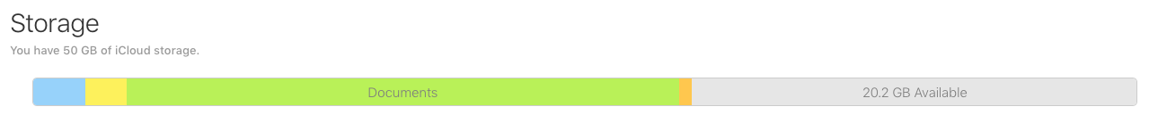

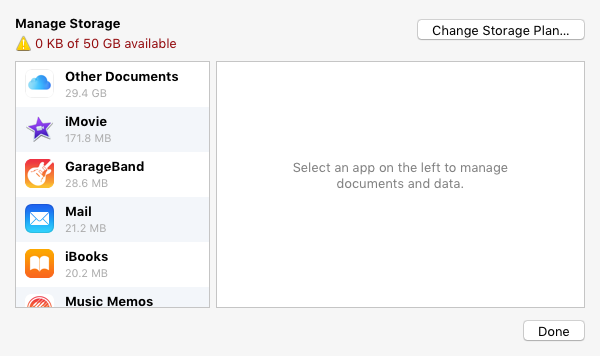

Here it is, rather odd alright.
Actually thinking about it more I have a suspicion. Could it be possible that my entire iTune music library is on my iCloud? It turns out iTunes on my mac said it actually was set up, despite me never seeing it properly complete. That is roughly about 30GB. But I turned iCloud Music Library off on iTunes now, and it was off on my iPhone and yet the problem still remains.
As you can see below, it doesn't seem to add up. (Note: My iPhone reports that the figure is 59/50GB, suggesting around 29GB of unaccounted usage.)
As you can see below, there is around 29GB unaccounted for.

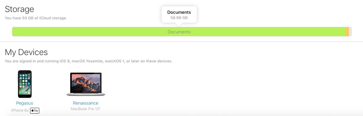

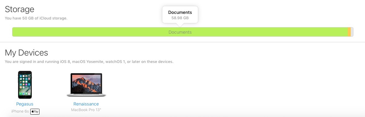

If not, could you go to www.icloud.com and sign in, then go to Settings – how does the storage break down there?
Pretty much the exact same story as given on my iPhone.
Man that is weird. The only thing I've found out based on the names of your devices is that you're a Battlestar Galactica fan. If I'm off the mark with that one too then I really have been 100% useless today. 😀
I'm afraid I'm out of ideas, really sorry about that! It may be worth speaking with Apple Support if you haven't already?

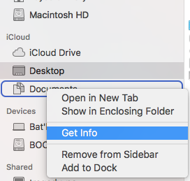

OK wait, let's try one more thing. Call it a desperate flash of inspiration as iCloud.com is showing it all used up by Docs. I imagine iCloud is backing up your Desktop & Documents from your Mac. Has there been anything enormous that's found its way onto your Documents or Desktop?
What does the Get Info on your Mac look like? If it is backing up through iCloud, it won't be visible through Macintosh HD> Users, so you'll need to check from the sidebar instead.
If that all looks OK, how about we sign back into iCloud and then disable iCloud Drive/Documents? It might take quite some time to unsync mind you, as it'll have to copy from the cloud back to local... but maybe that might do the trick.

I've been waiting around 48 hours now and the issue still remains.
Contacted Apple support today after scheduling a phone call with them yesterday.
Apparently there is a rare issue where iCloud allocates space for a backup/music library or something like that an then because of some coincidental error that occurs in the middle of the process, forgets to let go of that space even after you cancel those files being kept in the cloud.
So this is what was wrong and they were able to explain the issue and rectify it pretty much straight away. Anyone else experiencing the same issue just needs to schedule a free call with Apple support and let them know you're having trouble.
It's working now again, and I am only using up the space I am actually making use of!

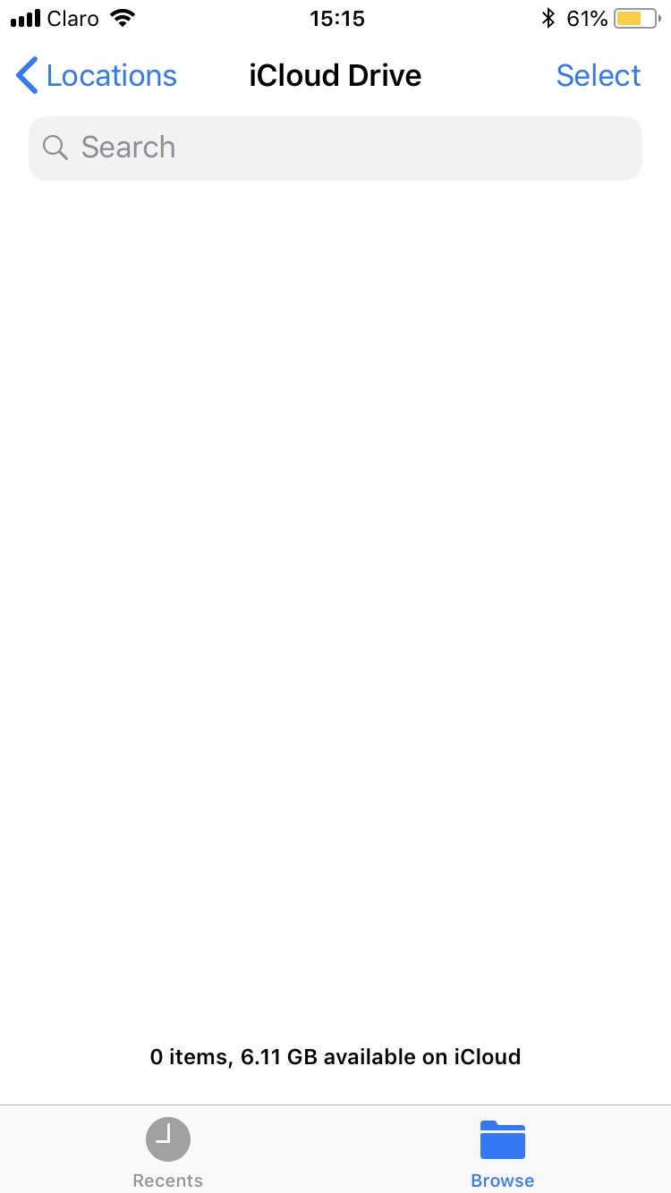

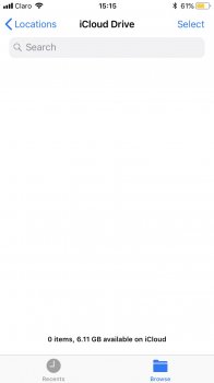

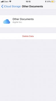

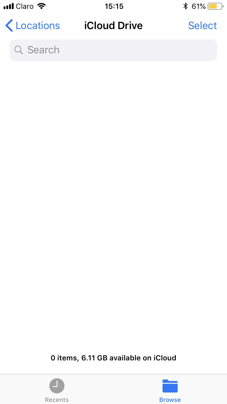

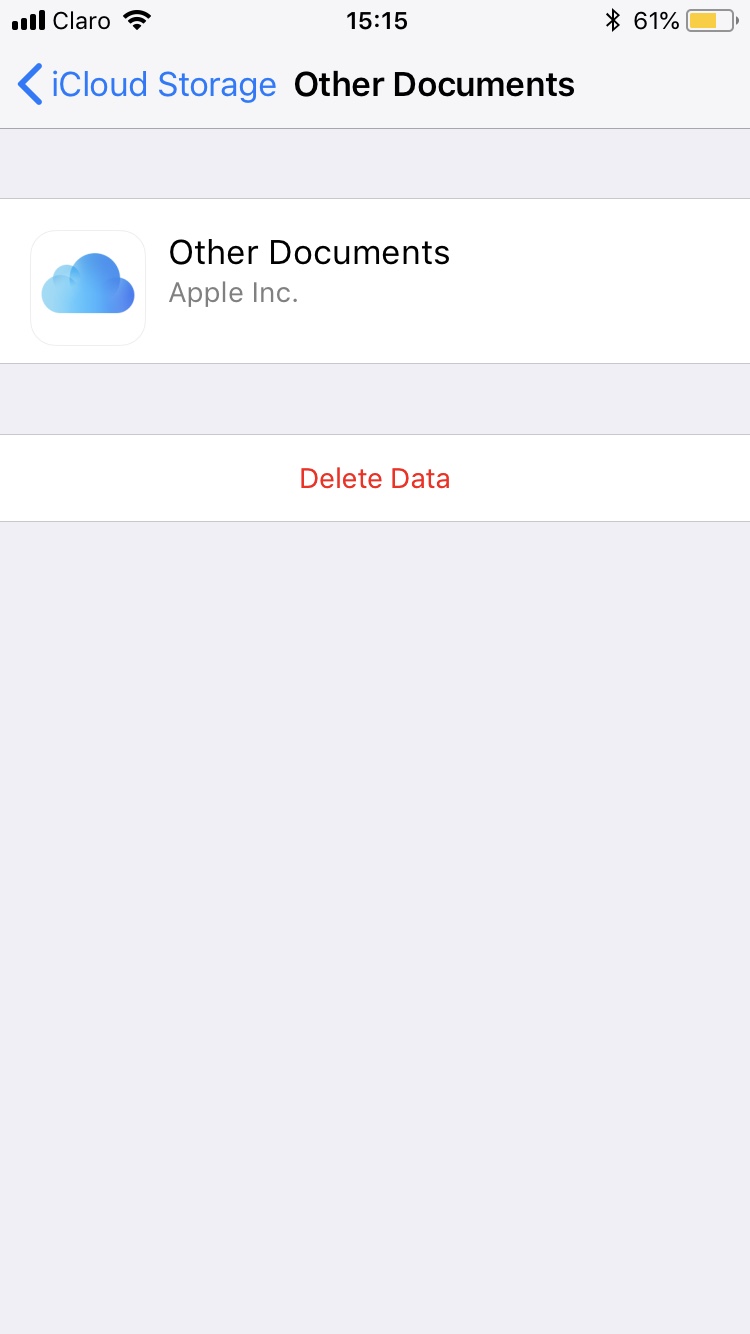

Same problem here! Documents folder taking up 27 GB but there are no files at all on the folder, completely empty! Apple Support told me they had to escalate to Engineering, but no response at all so far. Trying to delete documents from the "Manage Storage" option on iPhone or iPad just does not work at all.
Did you manage to get this issue resolved? if so how? i think i might have a similar issues. Thanks
I did manage to solve it after a lot of calls and chats with Apple Support. First level analysts won't even understand the issue and will classify it as a Mac or iPhone problem, you have to clearly state that it is an iCloud Drive problem, not device-related.
Second level analysts, or senior analysts, will somehow try to understand the problem and with efforts from you they will, at some point. Then they will realize they cannot solve the issue and then they will escalate the problem to some sort of Engineering Department. If your lucky, the escalation thing will clearly request for "wiping the iCloud Drive folder" and Engineering will do that. If not lucky, Engineering will come back with some dumb procedures as guaranteeing that you iCloud Drive is empty.
Reactions: Jasd

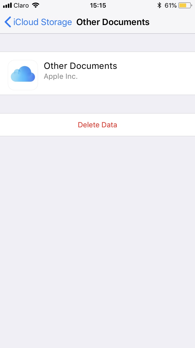

For my situation, it was a little easier to solve. My iPhone was giving me a daily error: "This iPhone cannot be backed up because there is not enough iCloud storage available." Looking in iOS on my phone and in icloud.com, it showed only 3.1 GB of 5.0 GB used, so I was confused. In iOS going into Settings:AppleID/iCloud (very top):iCloud:Manage Storage, under the list of how much space each app was taking up, "Backups" was 1.5 GB. Again, this seemed reasonable and to fit in my iCloud. But if I clicked that Backups button/ right arrow, "This iPhone" showed that my last back size was 1.61 GB but my Next Backup Size was going to be 4.12 GB. Further down that page under "Choose Data to Back up" the culprit was my Photo Library which was almost all of that 4 GB. So I synced my phone to my computer, downloaded my photos/videos, then deleted most of them from my phone. Then the backup worked.
So I had to go into Backups to see the next backup size planned to know where the problem was.
