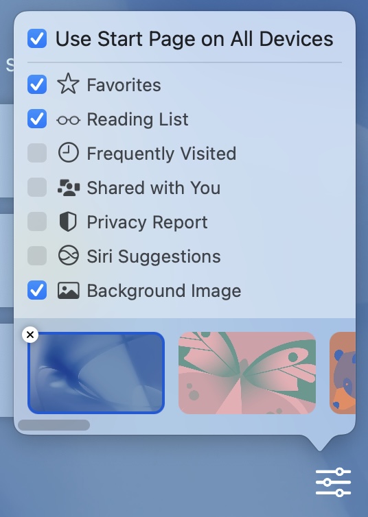

I can't figure this out, but now the option to show iCloud tabs has disappeared entirely from the Start Page menu of Safari on my MacBook Air. (And, yes, I have the Safari box ticked in iCloud preferences. Haven't changed anything there.)
On the Mac, the checkbox only shows up if there is currently an iCloud tab visible. If not the checkbox won’t show up. In iOS the checkbox will always be there.
Got it. Thanks. ..Although I have a bunch of tabs open on my iPhone, and Safari turned on for iCloud sync there. So I should have iCloud tabs available.
iOS Safari won’t push out iCloud tabs until you exit back to the Home Screen. If you’ve done that, then try rebooting the iPhone and logging out of your Mac (don’t need to reboot) and back in.
If it’s still not showing up, you have an iCloud issue.

Thanks. You inspired me to experiment. Seems like turning my MacBooks' iCloud sync for Safari off and on did the trick; they suddenly populated. Not sure what triggered the sudden failure a few weeks ago, but back in business.
