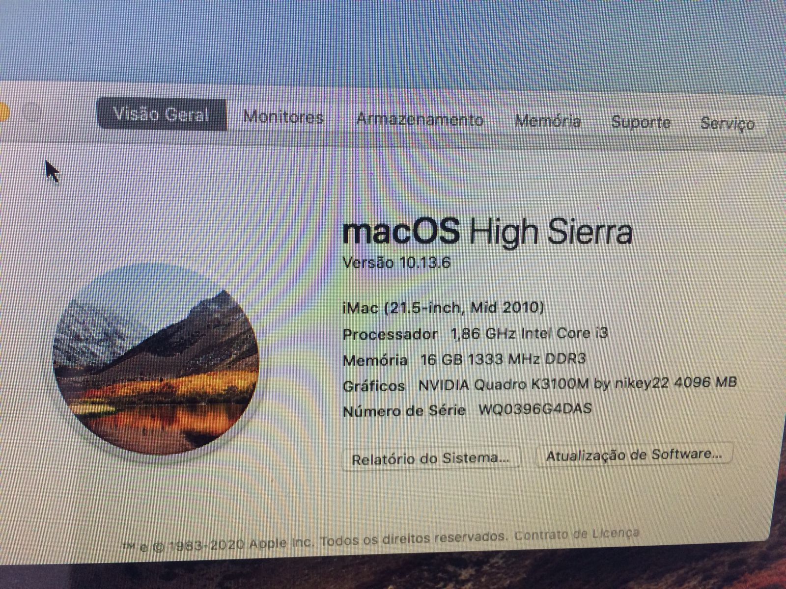

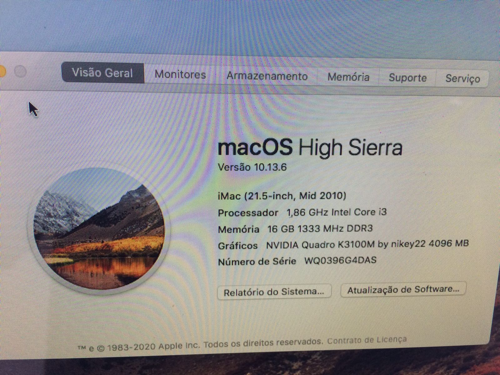

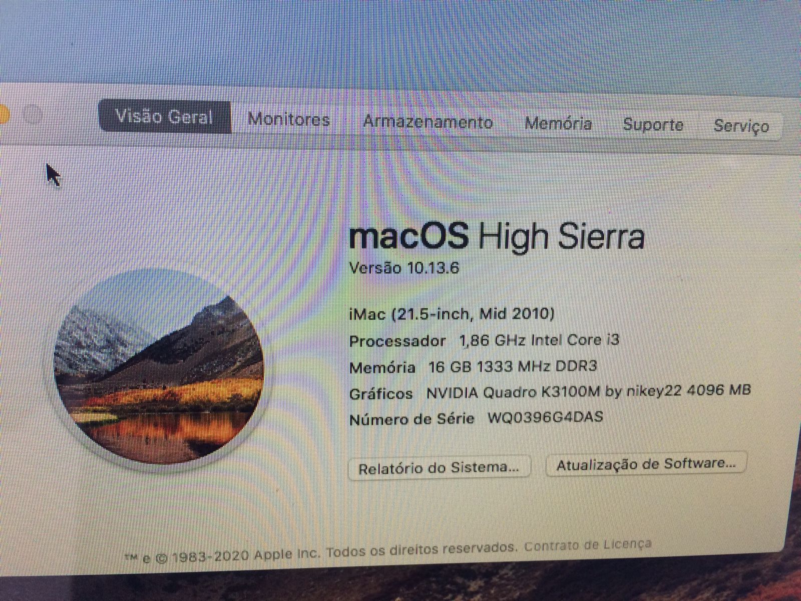

In the exchange of the cpu he did not recognize the Xeon name and recognizes only 2 nuclei instead of 4 nuclei

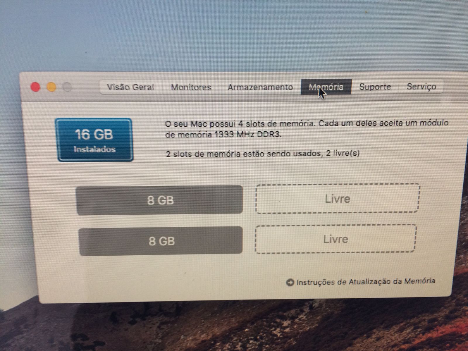

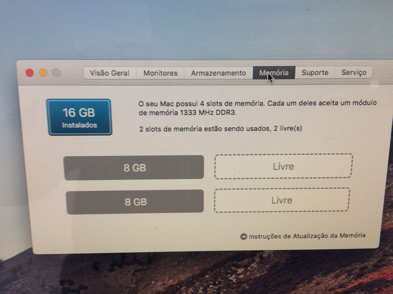

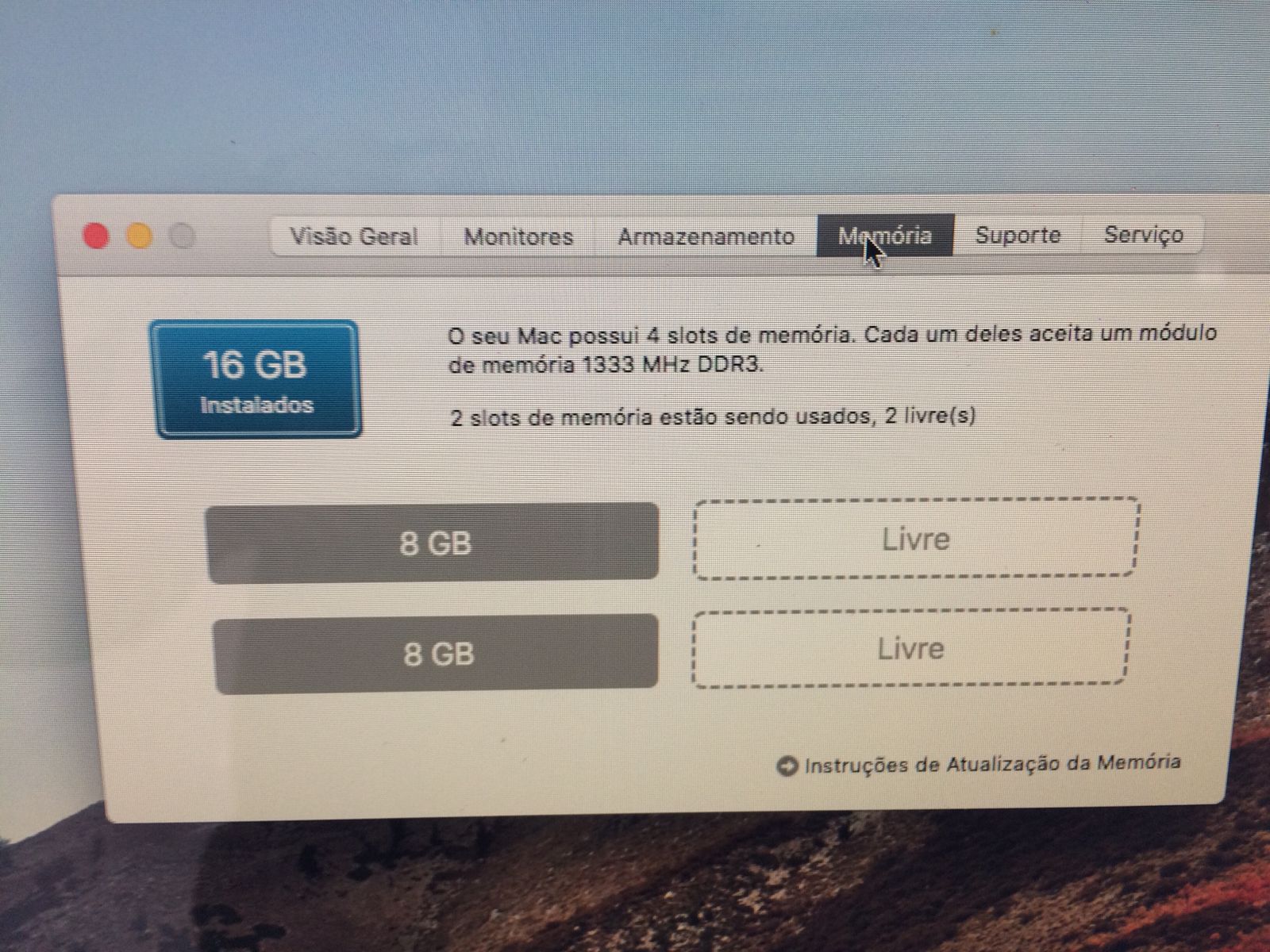

It also does not recognize the 32gb of total ram, it recognizes only 16gb (two combs on the right side)

Suggestion:
Replace the Xeon with a Core i7-870 and your RAM and cores problem may be solved.
