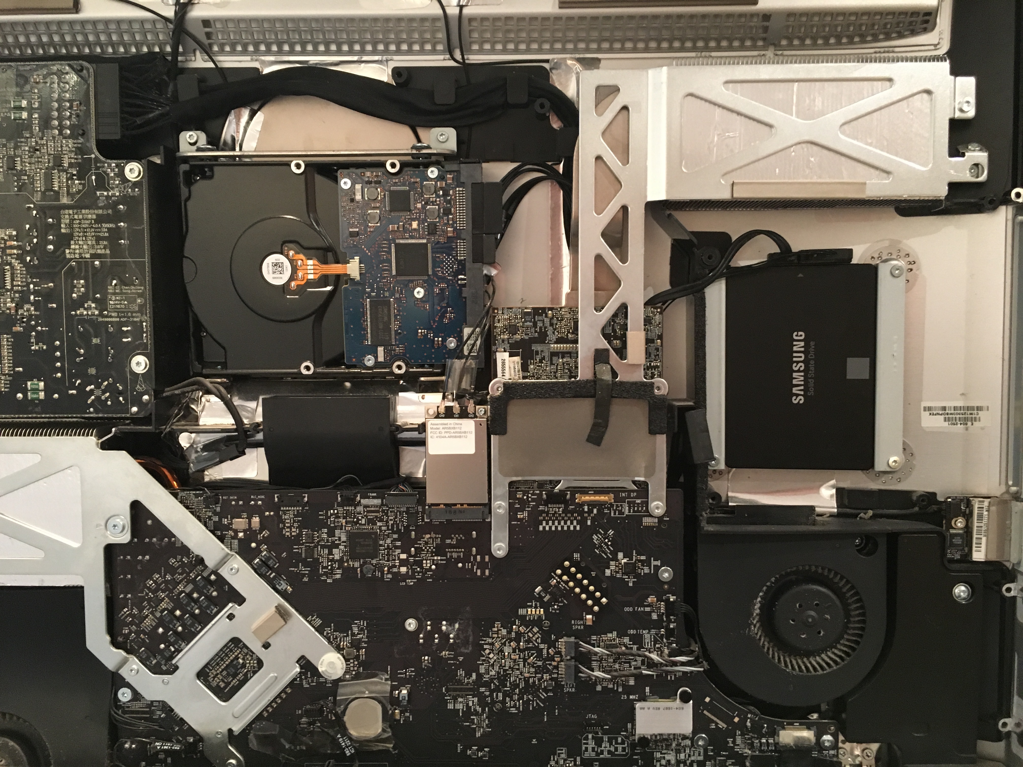

Hi guys! Thought I'd post this here since there's little information about this exact procedure. Today I proceeded to swap the original Apple TS256C 256GBSSD with a Samsung EVO 850 250GB in my iMac 27" mid-2011 12,2. It's a pretty straight forward procedure and you can follow the instructions up to 4:10 in this video. The factory installed SSD lies behind the DVD drive. Once you get there, you simply remove the 3 screws holding the SSD brackets in place. Simply attach those brackets to your new SSD, screw them in place and reassemble the iMac. Before doing it, I wasn't sure if I would have to take out the logic board but there's no need to.
Next time you reboot, enable TRIM support by going in the terminal and typing: sudo trimforce enable and follow the instructions until the computer reboots (it takes a little while).
The performance difference is pretty noticeable on boot and application launch times, as well as when user switching. Xbench showed 100% better score than stock SSD and Black Magic reports around 495 MB/s write and 505 MB/s read, up from 120 MB/s write and 200 MB/s read. Very glad with the upgrade and hope this can help someone. Attached is a picture of the installed SSD before reassembly.

Indeed, I've got the BTO 256GB SSD plus internal 2TB HD and they're both still going strong. I hadn't thought about upgrading the SSD -- thanks for the suggestion and the instructions.
Same setup here. Truth be told I didn't plan to do this at first but I'm glad I did, gives a good little boost, and it was quite easy. If you ever do it, be careful with the top left vertical sync connector, the wires are tiny and easy to break, thought I did for a second. And aside from a good Torx kit, you need a suction cup to remove the glass panel. I used the one from a windshield mounted iPhone cradle, worked perfectly. Enjoy!
