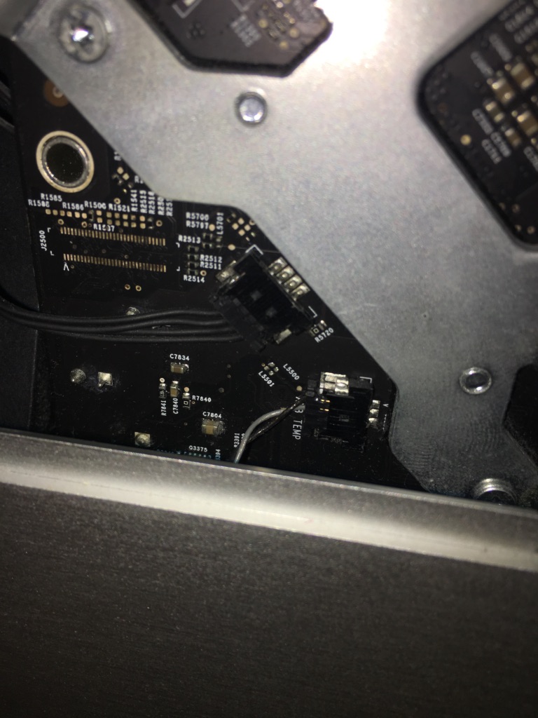

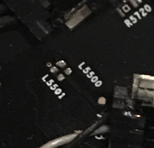

According to this post:
https://www.ifixit.com/Answers/View...ans+after+Dual+Drive+Kit+Upgrade#answer335650
And this photo
yCAJAKwDD1tc1Rtw.standard

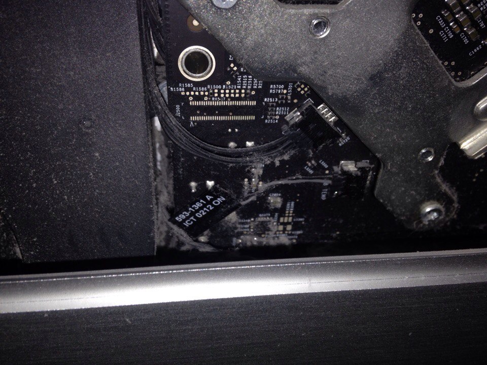

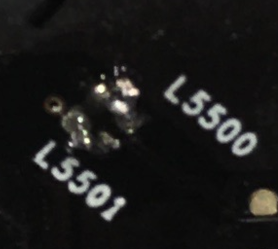

I decided to check the same place on my imac. And that what I saw:
So I took soldering-iron and tried to fix it by connection circuits lanes:

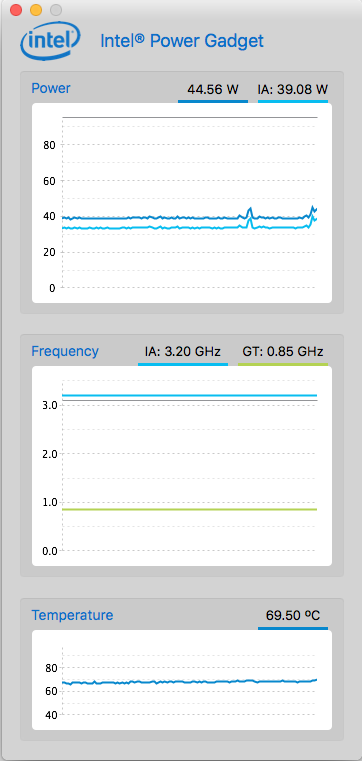

I it works! Now CPU work as it should - on 3,2GHz at the load at CPU\GPU fans works properly
Thanks everyone for you help
P.S. I still have problems with HDD fan, because I use not an apple hard disk. But it's ok, rmp full controls by Macs Fan Control software tool

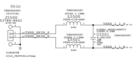

It helps me, but not for a long time. At next day the problem came back. It still a permanet 1,6ghz clock speed :( Maybe problem in a poor quality of soldering.
I have this problem too
before
after
scheme
It works on a half of clock speed
What would you recommend? to resolder or solder a ferrite
Hi everyone!
I have the same problem with the L5500 and L5501 ferrites. I took soldering-iron and connected the both circuits too, but now instead a TA0P error I've got TS2P error. Fan still faster and CPU clock remains at 1.6ghz. Could someone help me with that?
Thanks a lot!
I too also have this same issue. I took my board out to replace the gpu and one of these little ferrite pos fell off. Seems like it was designed to do that!
I just ordered a replacement board. Not sure how you guys are so talented at soldering you can connect that. I can barely see it let alone can figure out the right combination of tools to get it to work.
If someone wants to give it a try I will ship my board out to you, Send me a message with your info.
Thank you

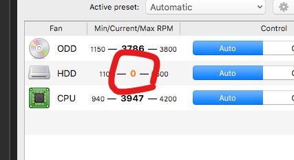

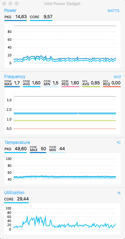

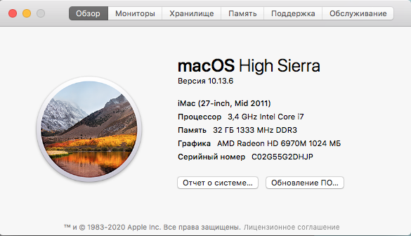

Hello everyone!
I'm facing a serious issue with my iMac 27" from 2011 and can't seem to find a solution. Here are the main problems:
- All fans are running at maximum speed.
- The CPU is throttled to 1.7 GHz.
- The GPU is running at only 20% of its capacity.
- After waking up from sleep mode, everything works normally for about 10 seconds, but then the problems come back.
Here’s what I’ve already done:
- Replaced the CPU (with an i7).
- Replaced the logic board.
- Installed new RAM.
- Replaced the SSD (from a Samsung 840 EVO 500GB to a Samsung 870 EVO 1TB).
- Installed a special temperature sensor for the SSD.
- Reinstalled macOS High Sierra.
- Reset NVRAM/PRAM and SMC multiple times.
I’m using *Macs Fan Control* and *Intel Power Gadget* for monitoring, but nothing changes: the CPU stays at 1.7 GHz even under load, and the GPU runs at minimal capacity.
Has anyone encountered a similar issue or has suggestions on what else I can try? I would really appreciate any advice or help! Thank you!

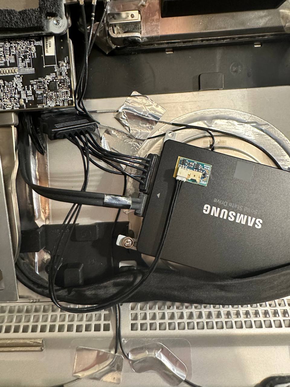

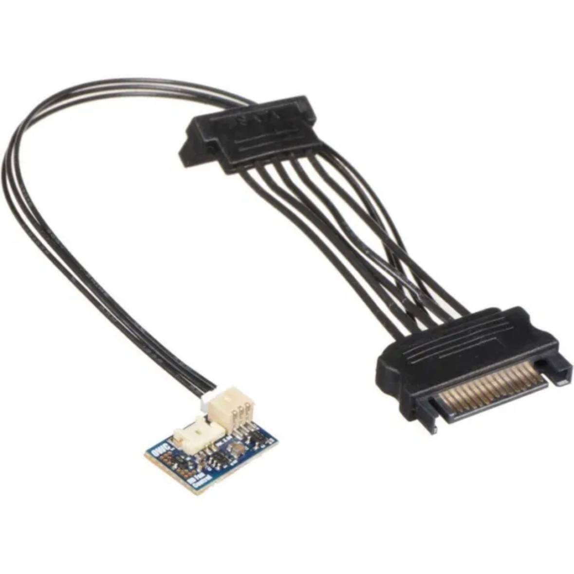

I installed a new temperature sensor for the SSD two days ago, but unfortunately, it didn’t make any difference.
I guess according to iFixit, but in my late 2009 I just used a temperature sensitive resistor I was send from a technician and plugged the legs directly into the plug. It worked fine.
Is this method with the temperature-sensitive resistor an alternative to the SSD temperature sensor shown in the photo above? Could this be used to replace the standard sensor in my situation with the iMac?
Yes. Not sure what you mean by standard sensor. I did the upgrade back in 2011 og 2012, so my memory is sketchy, but as fare as i can recall, the built in harddrive was Apple branded with Apple firmware which transmitted temperature to pins on the harddrive, where this temperature cable was connected. Until I recieved the resistor I just short circuit it, and that also worked fine, but of course cheat the system and never speed up the fans if needed.
Reactions: GidroGen
I installed a new temperature sensor for the SSD two days ago, but unfortunately, it didn’t make any difference.View attachment 2415979
As everyone else the memory is sketchy. Did you install the SSD to its own dedicated connector on the main board (and also have the HDD connected) or did you connect the SSD to the HDD port and remove the HDD?
I had the SSD on its dedicated port as well as the HDD, all was fine until the HDD failed so I removed it then the fans cranked full speed. Evidently apple branded drives send temperature info within HDD data, it needs a drive with their firmware at their price. As I did not need the HDD I did not want to spend on it. That's when I discovered connecting two pins on the end of the HDD cable put it all back to normal.
As I say this is a while back but if you have the above situation I can do some more digging when home see if I can hunt out the info for you. I couldn't just simply unplug the HDD or replace with another brand as the fans cranked.
I think it's this mod.
Reactions: GidroGen

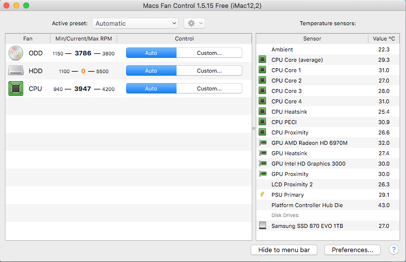

View attachment 2415807View attachment 2415808View attachment 2415809
Something is wrong with your HHD fan or logic board:
This is not a sensor issue. Maybe you damaged something on your logic board?
Reactions: GidroGen
I apologize for the delayed response. I intentionally disconnected it because it makes an unpleasant noise, even at minimal speeds. I had it connected before, but it didn’t solve the problem.

Is cutting the wire an alternative to the temperature sensor I purchased for the SSD?
