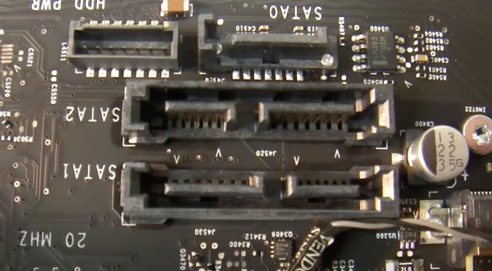

Ive the same model iMac as the OP but borought it as spares/repair it came without an HDD i had a SDD
Question is which port do i use?
SATA 0 (boot disk) - SATA III
SATA 1 (spare or boot disk, does not make a difference) - SATA III
SATA 2 (ODD aka DVD) - SATA II, only
The system walks through the internal SATA ports on the search for a bootable device if no explicit choice has made before (and stored to the NVRAM) and boots in this case from the SATA 0 ports disk taking the first bootable partition.
When you picked in the systems pref pane another disk or partition this one is the first to boot from.

Can I ask is the SATA III SSD Compatible?
SATA is backwards compatible, so you can have a SATA III drive work with a SATA I port or have a SATA I drive work with a SATA III port. It will be as fast as what ever the slower standard is.
As @Ausdauersportler posted, your iMac has two SATA III and one SATA II. If you are just swapping out the HDD for an SSD, that cable would be connected to one of the SATA III ports.
You can use any of them to boot from, it would be faster to use SATA0 or SATA1.
You could also use both in a SW RAID0 set up. This would give you around 900-1000MBps read speeds if using SSDs.
