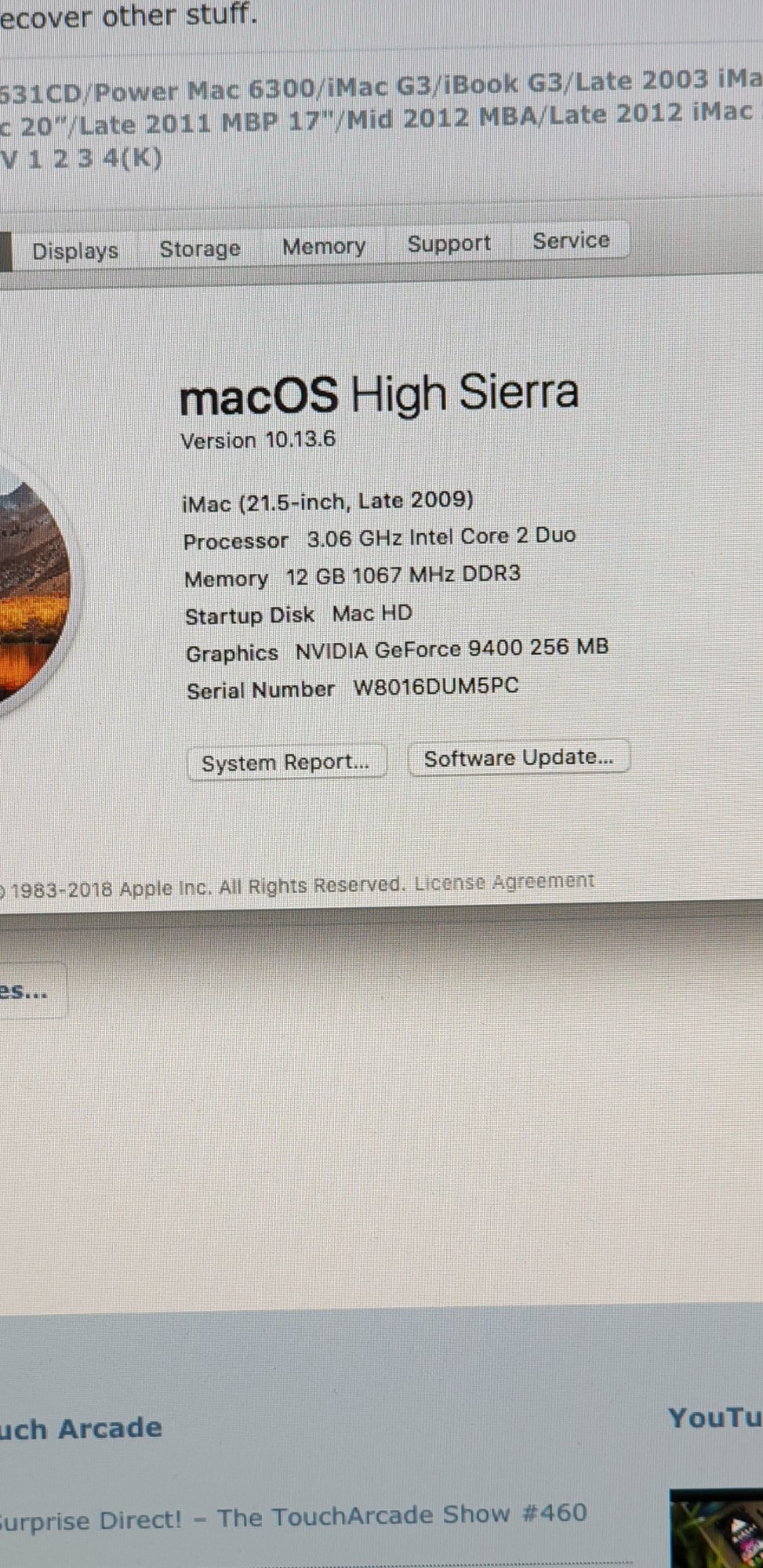

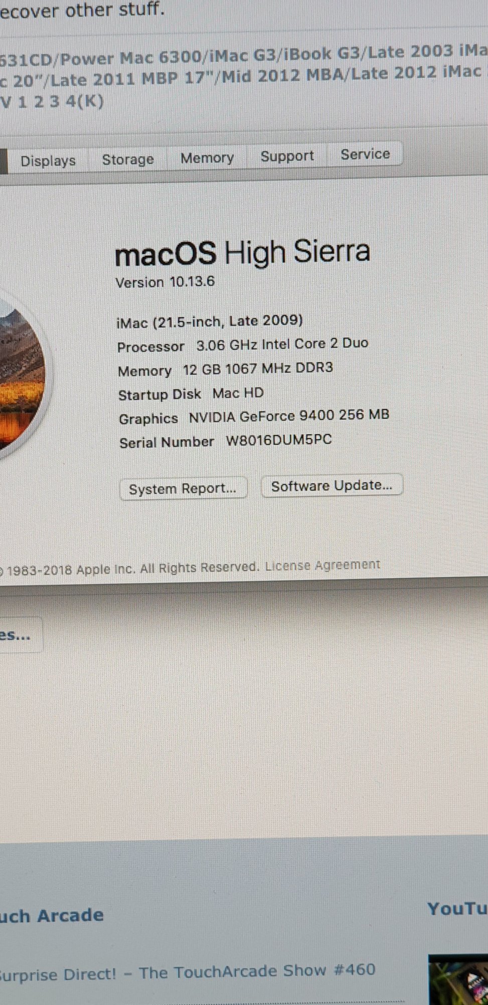

I did post the mac specs earlier for the mac i want to use see attached image
Sorry, I missed it somehow.
You need to use a Firewire 800 cable to connect the two Mac.
On the 2011, boot into Target Disk Mode. One the 2009, you just need to plug it in.
If the 2011 HDD should mount to the 2009 desktop and look like an external drive.
