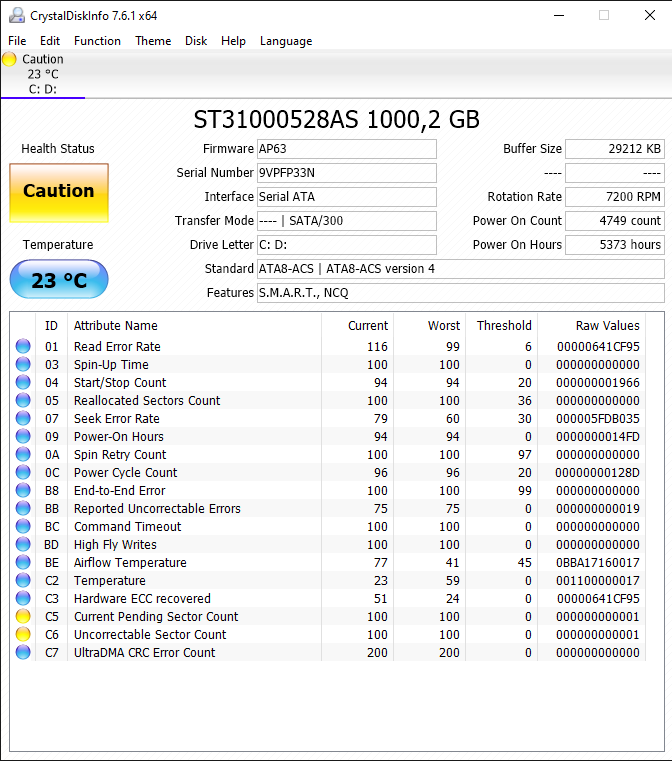

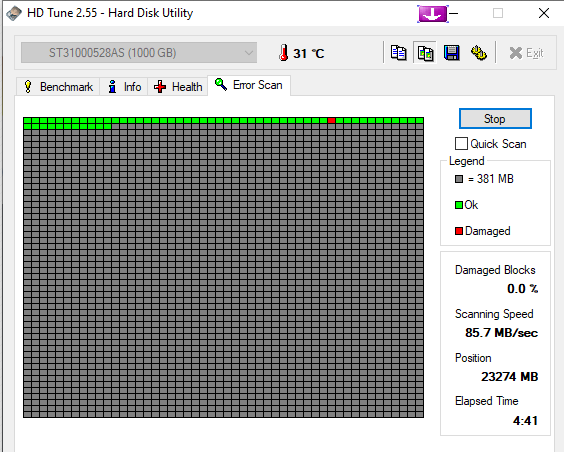

after recent tests with Crystal Disks and HD Tune:
1. The temperature on the disk is almost 60 degrees Celsius (55,56,57,58,59)
-> after ~~15 -30 min from powering on - computer gets very hot - is this normal? (even with total afk)
2. Bad sector was found.
and now the question is - whether this could be the cause of the system installation failure?
If I need to replace the disk:
Can I 'just' replace the disk with any matching one or there will be any problems if there is no 'Mac - disk'?

EDIT: added some screenshots from HD Tune and Cristal Disk (Fresh Start/Power ON)
All your troubles came from a bad HDD. After nearly 10 years of service, it's at the end of its life.
I would suggest you just replace it with a 2.5" SSD and try Internet Recovery again. Any SSD will do.
