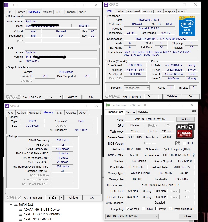

Hi all,
Just wanted to share my experience with upgrading the CPU on the newest iMac 5K. I also upgraded the "Fusion Drive" to a standard 256GB SSD. I unfused it and I left the 128GB Fusion Drive SSD on the board.
Stock CPU: i5-4690
Upgraded CPU: i7-4790K
Stock HD: 1TB Seagate + 128GB PCI-E SSD
Upgraded: 256GB Samsung EVO Pro + Stock 128 GB PCI-E SSD
RAM: 8GB Stock
Upgraded: 8GB Stock + 16GB Crucial RAM = 24GB Total.
I've also attached the performance figures using GeekBench. If you're up for a challenge and not afraid of damaging your iMac, go for the upgrade. It is surprisingly easy once you know how to take the LCD off of the main frame. That is a pain because Apple uses adhesive strips. More details on the iFixit guide which is what I used to upgrade.
Overall, it is not too difficult. Be careful and don't bend the LGA1150 socket pins but even that could be fixed (with a lot of pain).
Cheers lads and happy holidays!

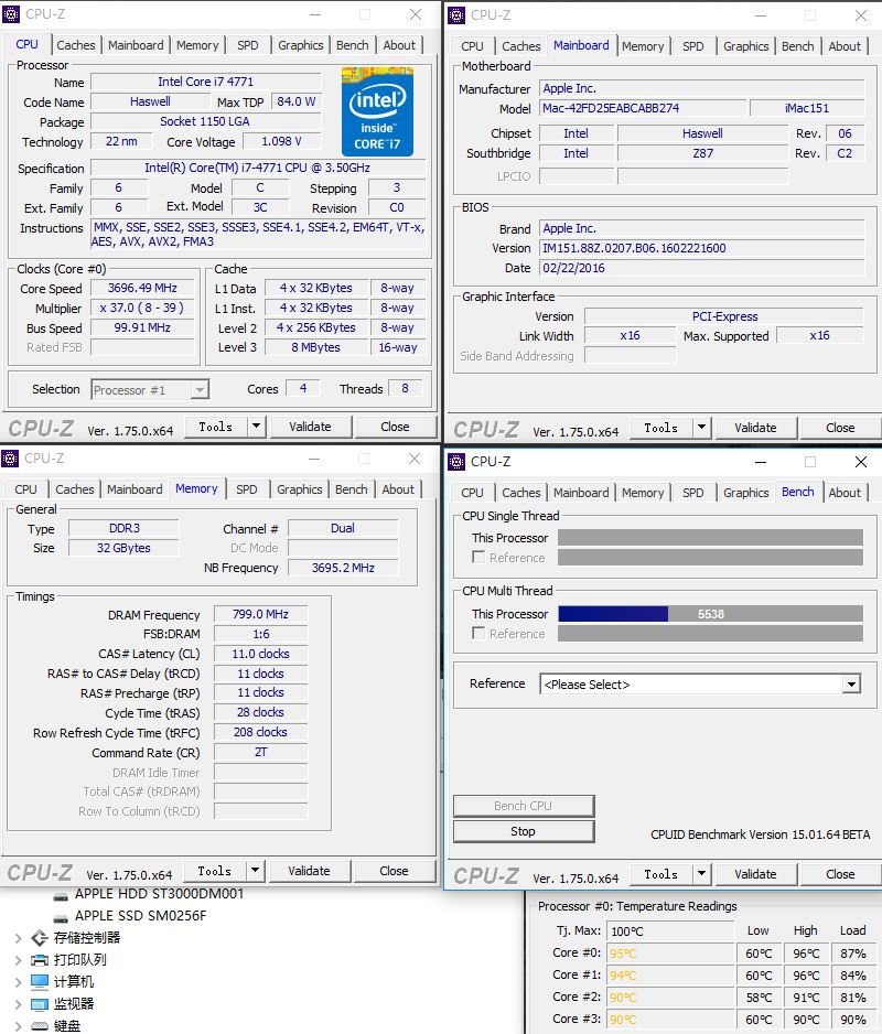

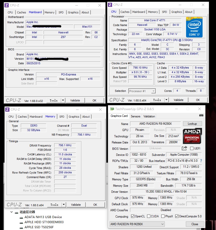

Just Upgraded my imac 5k
i5-4690 to i7-4771
4x4=16GB to 4x8GB=32GB Ram
128GB+1TB to 256GB+1TB
it work good but the CPU run a little more hot then the i5..
i5-4690 to i7-4771

sorry... forgot to get back to you, was a bid busy lately, there is 2 brand of APPLE SSD which work on iMac 5K late 2014, TS0256F (Toshiba) and SM0256F (Samsung), they can be found in the Macbook Air and the Macbook Pro Retina Late 2013, i recomend you to get the samsung one SM0256F, because there is some problem with the toshiba one. when i was in china early this year, i got a 256GB SM0256F APPLE SSD and a 3TB ST3000DM001 APPLE HDD from TaoBao, so i upgraded the drives again 2 months ago. hope this help, and sorry for my bad english...

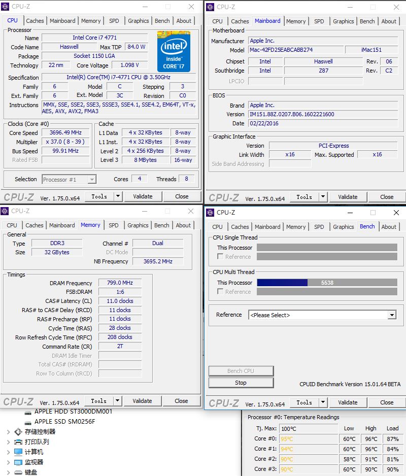

im attaching a screen shot, as you guys can see, the i7-4771 can run really hot on this iMac, the CPU temp can reach 99 degrees celcius after a few minutes of stressing, but with no problem, i do play league fo legends and CS-GO at least 3 hours daily, and this imac never fail me.

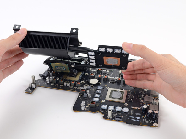

Help!
I don't know if anyone is still reading this thread. This is what happened to me and what I have done so far.
iMac 2013 27" 3.5GHz Nvidia GT780M 4GB (This may or may not be important)
So the hinge failed on this machine and, knowing my way around the iMac and other machines, I decided to change it myself. Having purchased a new hinge and the required strips to reseal the machine once I'd finished I proceeded with caution.
Everything went smoothly.
New hinge in place I though - well whilst I've got it stripped downs so far, I may as well replace the thermal paste with some Arctic Silver 5. So I took the heat sink off, cleaned it up and reapplied.
On this model you have to put the CPU in the socket put the 'gunk' on. Put the heat sink on and then invert the whole logic board to insert the screws and spring from underneath.
Disaster! The CPU slipped and I wound up crushing the edge of the chip!
Don't panic, stiff upper lip and all, lets get a new CPU before my wife finds out.
Amazon to the rescue. Now I found this thread and looking at the costs and delivery times I purchased the 4790 (Not the K) instead of the 4771 that was shipped in the machine.
Put it in and reassembled. Put in the power cable - 1 light. Pressed the start - 2 lights ..... ..... ..... ..... .....
So I understand that
LED 1. Trickle power
LED 2. Start button pressed - Main power on
LED 3. GPU found
LED 4. LCD found
So, I draw the conclusion that the mother board is damaged. (Seems logical to me). Ebay to the rescue. 4 days later a new mother board arrives with no CPU. i've just spent the afternoon switching the motherboards and CPU.
Exactly the same result as the old logic board. So maybe the logic board is not damaged after all. Now I have (apparently) 2 functioning logic boards and 1 CPU and they don't want to play.
Can anyone shed light on this?
In total I'm down over £600 and still don't have a working machine. Worst I don't know why.

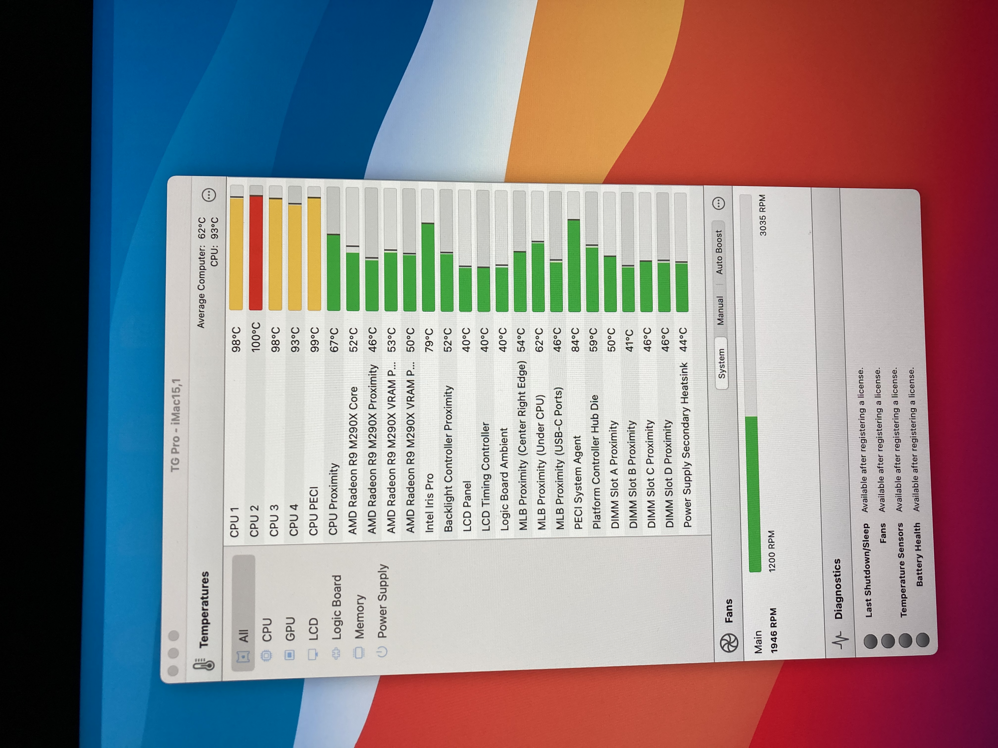

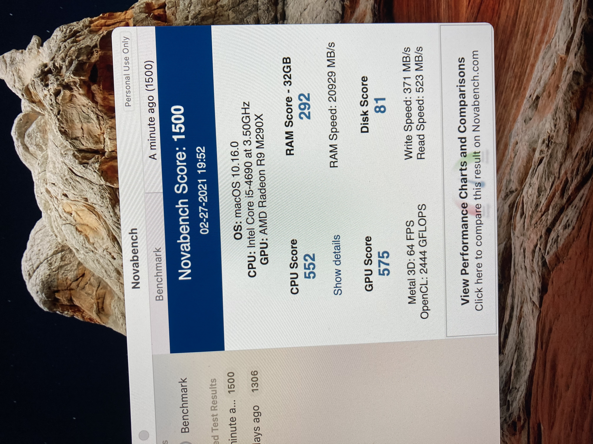

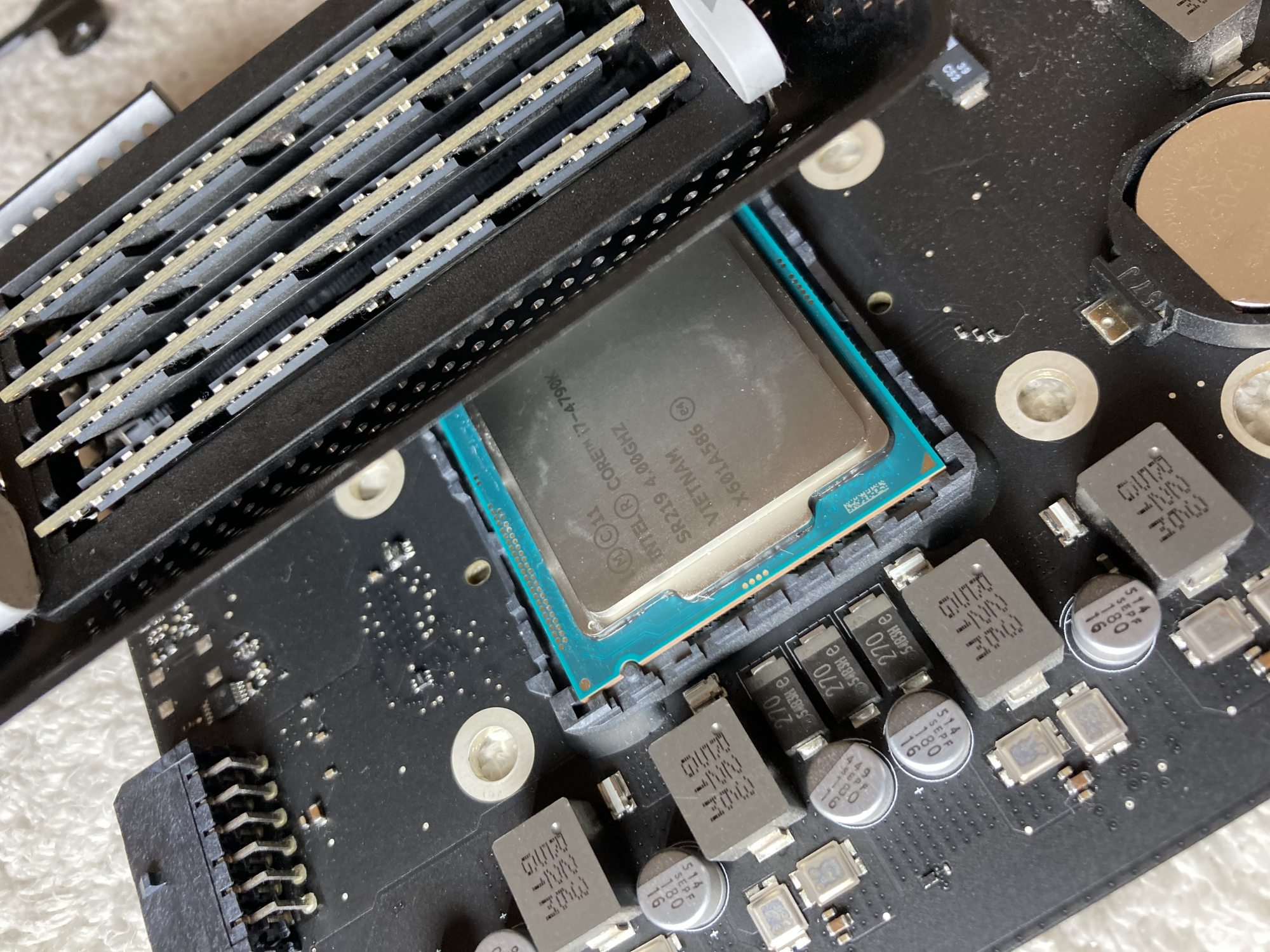

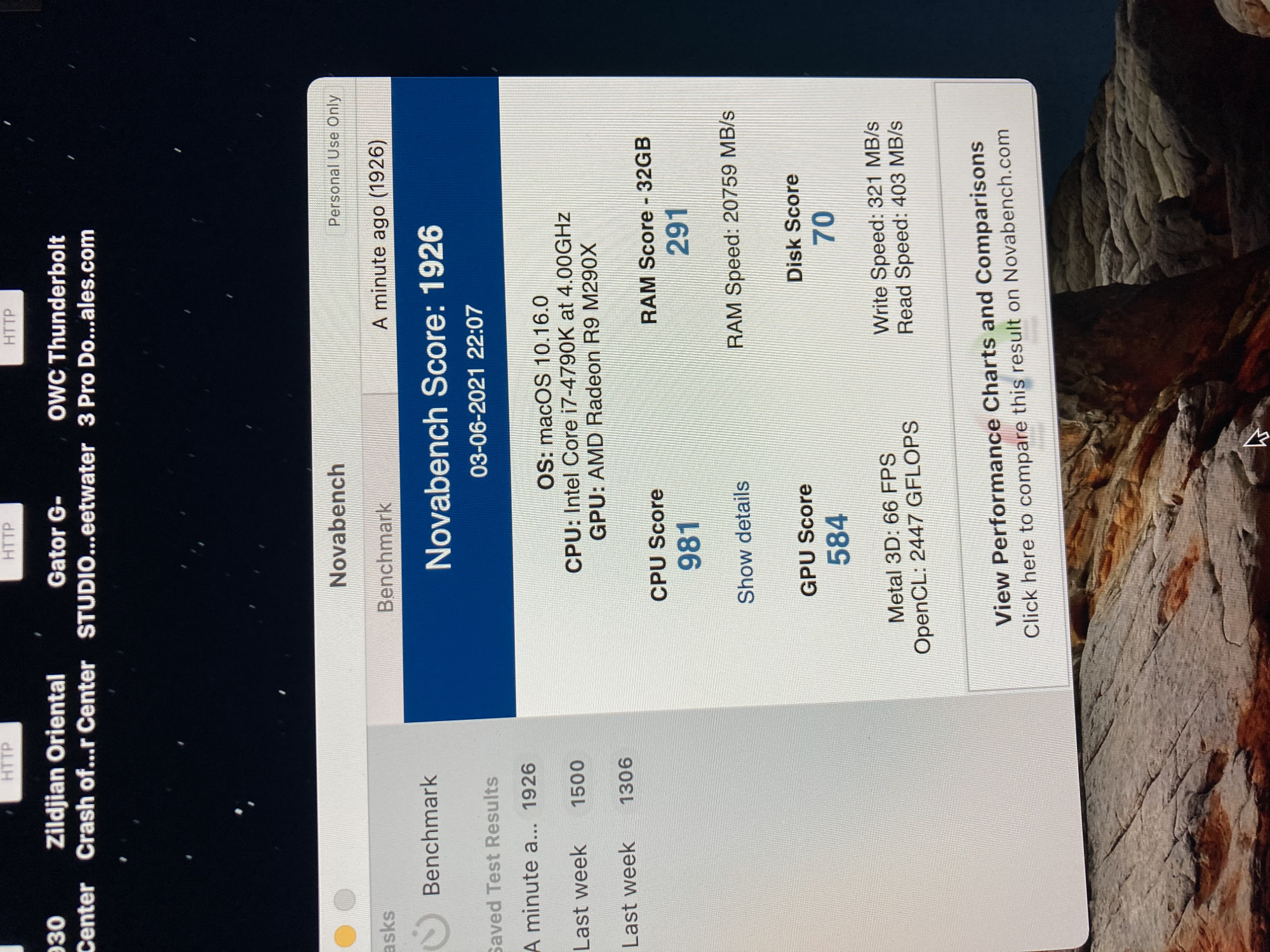

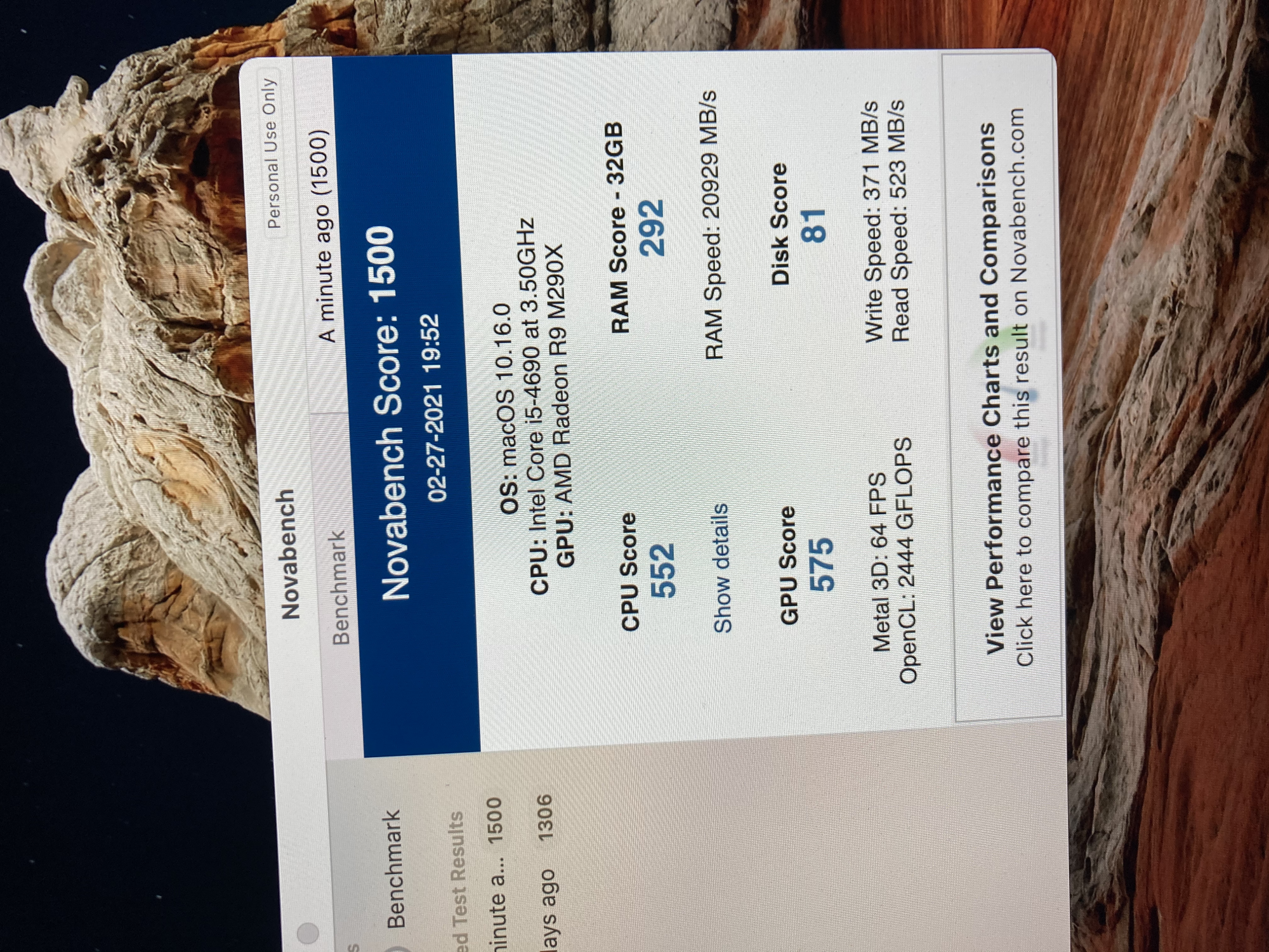

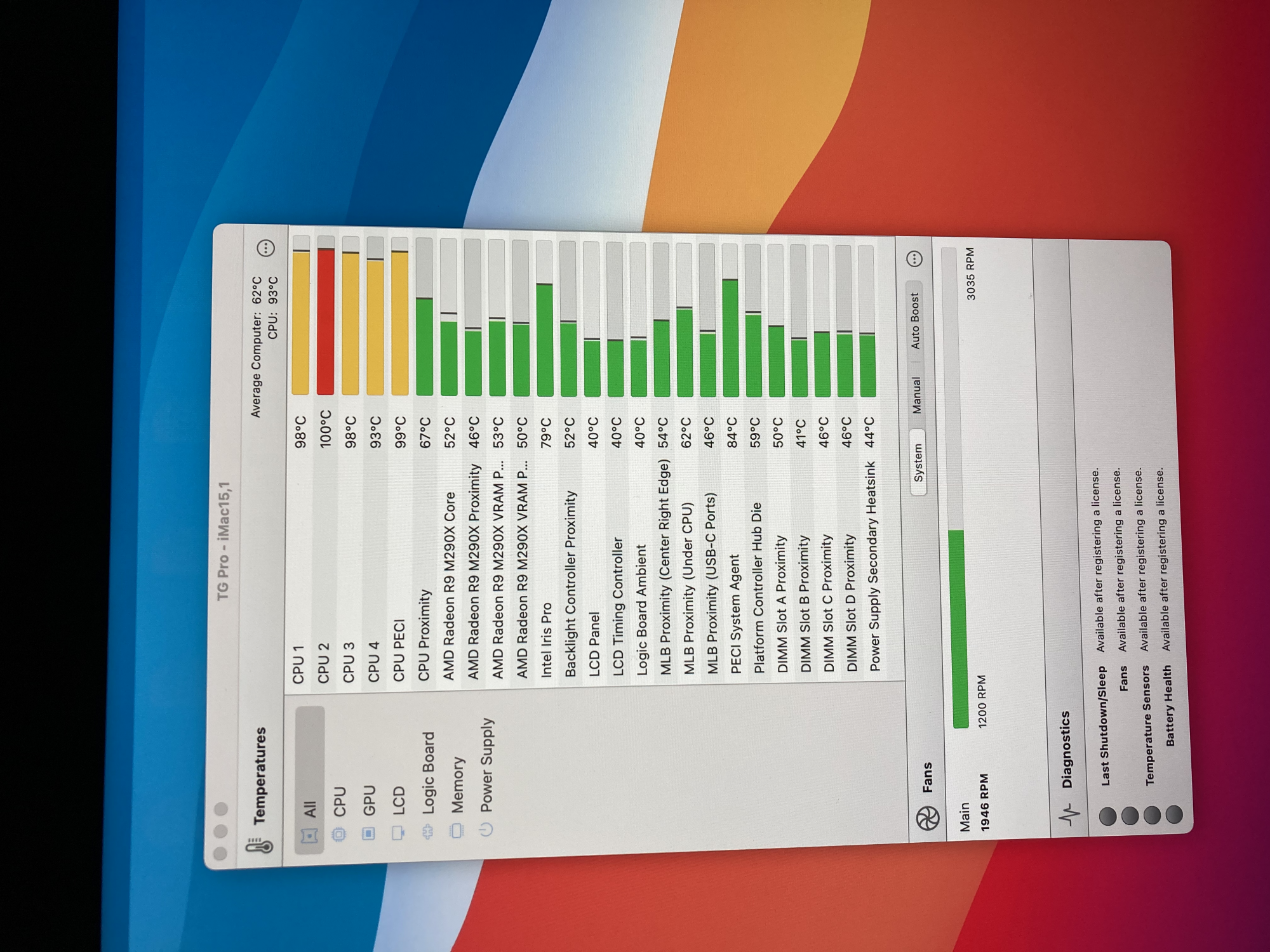

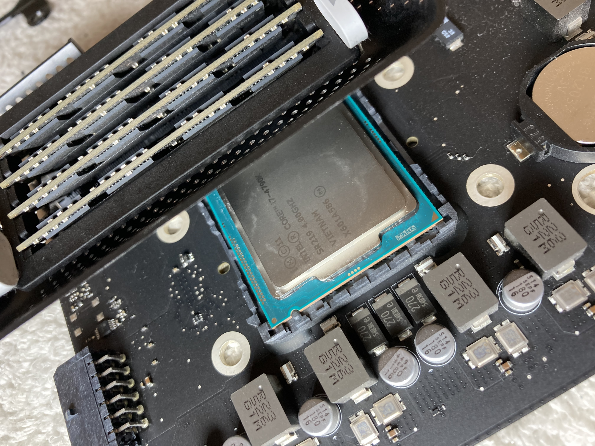

Hey Guys I've made it!Upgrade done! I7 4790K Inside! Same Thing! The only issue is the temperature. It hits easily 100 degrees on Benchmark test. I've used a TM30 Thermal Paste Corsair. Anything I can do to lower the temperature ? I also watched a video from a intel engineer and he said this kind of temperature is a FEATURE, like an auto overclocking after 80 degrees. Also I haven't notice a BIG DIFERENCE I would say ZERO in terms of performance compared to the I5 4690.
I don't know what to do.......
